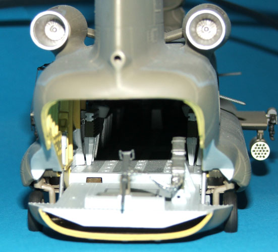

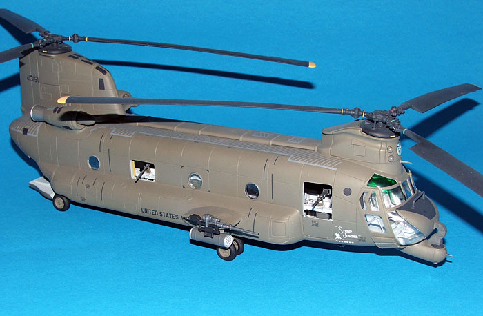

This 1/48 Guns a go go Hook was built by a Mr. Robert Mantauno…not too sure where he is but I bet he’s from the UK or something like that? LOOK like a great kit!.. can’t wait!
Does the lower mounting for the granade launcher look large to anyone else?
There is a couple places that should be sanded down and/or filled in, but the deminsions seem accurate… examples:
(also note the position of the (1) Nav Light, (2) the sealed Cabin Heater exhaust, (3) the un-tinted brow glass, (4) and the gold tinted windshield panels.) And espeically the shape/height of the Fwd Pylon… [;)]

Hi Alby… (by the end of this, you may be sorry you asked! haha)[;)] Naaa… the two biggies are the Fwd Pylon and the brow glass. (well, personally, an entirely new front clear piece would be nice, because of the mis-shaped brow glass, upper chin bubbles, and THICK post between the glass panels)
I’ve made the Fwd Pylon modification on one 1/72 Italeri kit, and the 1/144 Revell kit… which are the same molds as the new 1/48 issue. It’s a daunting thing to purposefully separate such a prominent part of the helicopter, but afterwards, you’ll be so glad you did because of how it improves the lines! …However, for those who aren’t inclined to cutting/rebuilding, all is not lost… you can make the build more visually pleasing by making the rim around the sides and back more pronounced with the addition of curved sheet plastic strip, putty & smoothed, and filling in the groove on the upper front.[:)]

Okay… now for those who want to “Go for it”, along with the modifications indicated above, here is a diagram of the items that will bring the fuselage into specs!
(15). Cut pylon just above the horizontal seam (leave base for reference and to smooth putty)… start cut at the back and work your way around. A hobby saw would work fine because they’ll not be any mating surfaces on the exterior. Mount pylon on one or more internal devices (pieces of plastic), then before you attach it, glue pieces of sheet styrene along the inside of the fuselage cut, which will serve as extra bonding surface, and a filler for the space that will be puttied. Question: “But how high do I raise the pylon?” Here’s a back room reference for that… get something and measure/mark the distance between the bottom of the cockpit emergency exit door, to the rim where the upper glass begins… (dang, that’s confusing!!) Example: http://gunsagogo.org/pylonheight.jpg This distance is the same as the pylon height between the horizontal seam and the upper rim. [;)]
(16). I haven’t got the fix completely figured out on this one yet, but probably will have to thermoform new brow glass section that will wrap around the front pylon base to form the correct angle… If you look at two profile pictures showing the brow glass in the comparison photo below, you can see that the KIT piece slopes at too great an angle from back to the upper rim of the windshield, where it should be a more gentle angle and then curve down to the top of the windshield. Also, if you compare again, you will see the angle of the front of the windshield is slightly different. (yes, a new clear front piece and a resin fwd pylon from the seam up would make this a most accurate depiction) [;)] [tup]
(17). Wipers: I know, this fix should have been included in the first diagram, but what the hey… [;)]
Here’s some side by side comparison shots of the aforementioned area’s…
