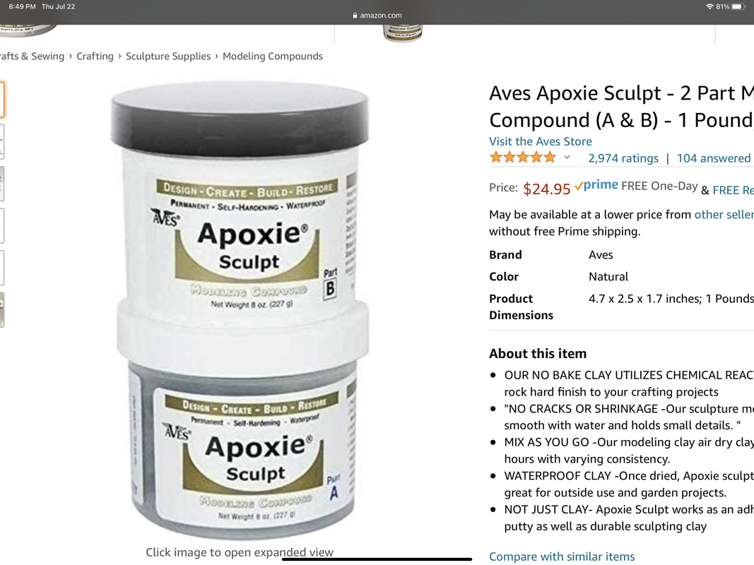

Is this it Eagle?
I think that stuff works the same way, but its not what I’m using. This is what I’m talking about.
https://www.amazon.com/Aves-Apoxie-Air-Clay-Professionals/dp/B000V54X0W/ref=sr_1_5?dchild=1&keywords=apoxie+clay&qid=1627001603&sr=8-5
Not sure what the differences are between the two products, but the Apoxie Clay has replaced Milliput Fine White for me. I loved Milliput, but this stuff is even better…much easier to work with, and the simple packaging in separate jars beats the pretty much non-existent packaging of Milliput.
