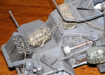

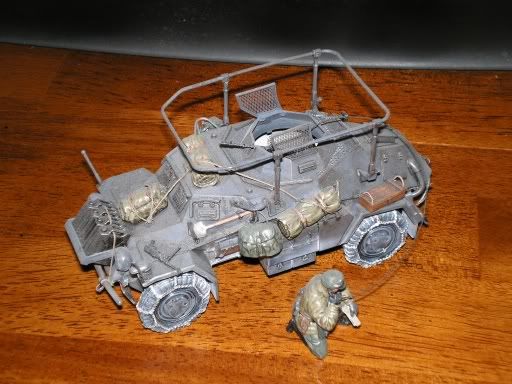

This was the first kit I did after being out for almost 20 years. The kit is Tamiya’s Sd Kfz 223 from 1971, not the re-issue. I got it at a Goodwill store for $5.00. The kit almost builds itself and only had some minor fit issues. Also, since it’s not a tank, there are no motorized holes to fill in the bottom of the hull.
