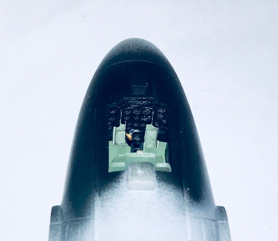

Enclosed a comparsion of Tamiya XF-71 and my home made brew.
XF-71 being more grey and my HMB more yellow.
Any of those that would come close to a Spitfire Mk.XIV from 1944-45?
I know all the pitfalls of the question - just asking for an opinion.

I can only say from what I’ve seen out there the color doesn’t show much yellow. It’s also not too dark. It’s a true grey green on the light side as shades go. But then consider fade and wear etc. Unless it’s assembly line fresh of course. Given what you have on hand I’d probably lighten the Tamiya a little and have at it. I personally wouldn’t get too fussy about it, add some weathering and when it’s burried in the fuse it should look fine. But that’s just me.
I agree with OMG. Add a drop or two of light gray or white to the Tamiya color. Although I did use Tamiya on my Vampire cockpit and thought that it looked acceptable.

I used the MM acrylic RAF interior green on a Mosquito awhile back. Is almost dead on for a match of the open side door in the pic that Bish posted

The instructions for the Tamiya Tropical Spit interior mix are xf-5:1 + xf-21:3 + xf-65:1 It seems to be pretty close.
Hello Tickmagnet,
Thank you for this, the recipie is very close to XF-71.

Hi,
here is the color sample:
[/URL]
XF-71 to the left, the mix XF-5, XF-21, XF-65 to the right (1-3-1).
I kinda like it and will give it a go on my Revel 1/32 Spitfire.
We shall see how that goes :slight_smile:
