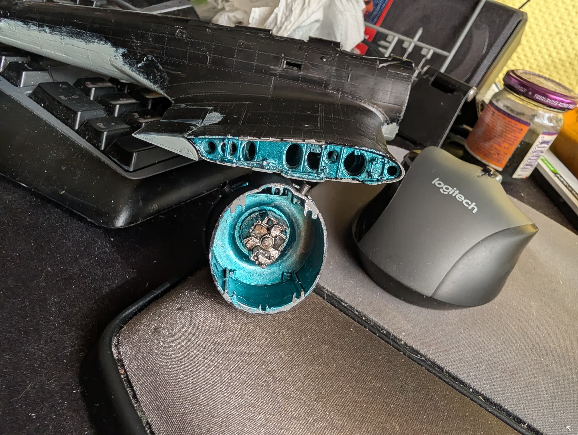

For the Aotake, I use Mr. Hobby Aqueous H63, Metallic Blue Green. Looks pretty legit…

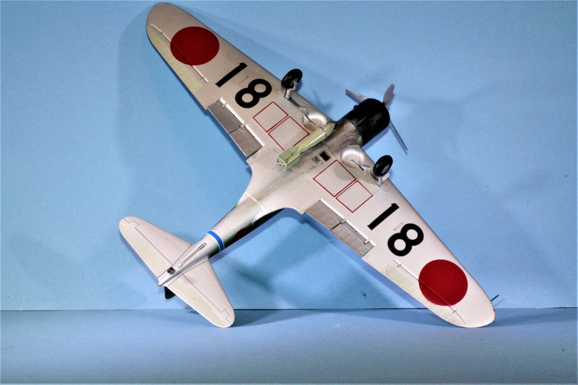

5th Division, Zuikaku
