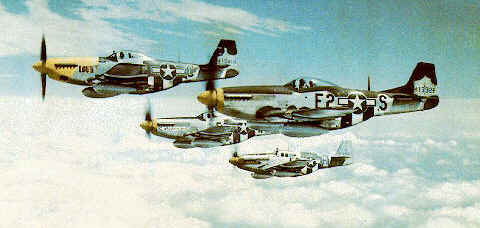

Lastly, for your D models, there are two reasons to build more than one:
(1) the early P-51’s did not have the tail “fillet” behind the canopy.
The lead aircraft is a P-51D-5NT, while the other aircraft are later
models (with the fillet on vertical stabilizer)

True enough about the fillet… however, all three P-51Ds in this flight are P-51D-5-NAs, as shown by the serials visible in this photo:
The ship flown by Urban Drew (E2-S 44-13926) has had the fin retrofitted, as was a fairly common practice not only on block-5 'D’s, but on 'B’s and 'C’s as well. This is a prime example of why one should not attempt to ID the production block of a certain P-51D by its physical features. Always go with the serial number…
Another difference was that some P-51Ks left the Dallas factory with different props, but again these were often changed in the field and cannot always be used as a basis for production block ID.

And if you look closely at the photo above, the second ship, although from the same production block as the other two P-51Ds, has a slightly different canopy shape. Again, an example of the pitfalls of variant/block identification via physical features alone…
