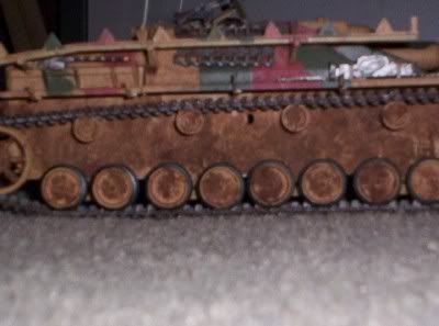

I use Gravox, that powdery stuff you use to make gravy. I ‘paint’ on some mineral turpentine or paint thinner, something that will evaporate quickly, then using a flat brush scoop up some powder and press it onto the wet spot. After it’s dry, I tint it using a mixture of artist’s oils (burnt umber, raw sienna, raw umber) mixed with paint thinner. Works great! The ‘tinting mixture’ soaks into the powder pretty quickly so don’t be afraid to slap it on. Also, if any ‘mud’ falls off, it looks even more natural. Here’s the result on my StuG IV
Cheers,
John
