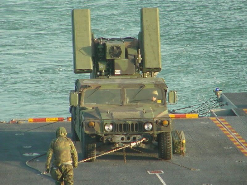

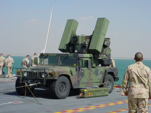

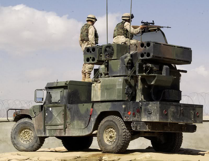

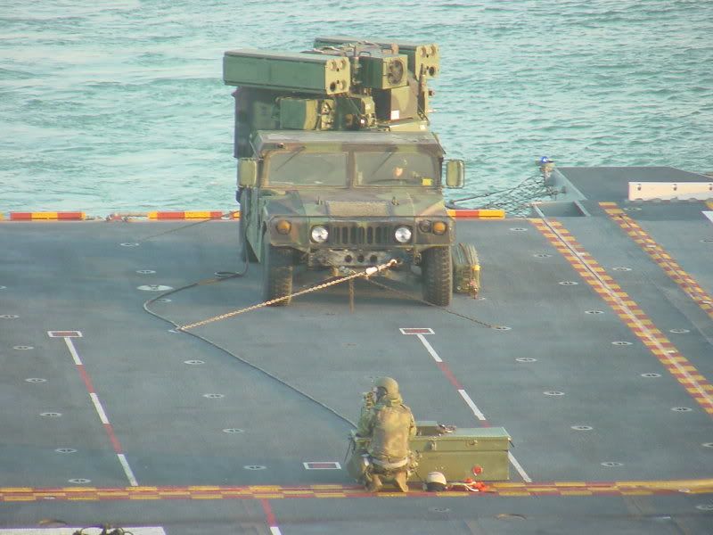

I don’t know where to find any pics, but, yes, the Italeri model is of an older version. The one on Prime Portal is current as of about 2003-2004 time-frame. I’m sure there have been further upgrades as well since then.
Hope these shots help you out. They are Avengers that were deployed to OIF in 2003 aboard the USS Saipan. Occasionally, the Avengers were brought up topside for added air defense for the ship in a high-threat environment.
4th shot is one I found on the web. No idea on unit, timeframe, or theatre.

Thanks for the pics, They’ll help in my commision. Most regards.
