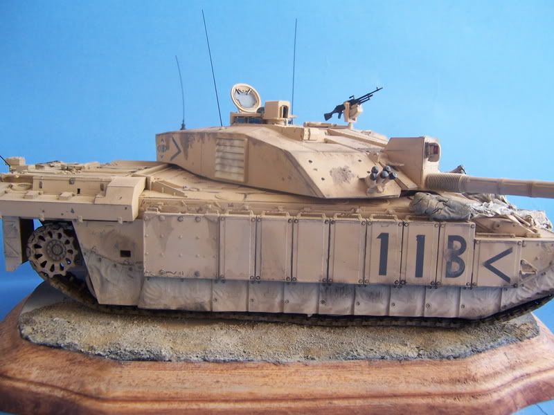

Get the Voyager PE set, it works well enough and has the corrected CIPs. I painted my skirts with a base coat of Israeli sand grey (model Master colours) washed it with Raw Umber and then mixed a 50 50 mix of Light skin tint and the sand grey to get a khaki colour, then highlighted with straight light skin tint. Here’s a pic, hope it helps!
