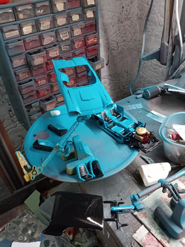

Monogram 58 T- bird
Painted the red - molded body Turquoise over red oxide primer.

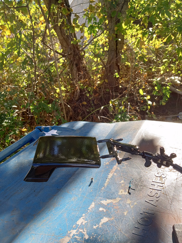

I painted the hard top black.
That will be a sharp combo!
I agree!

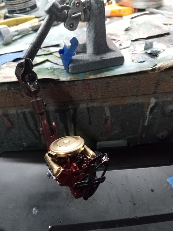

Getting the engine together…I decided to paint the engine block dark red with gold valve covers and air cleaner.
That Combo!
Wow, that’s gonna jump right out of the picture for sure!
Yes I think it is a good combo!

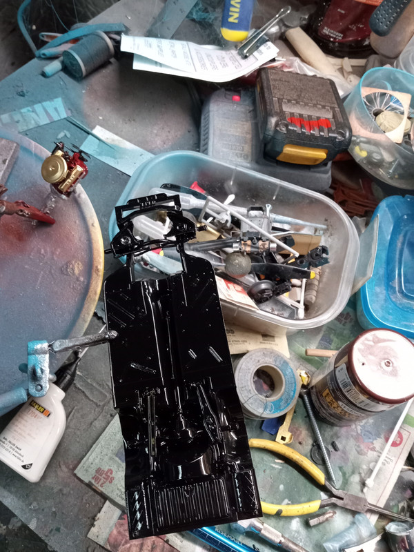

I like a gloss black chassis…

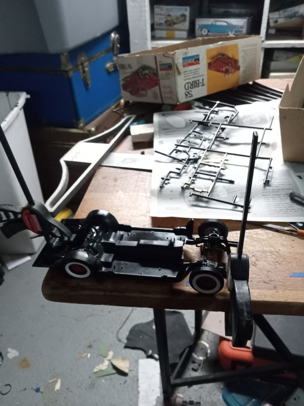

It is a good thing that I put the wheels and tires on to check the stance…low and behold the front passenger side frame rail was warped upward about 1/8 of an inch! So I cut the front passenger side frame off with a cut -off wheel and clamped the front and rear chassis to the assembly table .I then glued a brace so that when cured the chassis will set level.
Ok she is sitting on all four tires now!
Wow this is going to be awesome !
