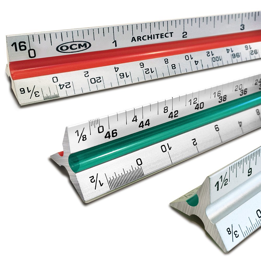

They are called architect’s scales (I’m an engineer) and 1:48 is 1/4"=1’ so you want the 1/4 scale.

An architects’ scale ruler can get you a few scales:
For 1:48 use the 1/4 scale
For 1:24 use the 1/2 scale
For 1:12 use the 1 scale
An engineer’s scale ruler can get you:
For 1:25 use the 50 scale (1 inch equals 50 inches) counting every other graduation as an inch.
An engineers scale also has 10, 20, 30, 100 scales which could sometimes prove useful.

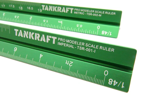

The Tankcraft Pro Modeler Scale Ruler does have 1:32, 1:35 and 1:72 on it.
Expo Tools has various scale rulers including O, OO, and N gage rules for model railroads as well as 1:72 and 1:35 scale rules for modeling. If you are working in metric, Dspiae has a metric triangle ruler that has various scales in metric.
