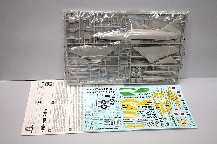

The kit arrived today. Off to wash the sprues then start with the cockpit assembly.

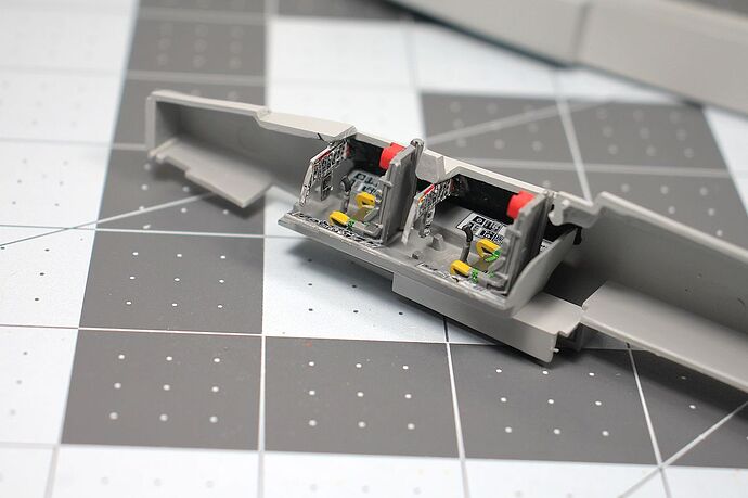

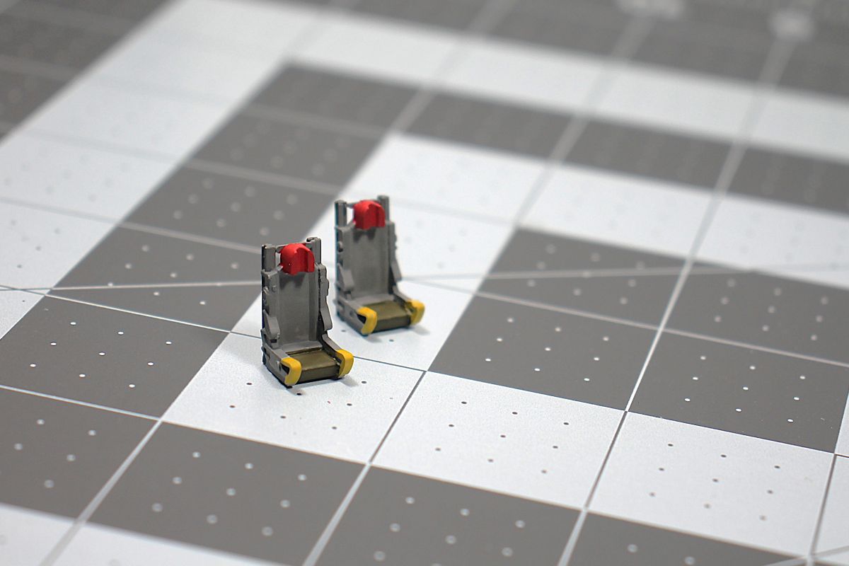

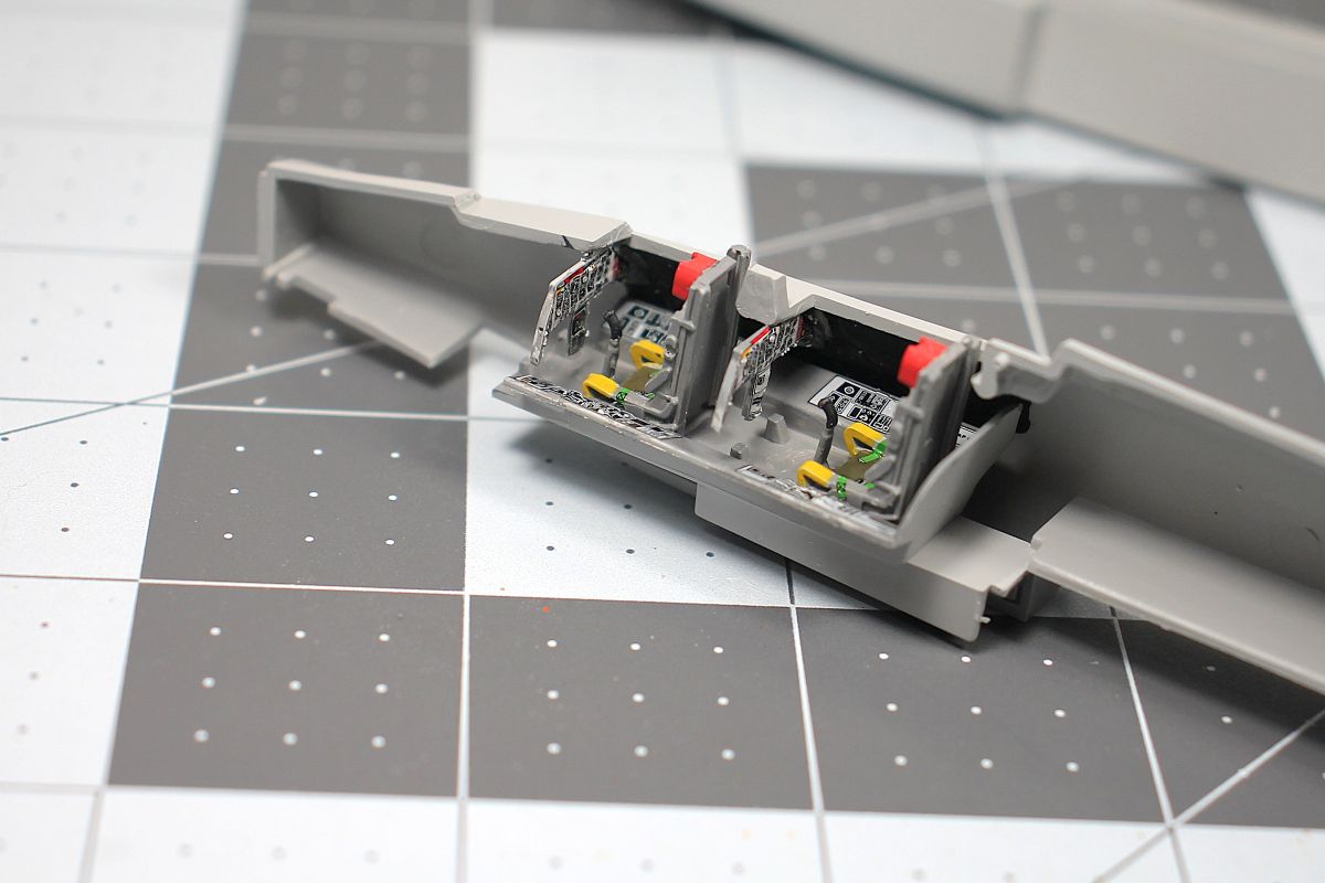

I have a start. The seats are painted and now to add belts and harnesses. Cockpit next. No extras on this build with the exception of aftermarket decals and two 7 shot rocket pods.

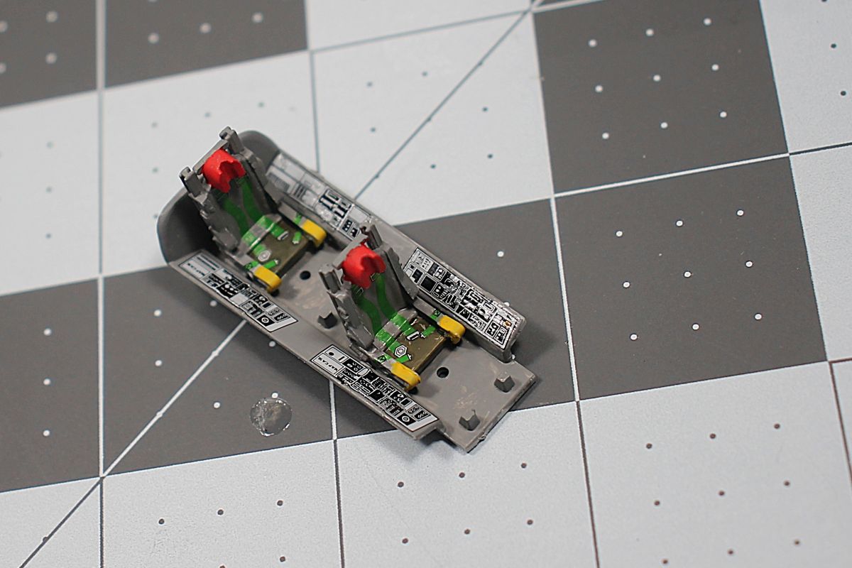

Cockpit is almost done. I am not impressed with the decal harnesses, I usually make ones from Tamiya tape, thought I’d try these.
Cockpit glued in to right side of fuselage. Now to add 20 grams of weight then close up fuselage halves.

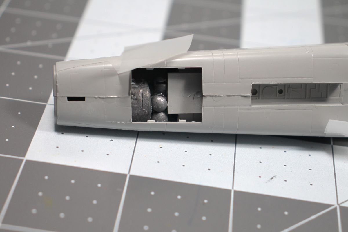

21 grams of weight in the nose, fuselage halves closed up.

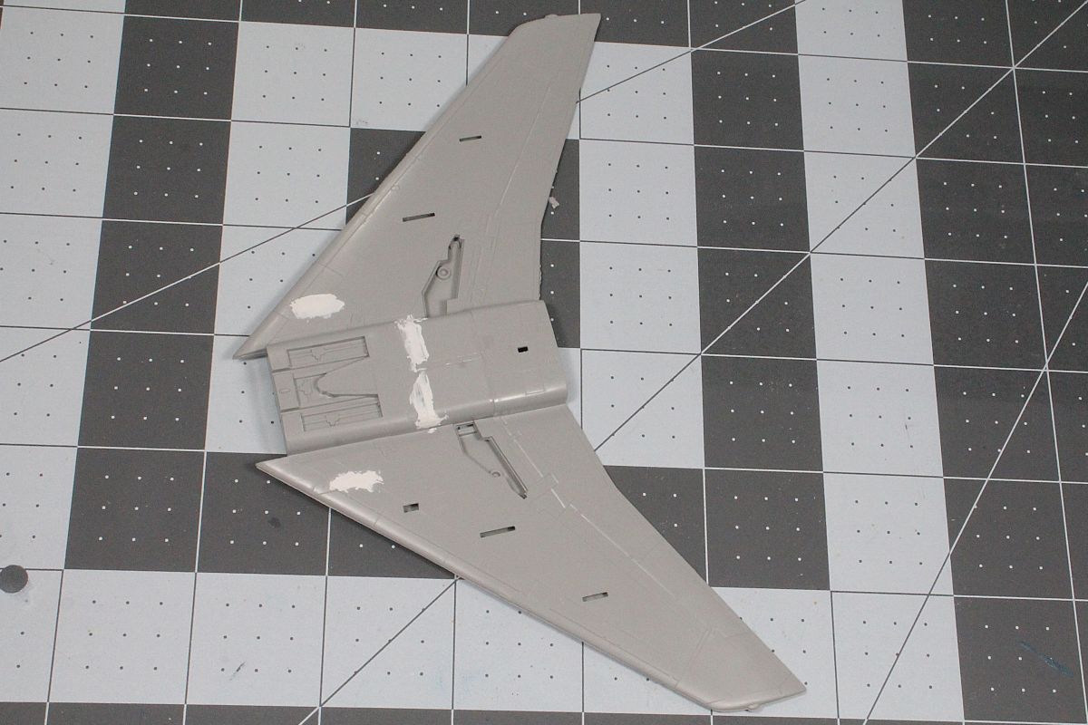

Started work on the wings.
I think there is a need for a new mold F-100F. The Italeri kit is getting long in the tooth.

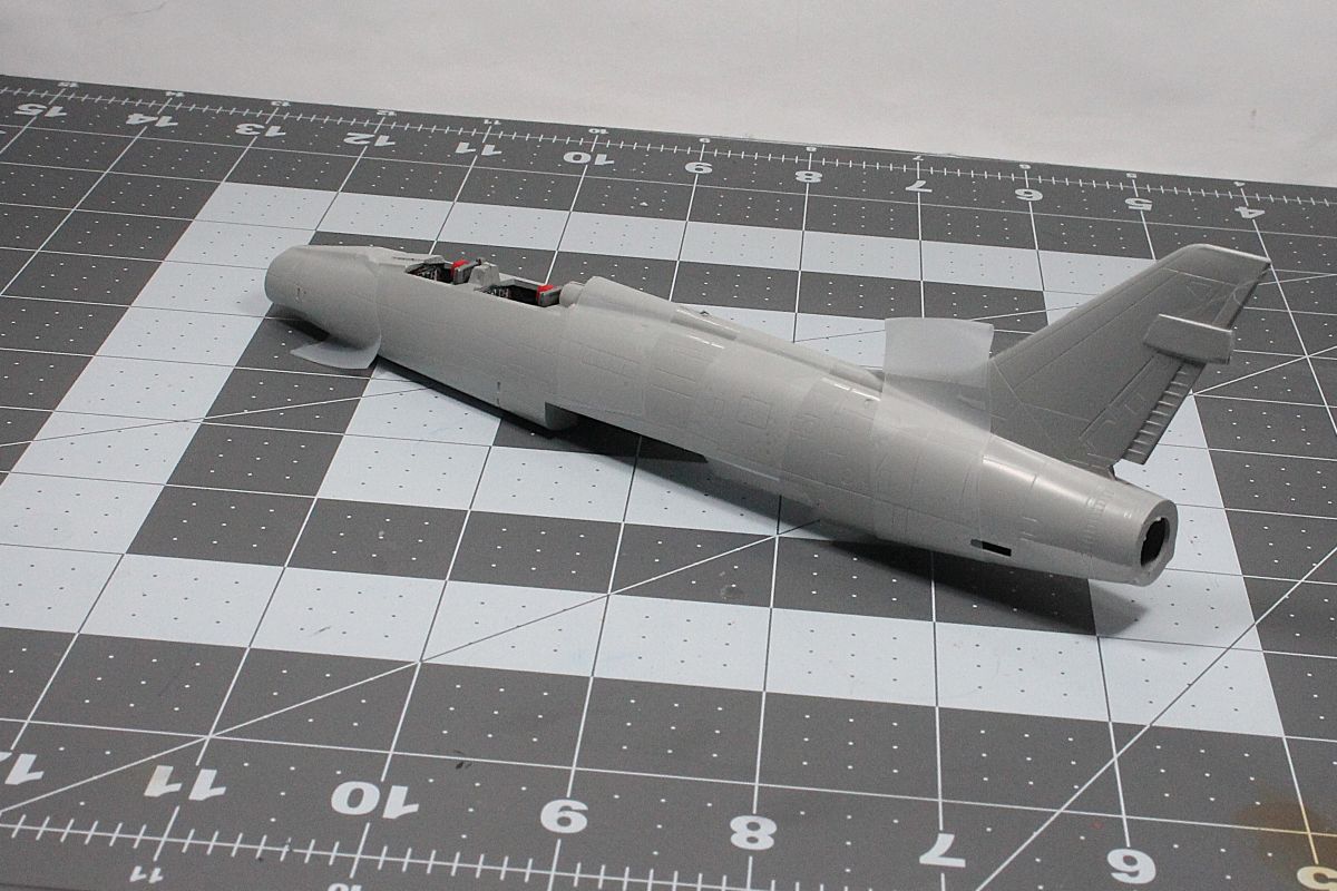

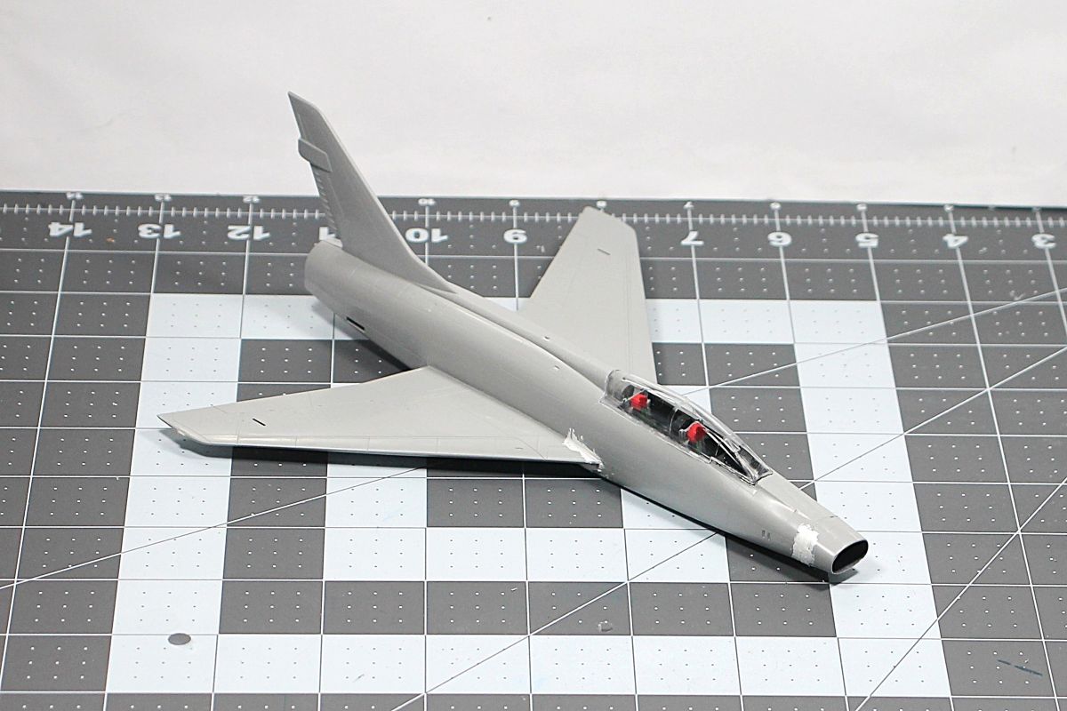

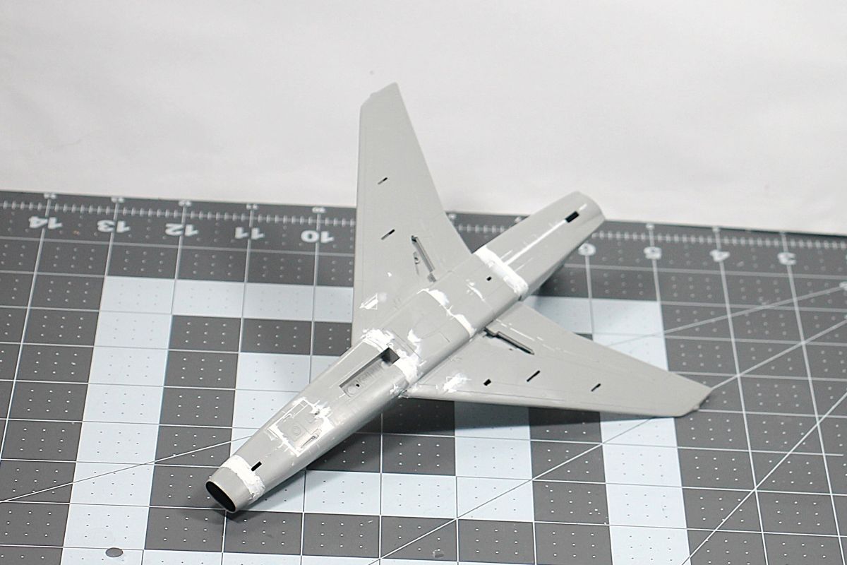

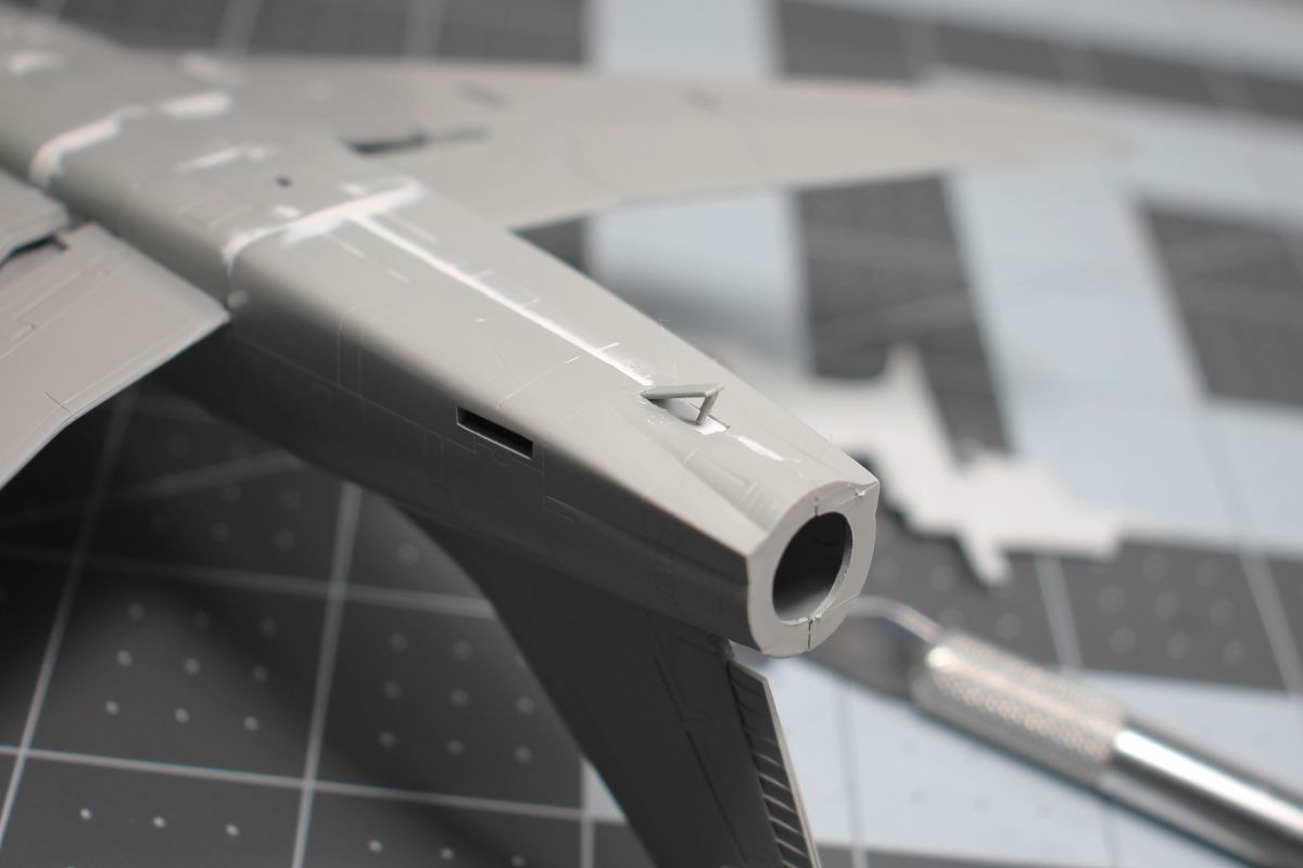

Canopy, wings and nose are all on. More putty, more sanding, more fun.

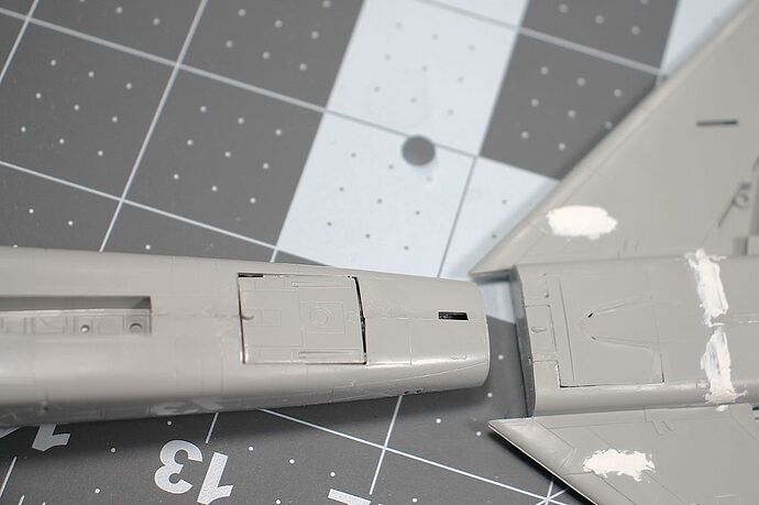

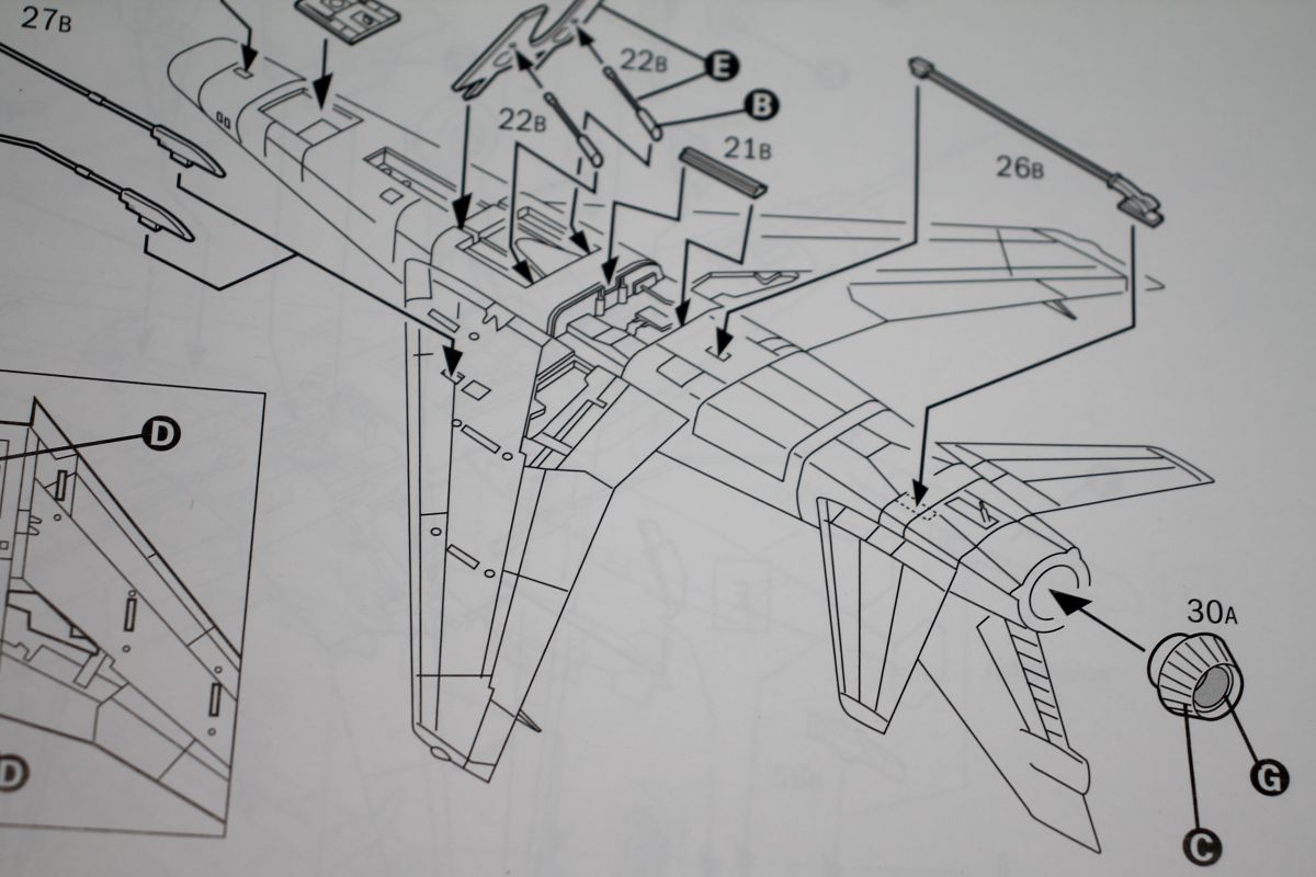

Also note the mistake where the tail skid is shown wrong on Italeri’s instructions. It’s shown upside down in 2 pages of the instructions, that “tooth” behind the exhaust nozzle is NOT a tail hook, that’s the piston they are showing backwards. See the photo at the bottom showing a Misty FAC parked in Vietnam with the tail skid in the down position.

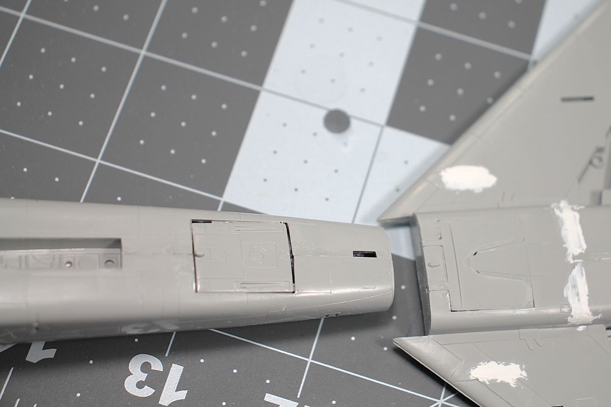

The Italeri kit has no floor to attach the tail skid and piston like the old ESCI kit had . It has a rectangular hole so I made a floor from .015" Evergreen plastic sheet. The first picture shows the rectangular hole and the second picture shows the floor installed with the tail skid and piston glued to it.
