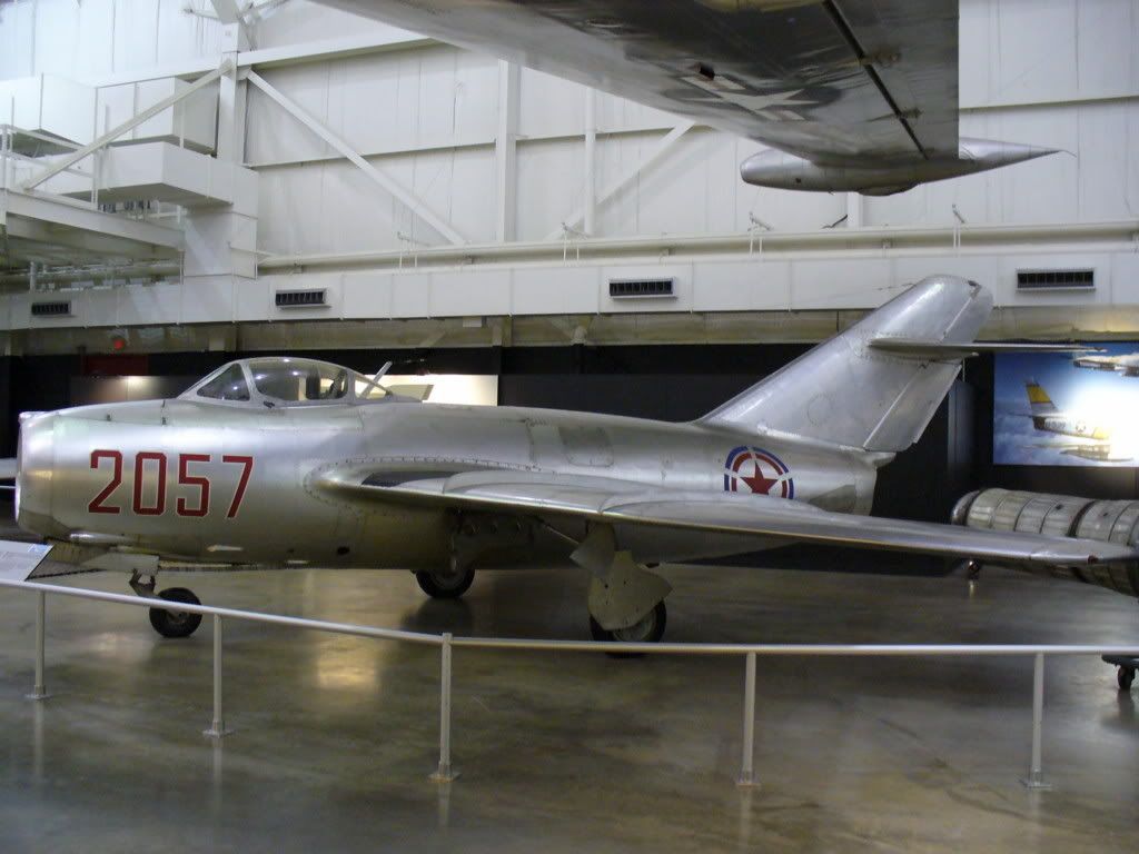

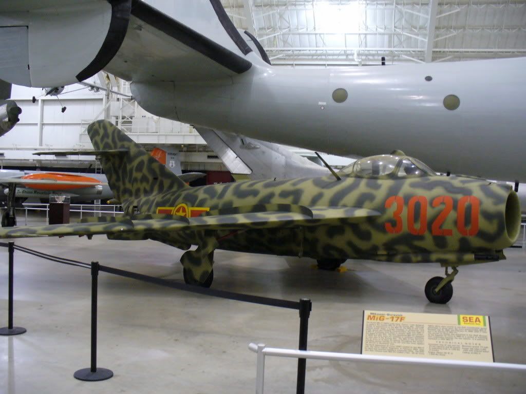

maybe these will help maybe not. the detail may not be there at these angles to be of much help.
Mig 15
Mig 17
