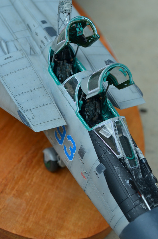

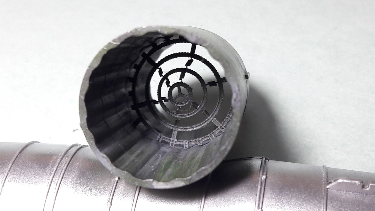

Following the instructions, I started with the engines, to which I added Eduard’s photo-etched parts for the afterburner basket.
I painted the metal parts with Krylon spray and marked the recesses with a MiG dirt set. In some areas I painted those pink stripes formed with Humbrol 70 lightened with white, some panels I painted with a green from Revell 362

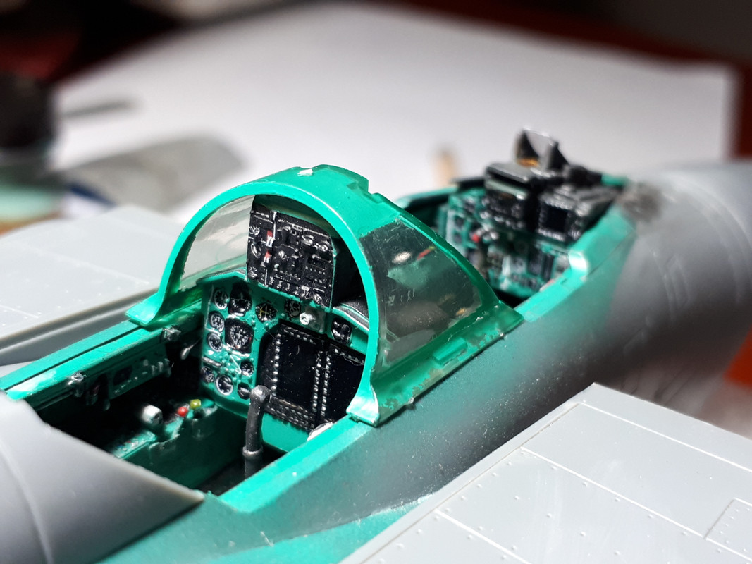

In the bathtub piece I added some details of ribs, supplements and map holders that have on the sides, for a molding issue, they come smooth.
To the front post lever I added a cam that goes in front of the handle.
After securing the fit, I primed with A.MIG-2023 black one shot primer and applied the AMIG-223 interior turquoise Green acrylic. I marked the recesses with the products that this set recommends, AMIG-1505 Gray for Yellow Sand and AMIG-1008 Dark Wash, I painted pink stripes to simulate that sealing putty.
I chose to use the decals from the AMK improvement set and not the pre-painted photo-etched parts from Eduard because it seems to me that there is a difference in tones between the color of this and the one I applied and they lose a bit of a sense of volume. The decals adapted very well to the surface of the boards. I applied matte varnish, used the dirt products and finally used drops of gloss varnish on the instruments and screens.
I added the pre-painted belts from Eduard’s set to the seats. I also added some laser printed maps and brochures.
The pieces inside the domes come smooth, in different references you can see that they have a fabric, to simulate this, I added aluminum foil to which I painted Tamiya XF-5 green, the parts without fabric, I left them turquoise green.
I proceeded to assemble the rest of the plane, resulting in a beautiful engineering product, where I really used very little putty.

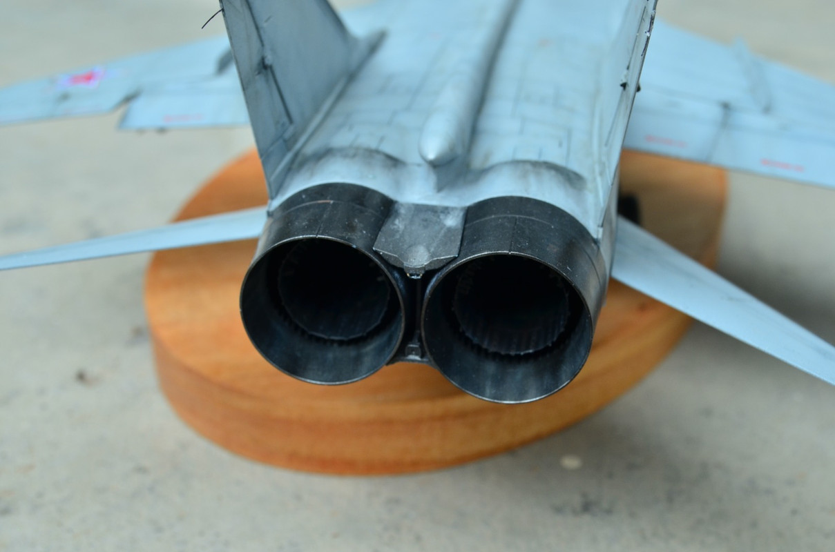

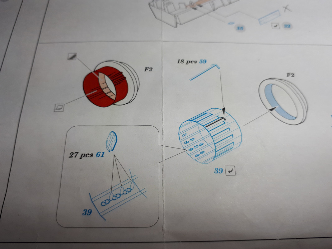

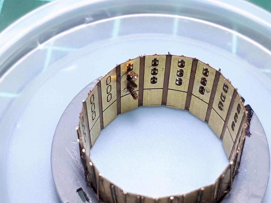

I added the 27 cooling petals in the each engine exhaust, I think Eduard could have make this detail no so difficult.

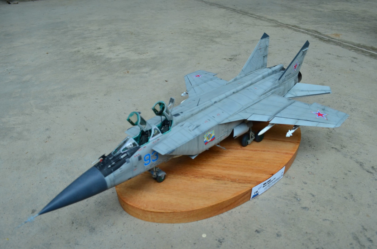

Final result:
The actual thing:

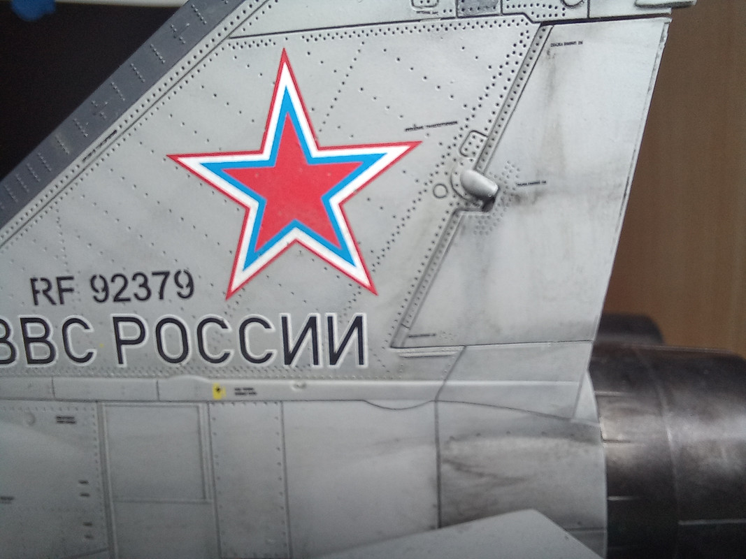

A few weeks ago I finished this kit, AMK’s MiG-31BM.

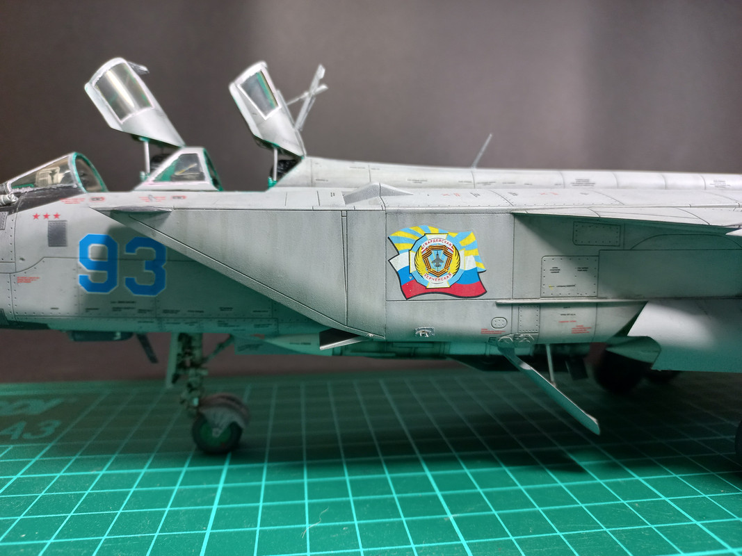

I Painted the entire kit with AK real Color RC336 MiG-25/31 grey. The dielecrtic panels of rhe nose cone , front fuselage and vertical fins with dark grey from Tamiya’s acrylic, XF-24.
I decided to use the kit’s decals.
I hope you like it.
