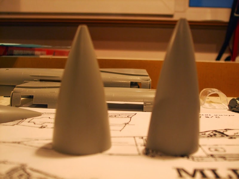

On the left you can see the original MiG 23 con, shortened and MiG 29 a dry fit half the fuselage.
Pinocchio nose had set. This is how it looked:
Compare it to his new cone, the one modified from the MiG 29. It makes a huge difference

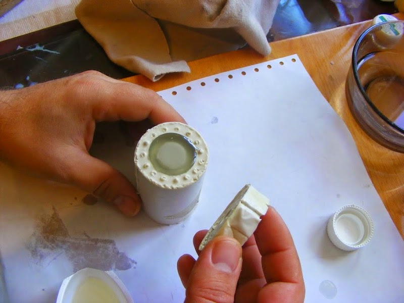

reproduction cone:

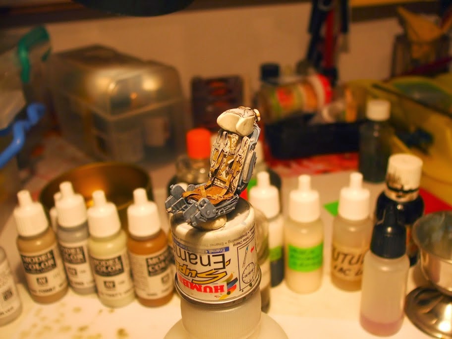

Cockpit all done, ready to be installed in the front half of the fuselage

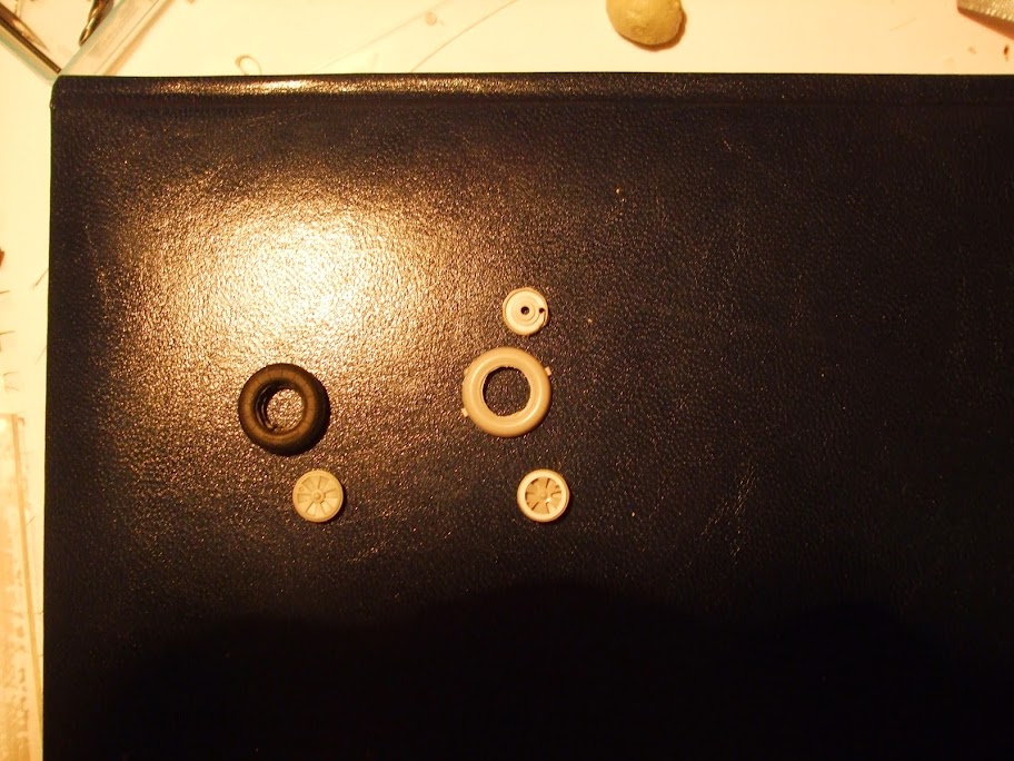

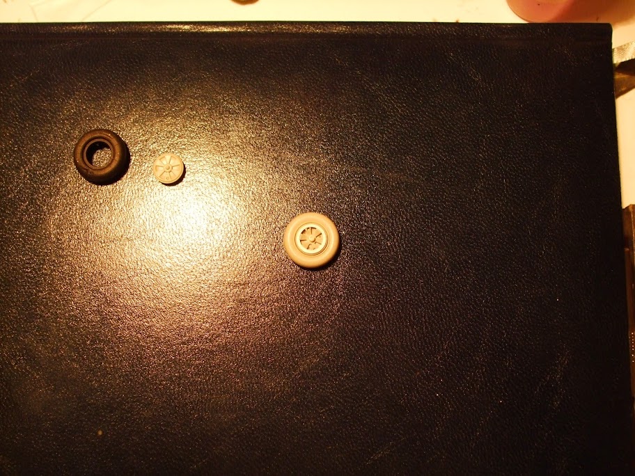

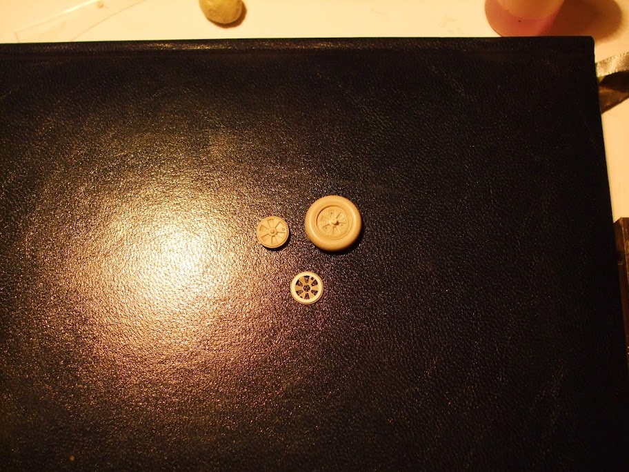

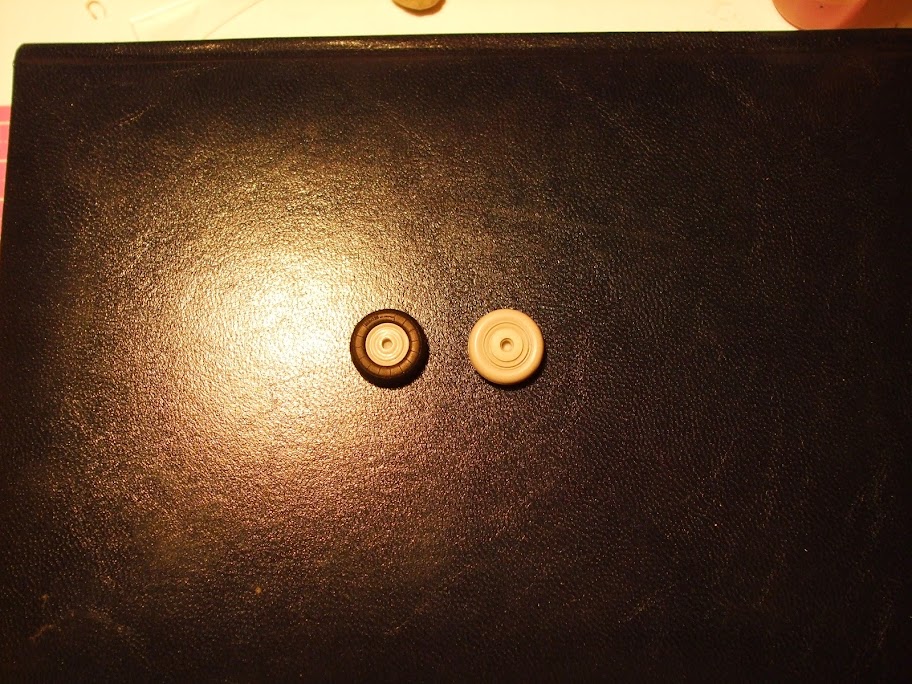

The front wheels: to the left is the accurate version of the hub as opposed to what is provided in the kit. The shallow details of the kit were improved by making the necessary cutouts in one hub and overlapping them over another that was left as is. A styrene circle was then added.

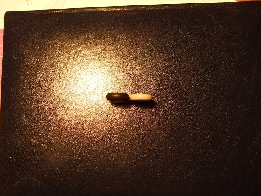

For the tires a 1:48th Hasegawa F-4 Phantom main wheel was used, with the hub removed.
