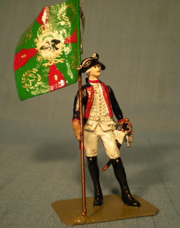

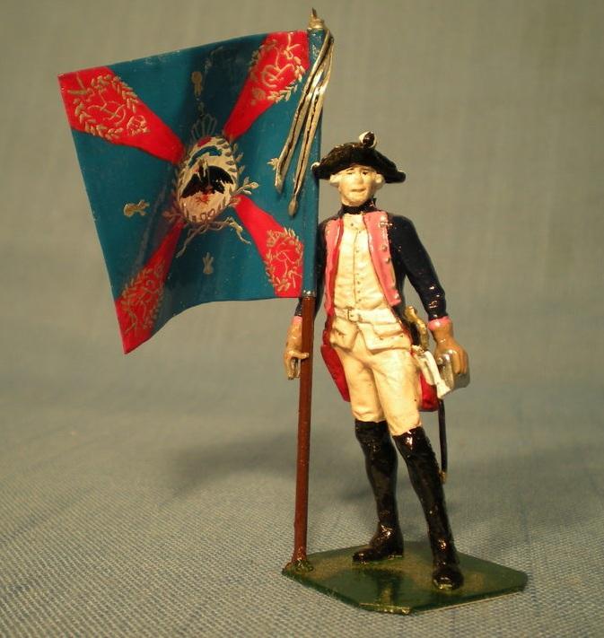

Personally, I use metal foil. For example, I’ve used foil candy wrappers, like the wrappers from Reese’s miniatures. Folded in quarters, it’s about the right size for a Prussian company flag. I flow CA glue between the layers, then shape it and let the glue set. Here are some examples:

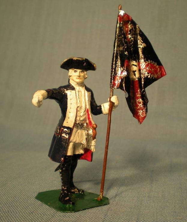

and this one is really folded, like a flag in no breeze:
I have also used stiff metal foil from wine bottles. The contemporary material is not all metal, but it still works. There, too, I can fold it to shape. I attach this to the staff-a piece of brass rod-with 2-part epoxy.
Either way, I prime the piece with Tamiya Fine Surface Primer and paint with my usual acrylics and enamels.

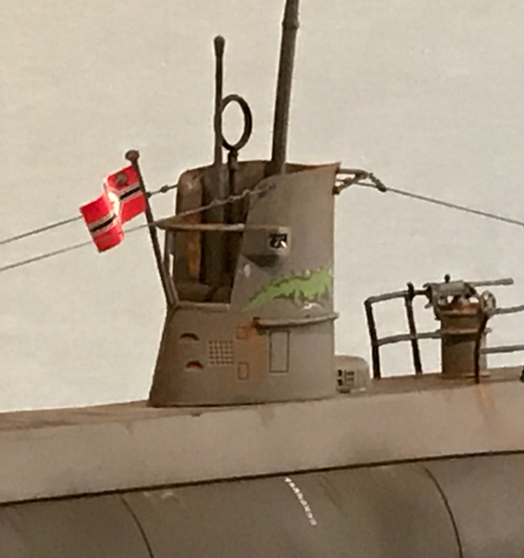

[dto:] works every time. Wine foil also works and I use it for larger scales. The flag on this 1/144 scale UBoat is nice and thin on kitchen foil.
