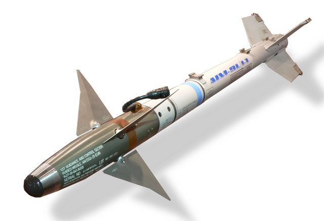

Has anyone found a stock color or successfully home brewed a good match for the gray-green anodizing on AIM-9M Sidewinder guidance sections?
The closest I’ve come is a mix of Tamiya XF-51 Khaki, XF-77 Gray and X-31 Titanium Gold. Close in color, but a bit too glittery.

You can see that the guidance fins are a truer gray than the body to which they are attached.
It looks like a metallic dark grey green so I mix dark grey, dark green and a tiny dot of silver and I adjust till it looks right.

It looks like 9157 has been discontinued by the manufacturer. Your point about the sparkle is the crux of the issue. The grain size in most metallic paints is just too large and makes the paint look like a 1970s bass boat.

I have been using Alclad 111 Magnesium for the guidance section and fins.
I have 26 Alclad bottles except 111! I wanted to compare but do have a bottle of Model Master Dark Anodonic Grey buffing metalizar that looks close to the front missile color.
Here’s a decent pic of the ALC111 on the guidance section of the AIM-9L on my F-14A.
