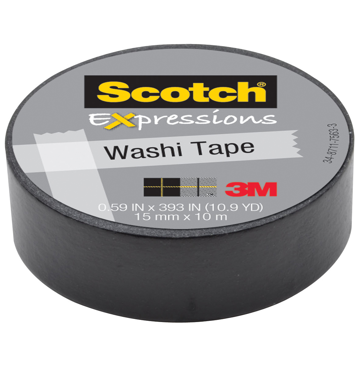

Don’t know about your area but they stock it at the local Walmart back in the craft section right across from the 50¢ apple, plaid, and folk art craft paints.
For $2.93 a roll for 32 feet of it and you can easily cut it to the width you want making it much cheaper than 52 feet of tamiya tape.
Don’t bother to ask for it, nobody had heard or knew of it so I found it myself.
And yes, “any” masking tape definitely needs burnishing for maximum effect.
!https://i5.walmartimages.com/asr/ddac6b1a-8097-4e51-ada8-c1a2c0edf599_1.5bbaa415ba23cde29ed7a226ef54cfef.jpeg?odnWidth=undefined&odnHeight=undefined&odnBg=ffffff
