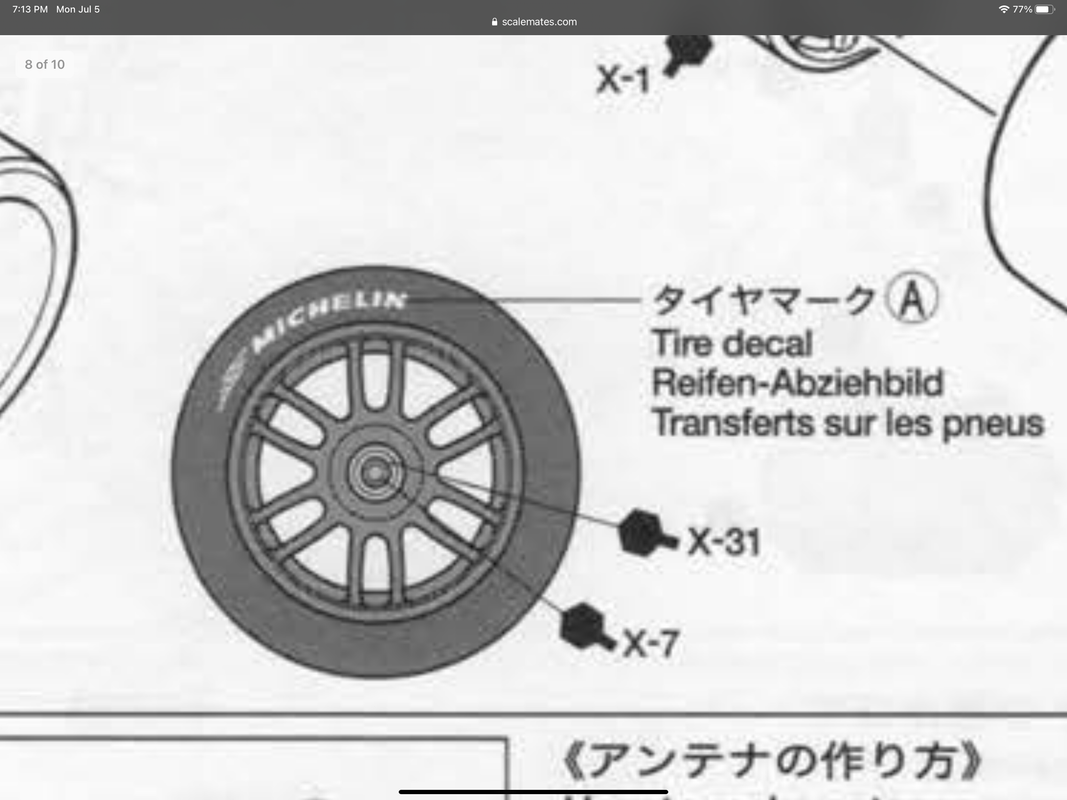

Hello all. I hope everyone had a nice holiday weekend. I’m building Tamiya’s Toyota GT One endurance racer. The instruction call for the center hub of the wheel to be painted gold (x-31). What s the best way to accomplish this? It’s probably .25-.3 mm in diameter. I thought of a circle cutter but I’m not sure you can cut a template that small. I prefer some sort of mask because my hand brushing skills aren’t great. To complicate matters the hub is recessed in the wheel.
Thanks

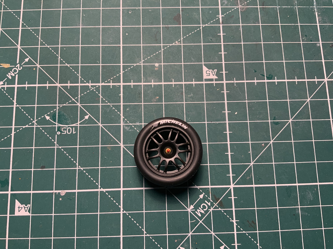

As I recall, it’s not too bad to paint freehand. Sorry for the dust - I need to spend a day dusting :slight_smile:
You did a nice job with that. I’m going to try mask and spray. However I see no way around hand painting the tiny red tip. That should be fairly easy.

I didnt get the result with the punch set. I ended up sharpening a toothpick and laying down liquid mask on the black then spraying the gold. The red is a micron pen. The reverse decal can be kinda tricky to align properly.
NICE! Looks like you got it figured out. Looks like you got some nice, crisp edges on the gold too, which is really hard to do with liquid mask. [H]
