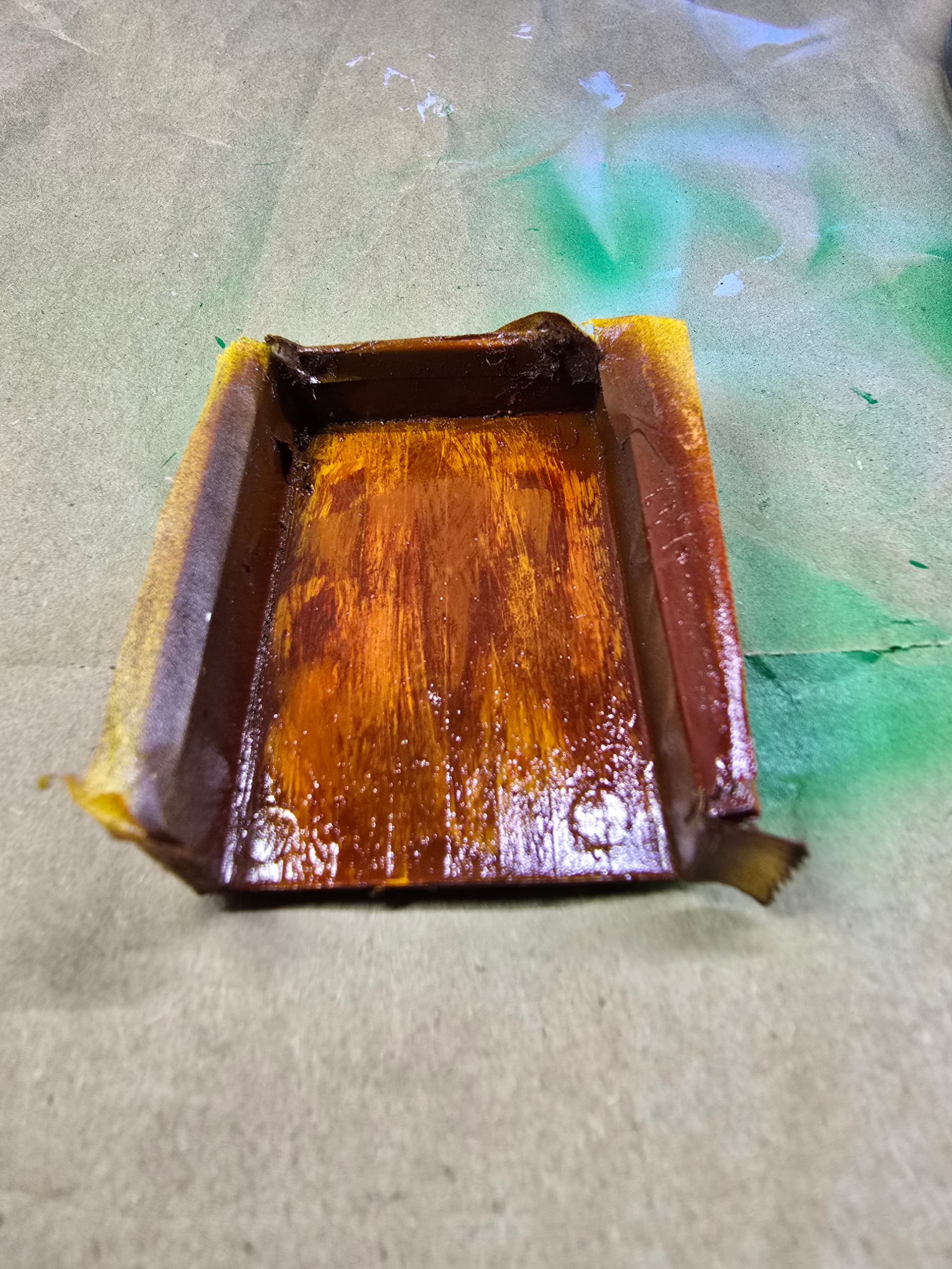

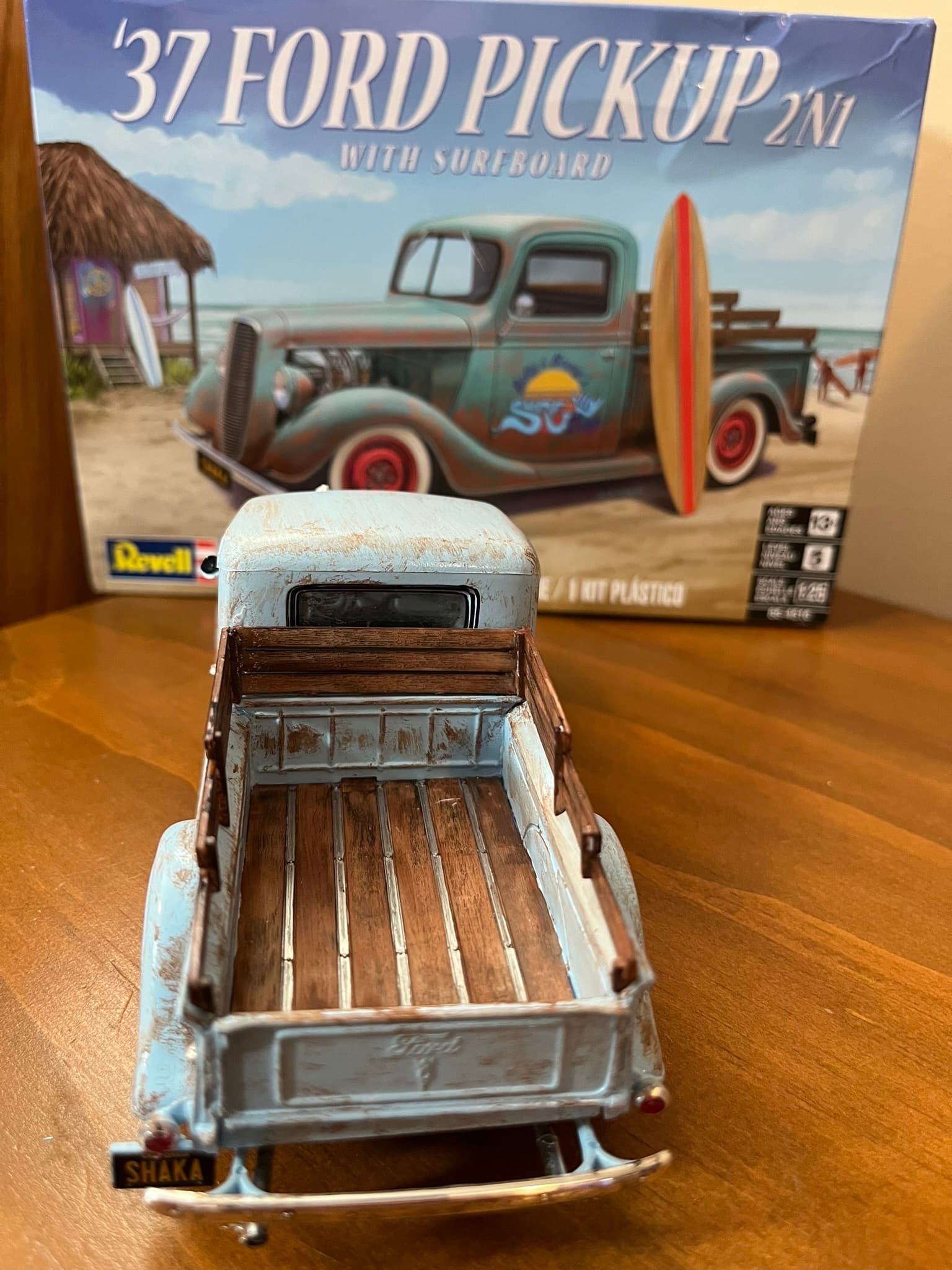

Here’s my first attempt at making a 1825 Model T pickup box look like wood. I will take any advice, i used Tamiya paint. The colors are Nato Brown base, Deck tan highlights, flat brown, Brown/JGSDF both for contrast, clear yellow, orange, red top coats.
Looks good but using oil paints get more realistic results.
Get some burnt umber burnt sienna yellow ochre
Thank you, i learned from this video.
That looks pretty good! I’d just knock down the shine a bit.
Its not done yet, i plan on using dulcoat on the box only, gloss coating the rest of the truck
You have a good start and should have a good result once you do the dull coat.

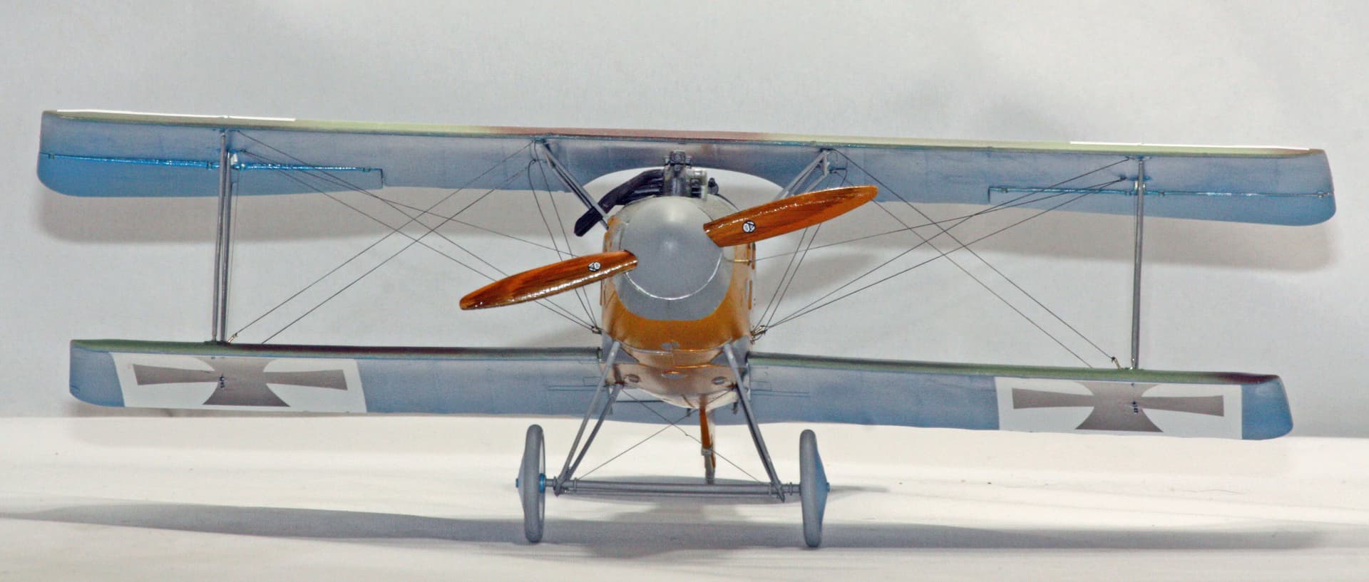

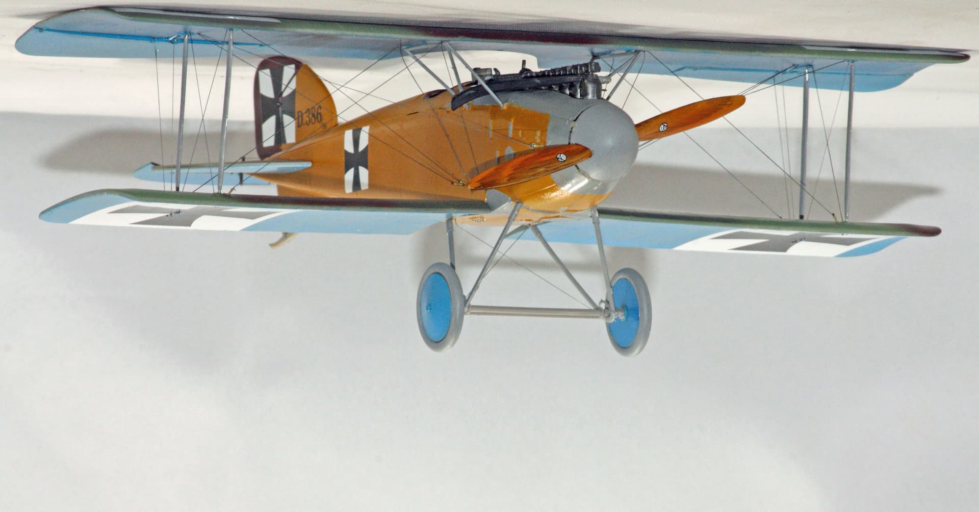

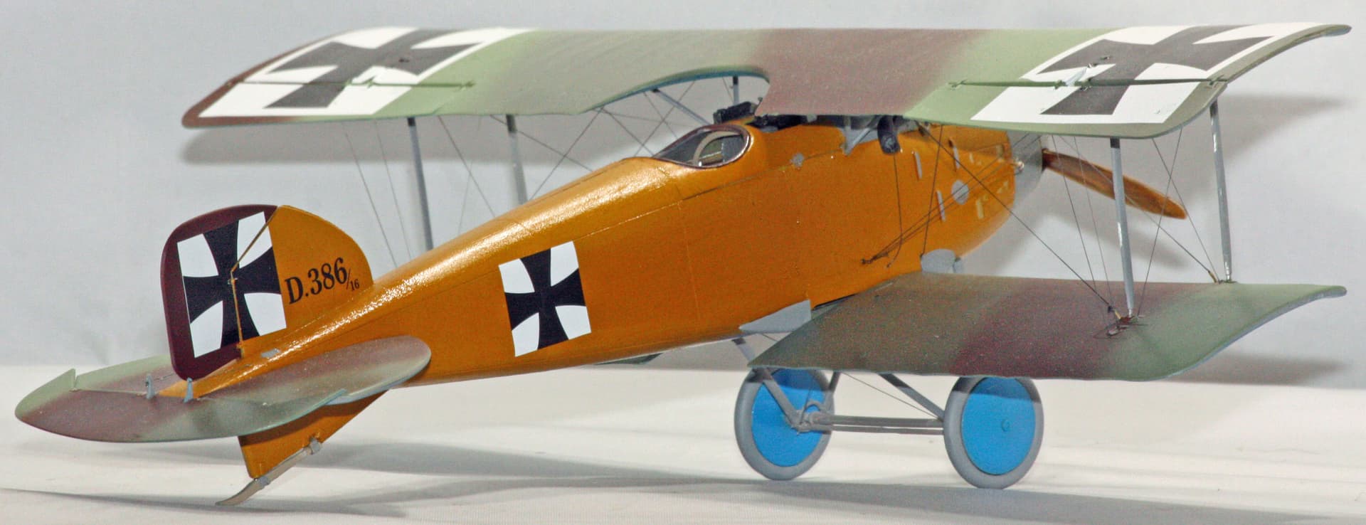

I’ve used regular model paint for wood surfaces, but I got my best results when I went with oils, such as with this Albatros D.II
While I did use oil paint for the fuselage, it wasn’t intended to show graining. The prop is where I did the graining effect.

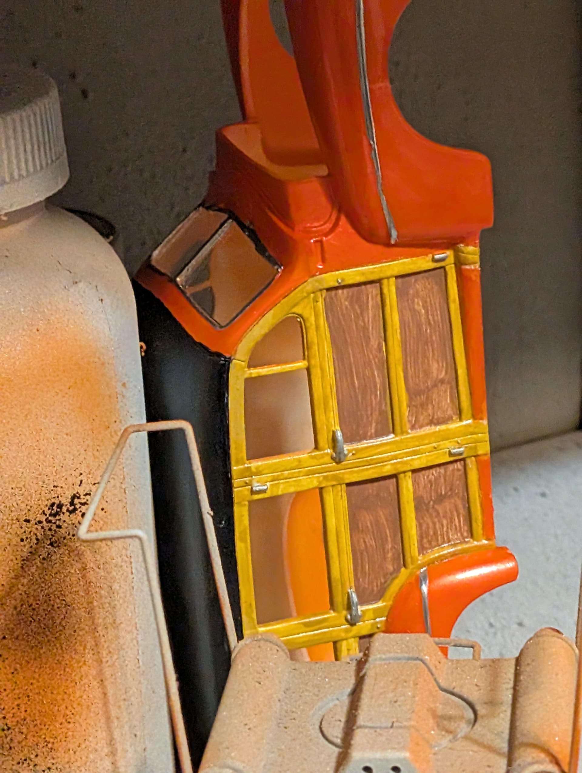

Wow amazing, looks real. Excellent workmanship, i’m not sure which way to go. I see great results with oil, model paint. I have a 23 Depot Hack truck in my stash. That has a lot of wood panels on it.
@bigsparky65 Your results look good. Even before you dull coat it looks good. I’m not familiar with this kit. Does the part that you painted to look like wood have a wood grain texture already molded in or is it smooth and you painted all of the grain look?

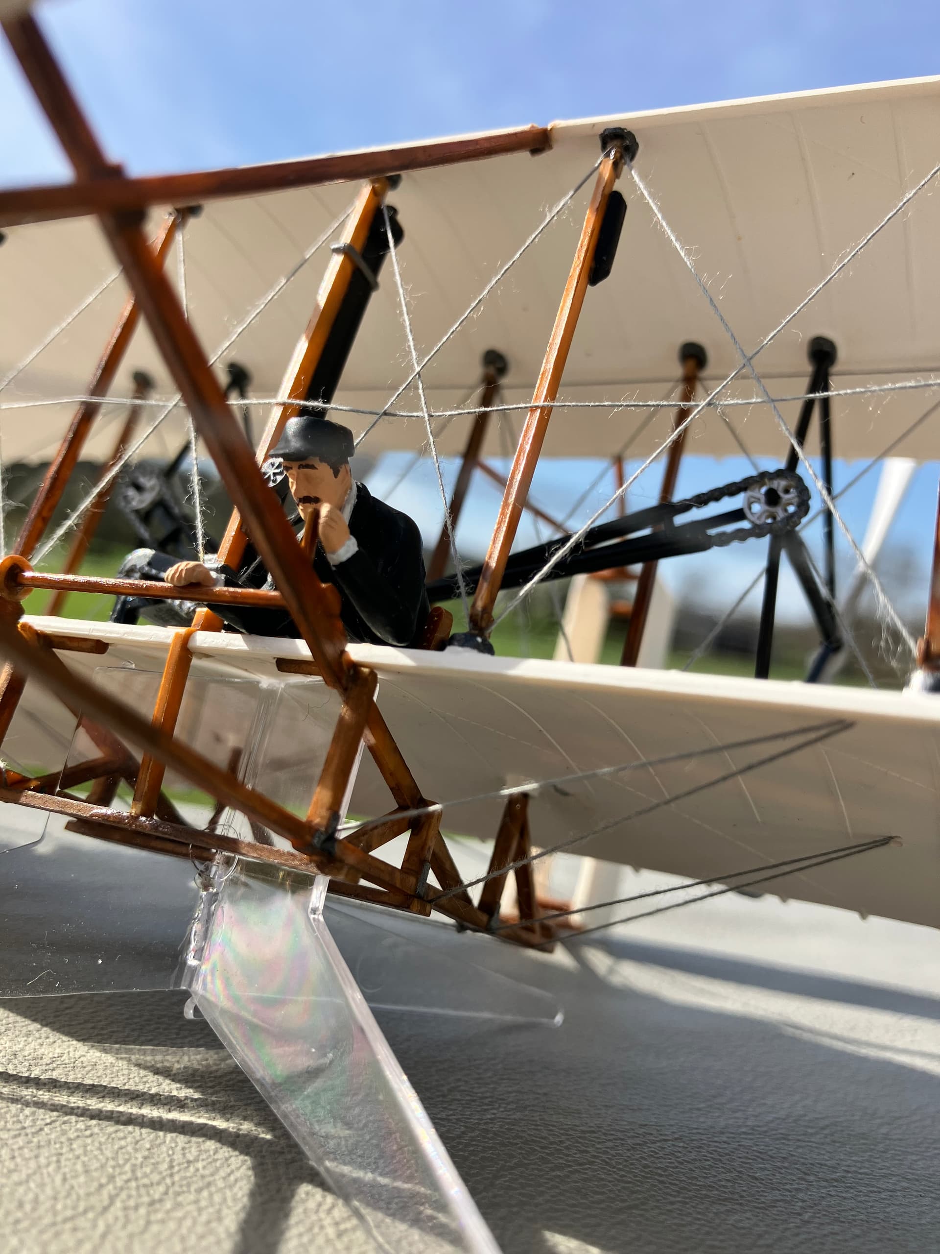

FWIW, I don’t often have need of making something look like wood, but when I built this Wright glider I used Tamiya Brown Panel Line Accent Color over the beige-ish colored plastic then covered it with Tamiya clear orange to make it look shellacked. It turned out ok enough I think.

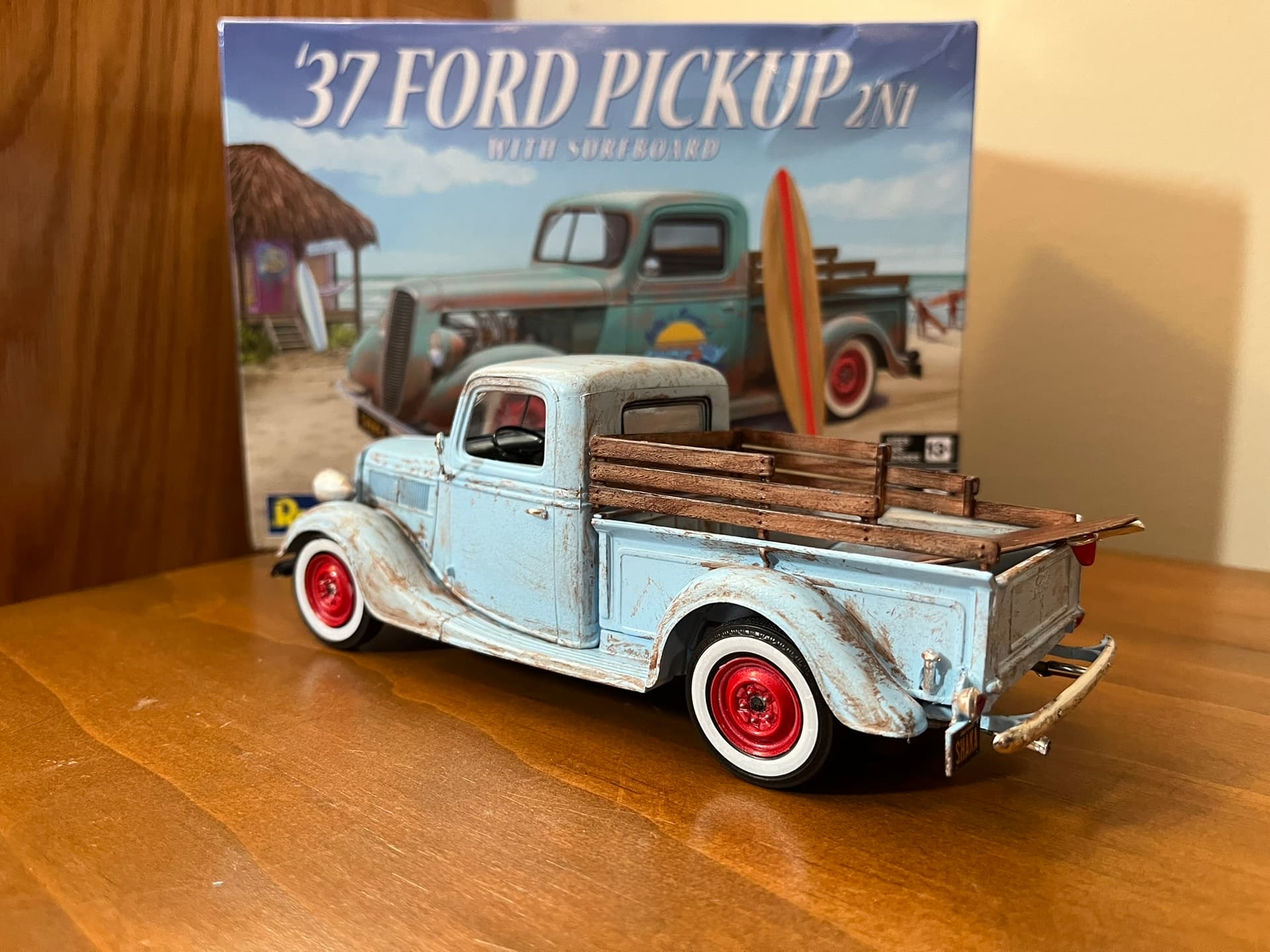

I have pretty good luck with craft paints. I start with black primer base and use tan, cedar and rust brown. Thin it out with water, it can get thick and hide the grain molding, but it is pretty forgiving since you can wipe it off with a wet cloth or Q-tip before it fully dries. Mod Podge Matte clear spray can coat or hi shine when desired can be used to seal it once you get the desired look.
The wood bed rails looked good to me too using this method.
