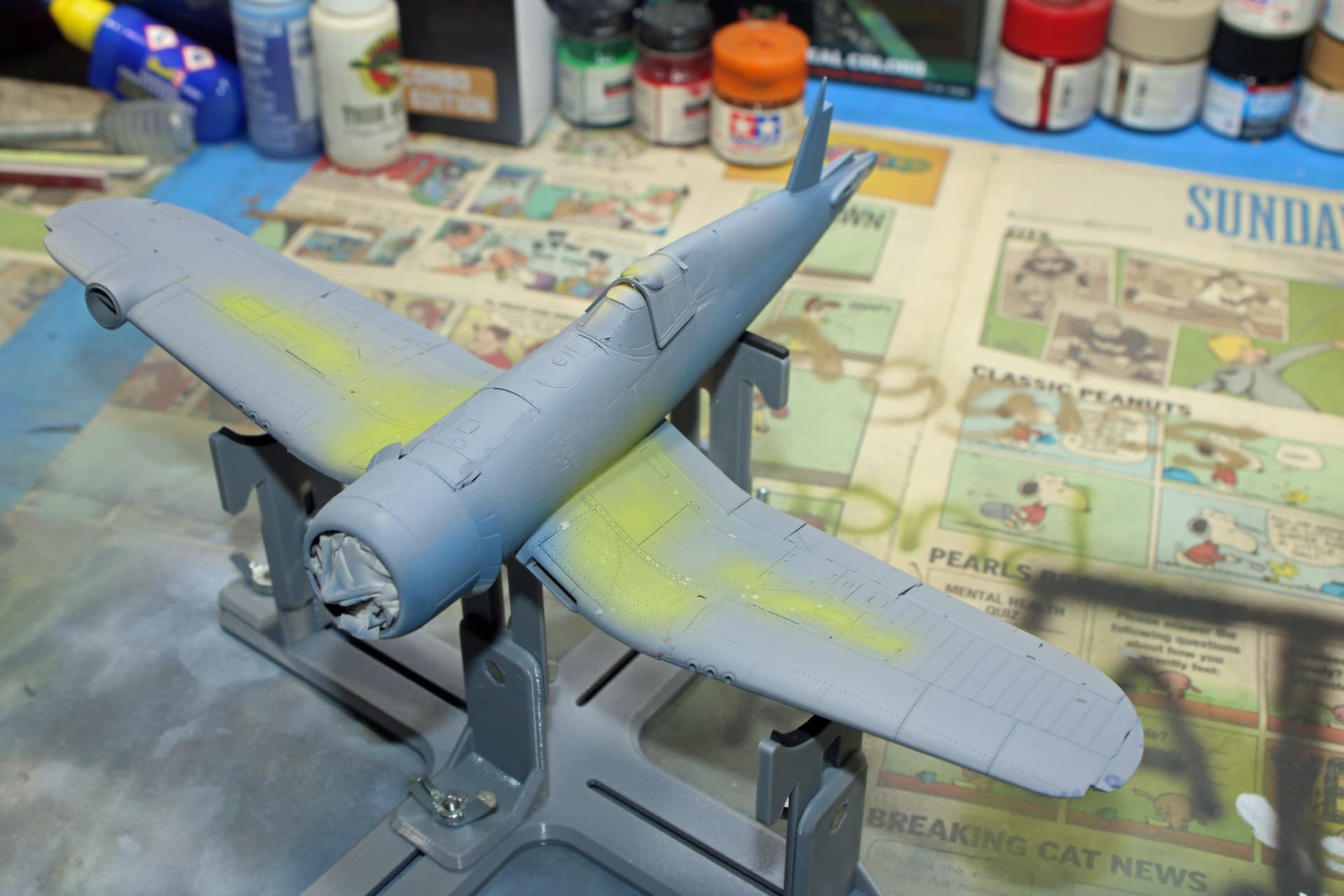

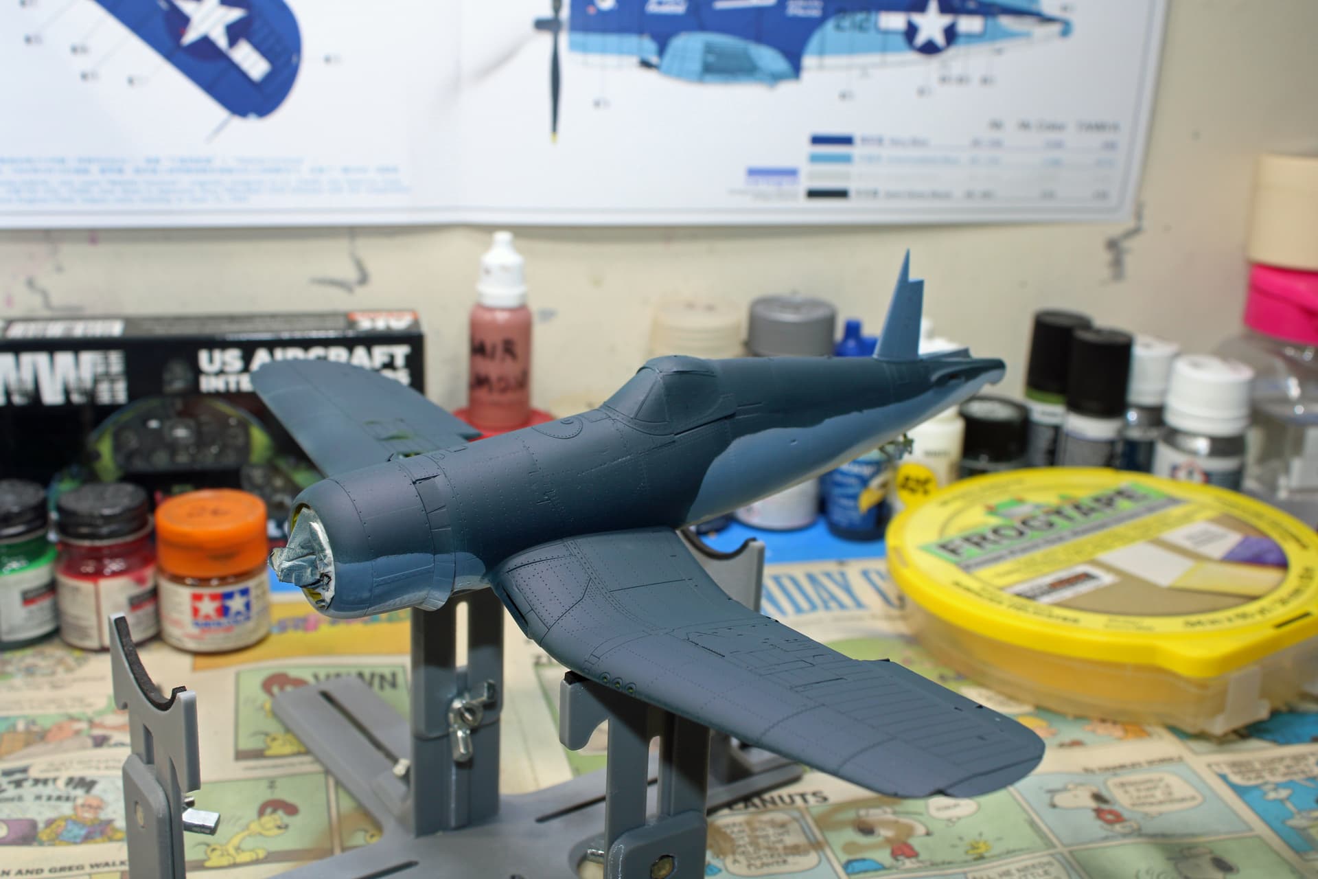

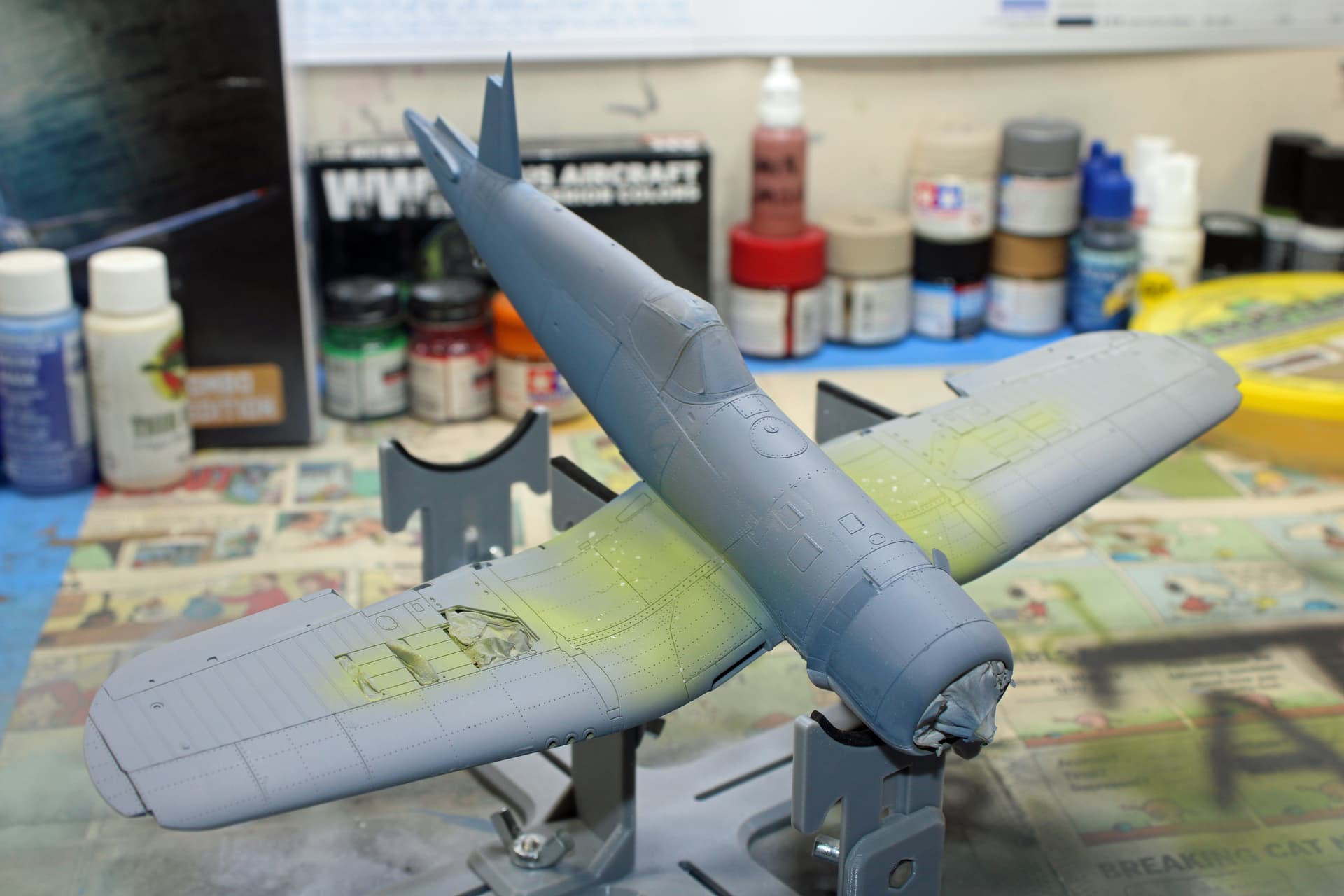

Over the last couple of days, I managed to get both builds aligned in terms of how far I’ve progressed. Yesterday I fixed a problem with the masking on the -2’s canopy and got both canopy parts temporarily installed. I also masked wheel wells and the cowling openings so that this morning I could start the painting process with a coat of Grey primer (Stynylrez).
This is not going to be a quick paint job, however. Next is to put down a splotchy coat of yellow primer. The Corsair was known for paint chipping along the upper inner wings, revealing the primer beneath. Then I’ll likely paint black wing walk lines on the wings; those will be masked with very narrow tape strips. Then to get the chipping effect, I’ll do a salt treatment before starting with the top side paint.
That looks so much harder than it needs to be, kudos for your perseverence with it.

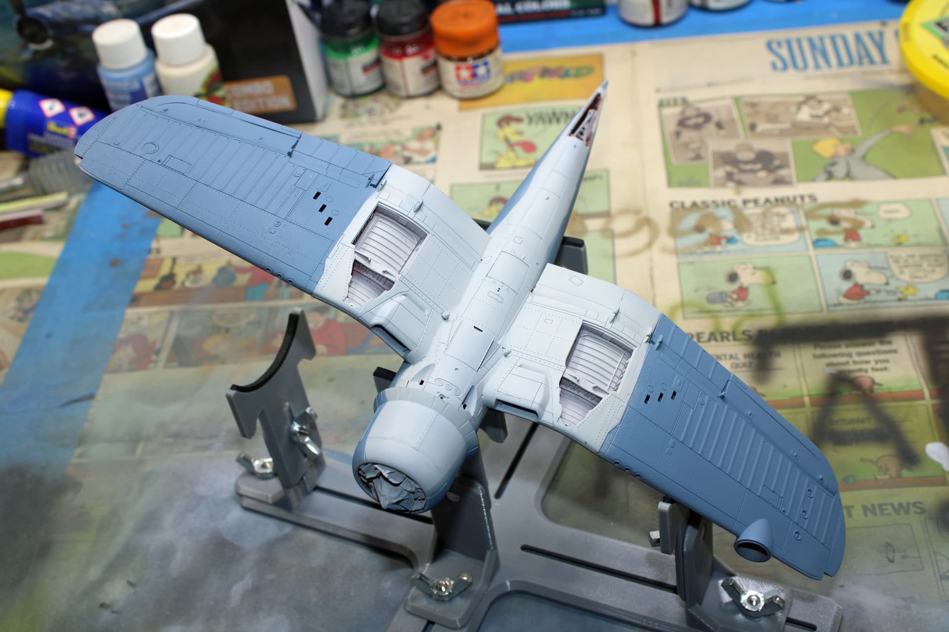

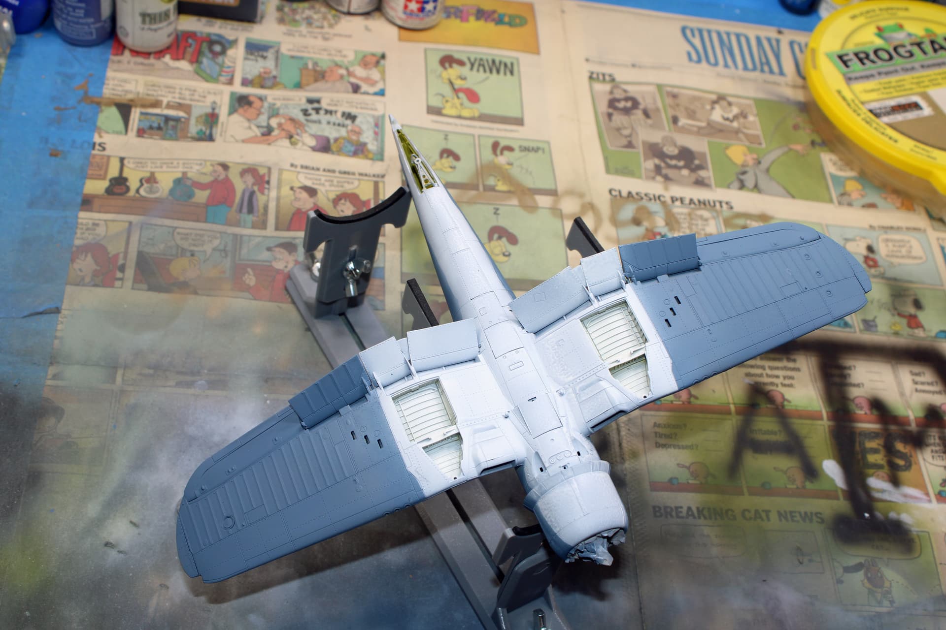

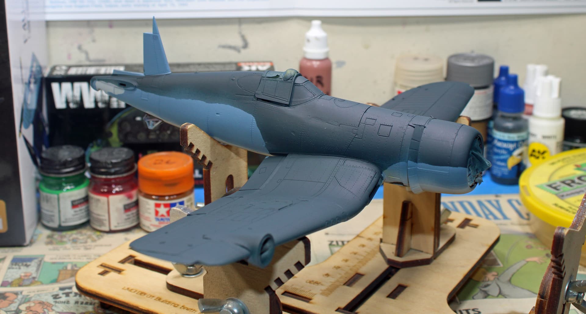

Got a little work done today before my departure for Aggieland, with a game tonight at Kyle Field. I painted the underside surfaces - M-485 light gray for the -2, insignia white for the -1A. I later masked underside surfaces and painted intermediate blue along the fuselage sides, rudder, and outer lower wings.
The zinc yellow chromate for the upper wing surfaces is already in place, but I’m not happy with it. I may very well add to it tomorrow. I tried working with the salt we had on-hand, but many of the flakes were way too big. So no salt treatment this time. I will need to clean the upper wings real well before doing any additional painting there, as there are still some salt flakes present. I will come back after the painting to add some zinc yellow chromate with the tip of a toothpick or my finest brush tip. And I will use the kit decals for the wingwalks.

I’ve never tried the salt technique before, so this is interesting to follow. When you say the salt flakes were too big, do you mean they were masking off too large an area and leaving paint chips that looked oversized for the scale?
I’ve seen people use salt for weathering, but I’ve never actually tried it myself. I like the idea of going back with a toothpick or fine brush for more control. I’m curious to see how that works out.
Yes, many of the flakes were simply too big for the scale. Our paint was better than what the Japanese used, so you aren’t going to see a Corsair with massive amounts of paint missing. Having said that, our paint was not impervious to wear and tear and the South Pacific environment. This is the look I’m going for.

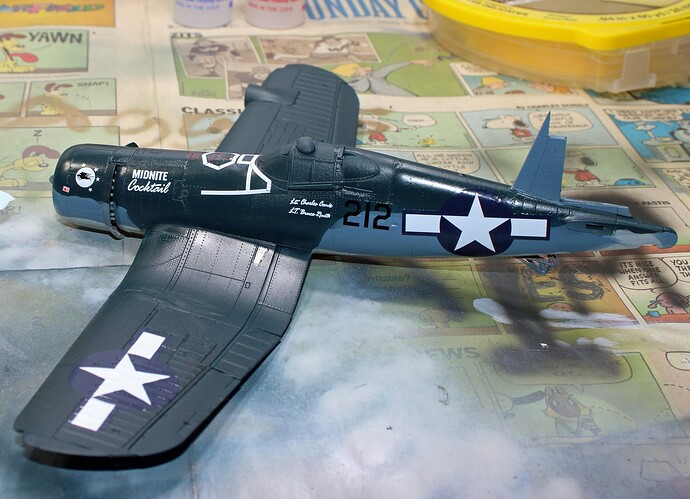

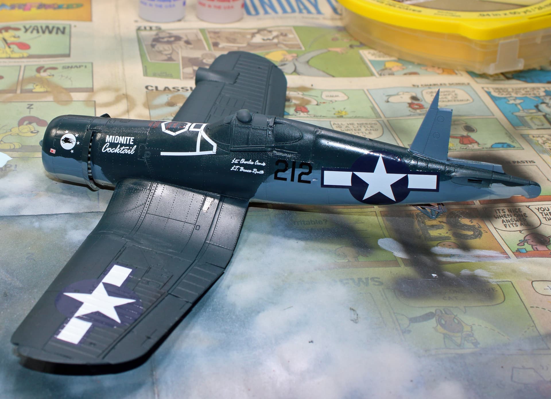

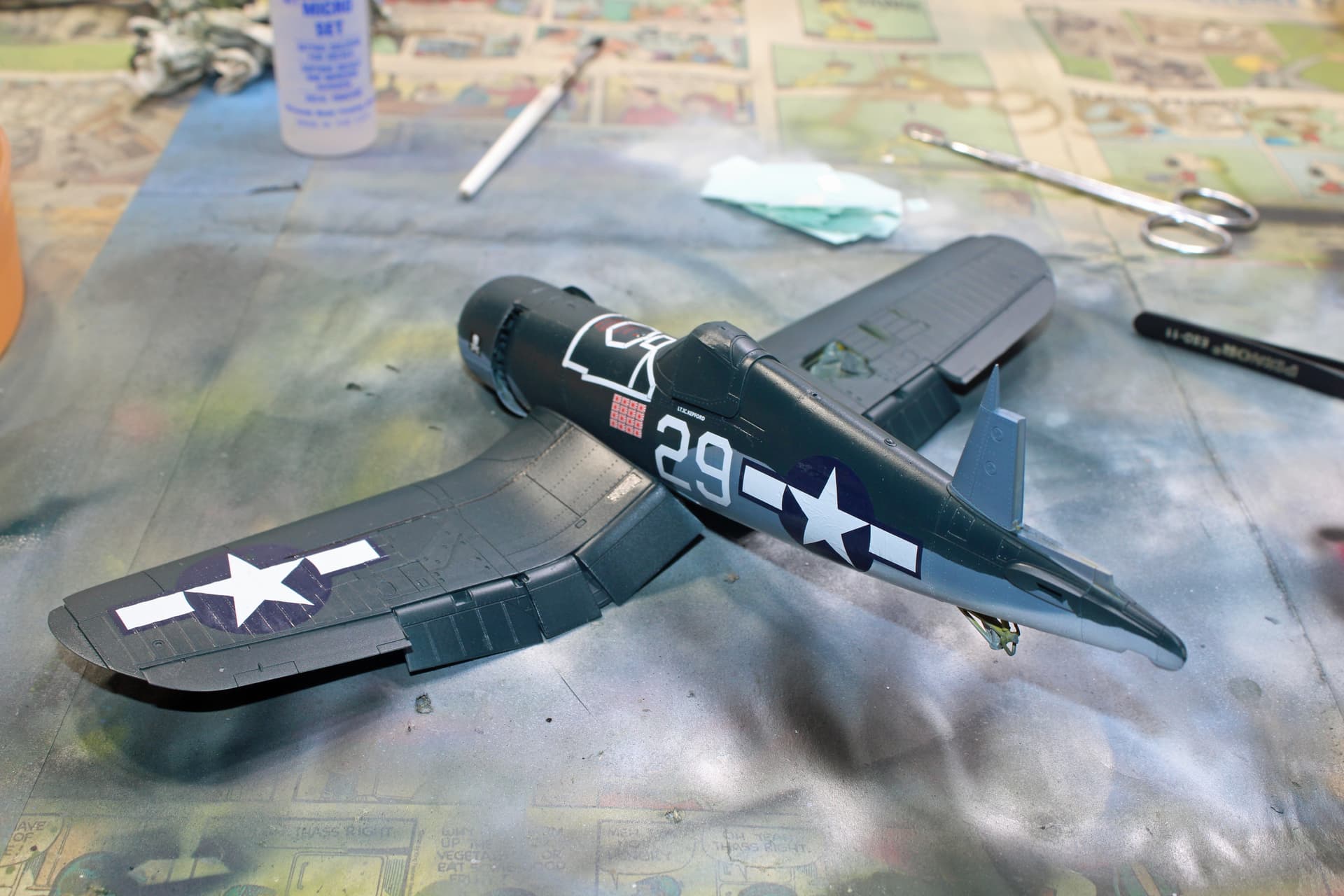

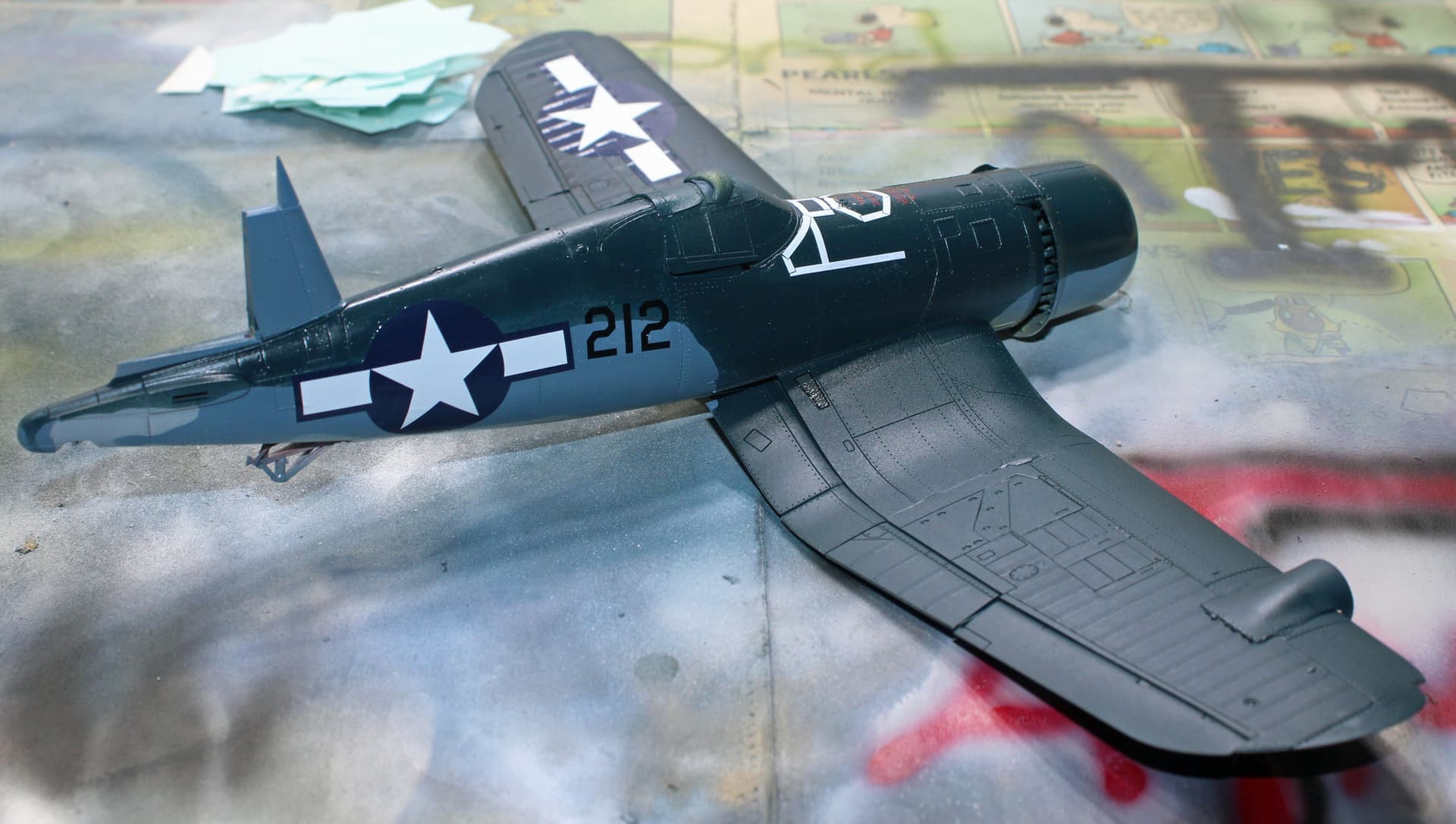

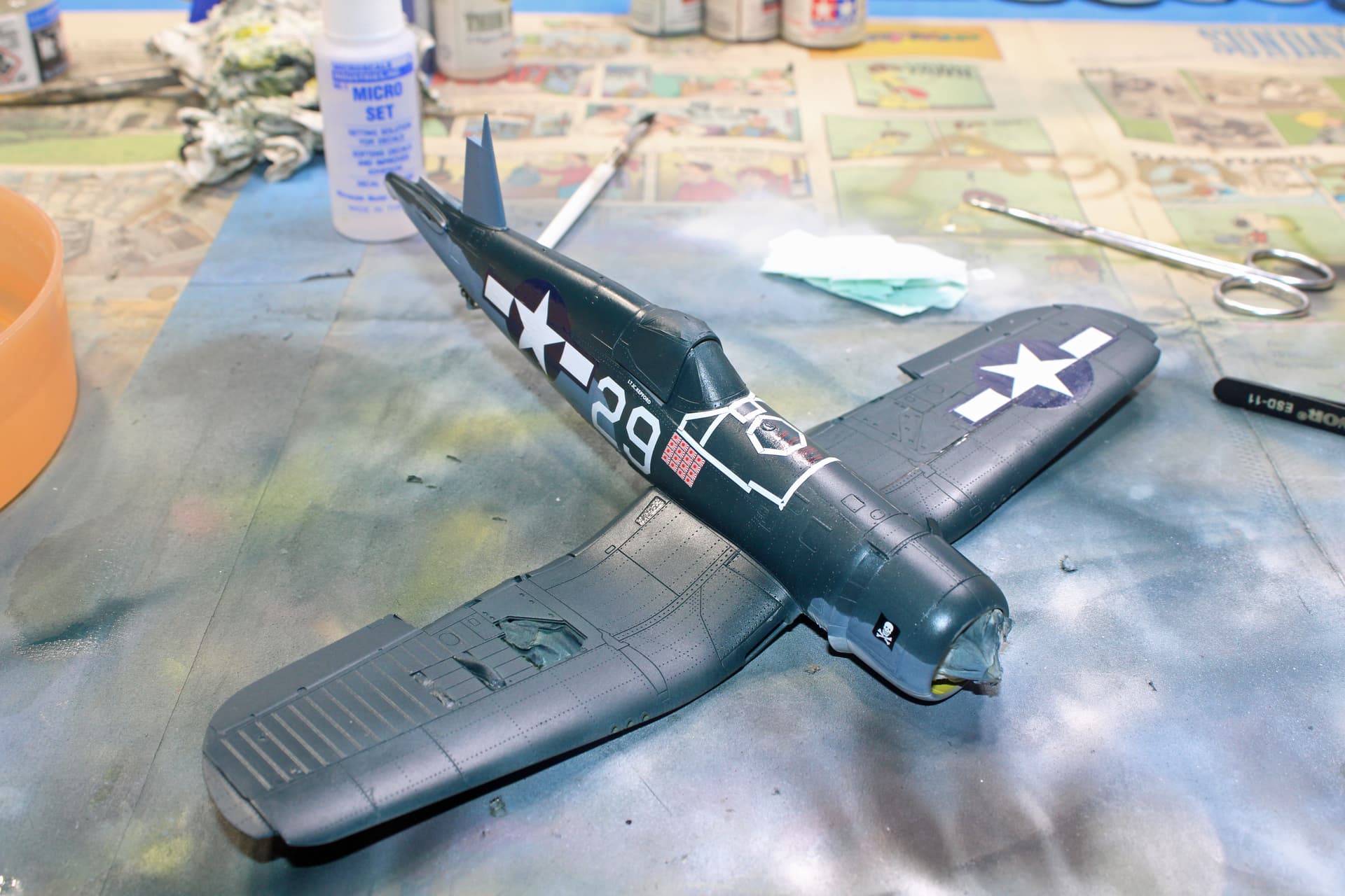

I got a lot of work done today, as well as another setback.
Both are painted as per base camouflage, although I am going to do some fading in the next day or so. Both are almost fully decaled - except for the wing walks. The first decal I put on rolled irrecoverably. So next up will be masking to paint the wing walks. A setback, but one that is not insurmountable.
-1A
-2
I am close to done, and am very happy for that. These kits look great in the box, but the actual construction leaves some things to be desired. I’ll be glad to move on to whatever comes next.
Nice job on the paint,looks great,I’m easing my way thru mine,being very careful dry fitting stuff and it’s going well so far.
Looking good. Seems like you’ve had to wrestle with these but they are looking the part.
