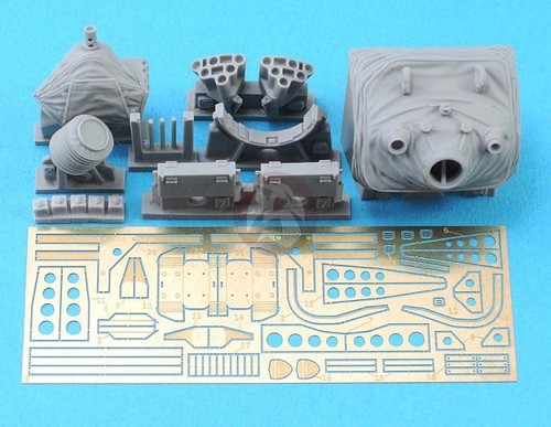

I personally would stick w/the AFV Club M60A1 and source the smoke launchers and storage boxes somewhere, either in resin or plastic. The rest is in the box.
This set, would give yo all you need to build and M60A1 RISE/Passive and add some details to the kit.
Legend M60A1 Patton Tank Basic Detailing Set (AFV Club AF35060) LF1305
I saw that, but I’ve never dealt with resin before, and I wouldn’t wanna trash such an expensive model on resin experimentation. I’ve heard it’s not as easy as a drop in replacement
I think you should give it a shot. Resin is not hard to work with. You have to start somewhere.
Yeah, I feel ya on that. My reservations are cutting my teeth on resin on a 60 dollar kit.
He’s right that it isn’t that hard to work with resin. Razor saw blade to cut the mold pour stub away and sometimes you need to cut away some plastic of the kit part. You do have to use CA glue (super glue).

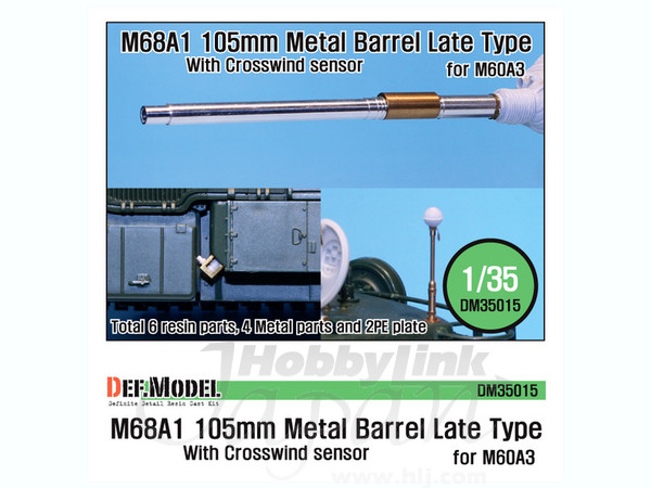

I haven’t done a side by side comparison to see what sprues are different between the AFV A1 and A3. I did notice that my A3 came with two different barrels; didn’t take a close enough look to see if one is the plain unshrouded one though.
The two barrel types in the AFV Club M60A3 kit are a late and early M68A1 thermal shrouded barrel. The early M68A1 barrel has separate straps that hold the shroud on. The late M68A1 barrel has a differently designed shroud that has integral clips and does not require the straps. Neither barrel is the correct M68 unshrouded barrel appropriate for an M60A1.
Def Model also offers both the early and late M68A1 barrel in metal. You can see the differences below.
Def Model also does just the M68 barrel for an M60A1.
Then I still stand by my recommendation to get the A3 and just use the plain DEF barrel (or similar brand) to backdate it to a RISE/Passive. Barrel looks like an easy fix.
