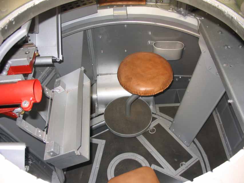

The Brits painted their interiors silver for a good part of the war.
Hey thanks Bob those pictures on that site are great for detail :slight_smile:
When in the war was this? Got a picture? Gotta see that before I believe it [:D]
Walkarounds of Imperial War Museum and Bovington will show this. Even reading the wartime manuals confirms this.
