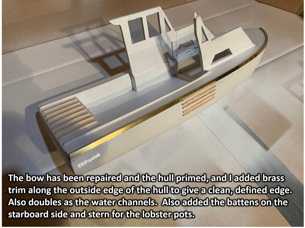

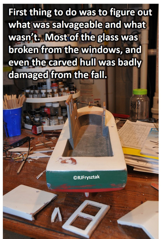

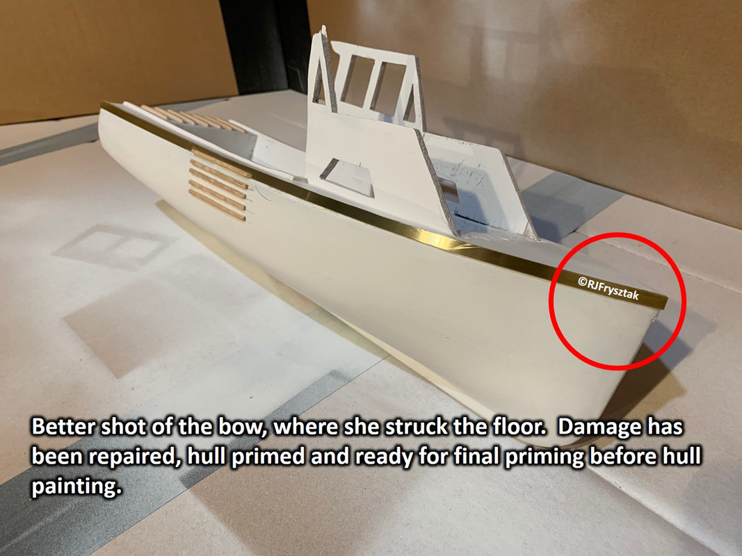

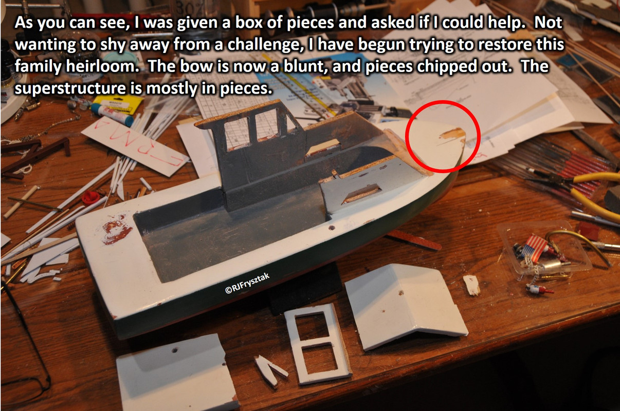

So a good friend of mine dropped the lobster boat that has been in his family for years. Not wanting to just toss it, and knowing that I dabble in building ships, he asked me for help. Not really knowing how bad it was, I told him I would take a look. What I got was a box with a carved wooden hull, and lots of pieces. LOTS of pieces. The boat had obviously hit the floor right on the bow, as a large chunk was missing and there was no longer a discernable “point” to the bow. The superstructure had exploded, and most of the glass for the windows had shattered. The rudder and stern were also badly damaged, and the piece that held the propeller was missing. Most of the other bits that make it a lobster boat survived, but were either the wrong scale, or not really useable. Even the little lobster pot would not have held a lobster for long. Here are a few pics to show my progress so far:

Most of the superstructure parts have been patched and primed. Just setting the trim pieces so I can install the windows when the painting is completed.
Any and all tips and suggestions appreciated. I don’t want to drastically alter the basic structure of the boat (so it is close to the original heirloom), but I told him it would be a bit “updated” using period correct parts, which he did not mind.

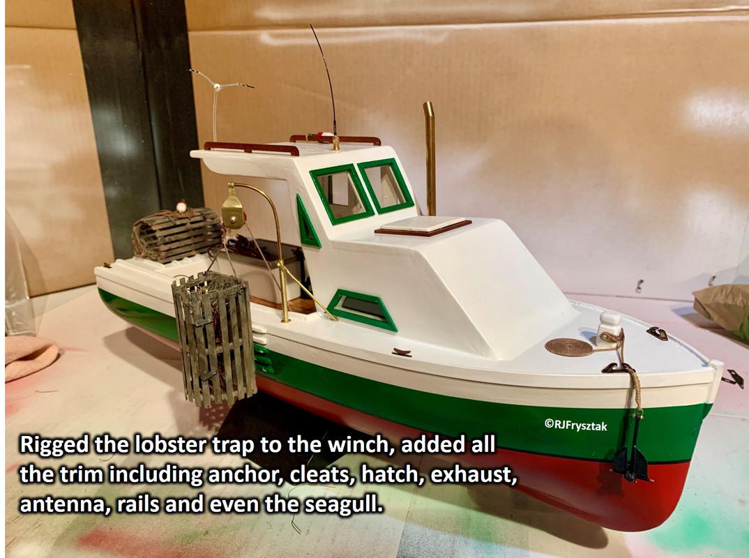

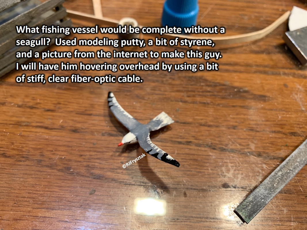

Is it Good? That is up to you and the client/friend. Now as to my opinion, What is wrong with this little vessel? Nothing that I can see. I would’ve used wood along the edge of the deck . Other than that what’s your problem? You are doing a great job!
The only thing I have a problem is this. You slipped into Tourist chotschke mode. Who needs a sea-going Pigeon anyway. ( That’s what I call Sea-Gulls)
He had a seagull on the original. It was glued to the now demised lobster trap. Broke his wing. Thought I would replace what was there.
I agree with your assessment of the flying rodents of the sea. All they do is poop on everything then steal your cheetos. Horrible little creatures.
The reason I used the brass edging is that I had in in the shop, it was easier to bend, and helped hide a few extra dents. Plus it gives a nice, clean edge.

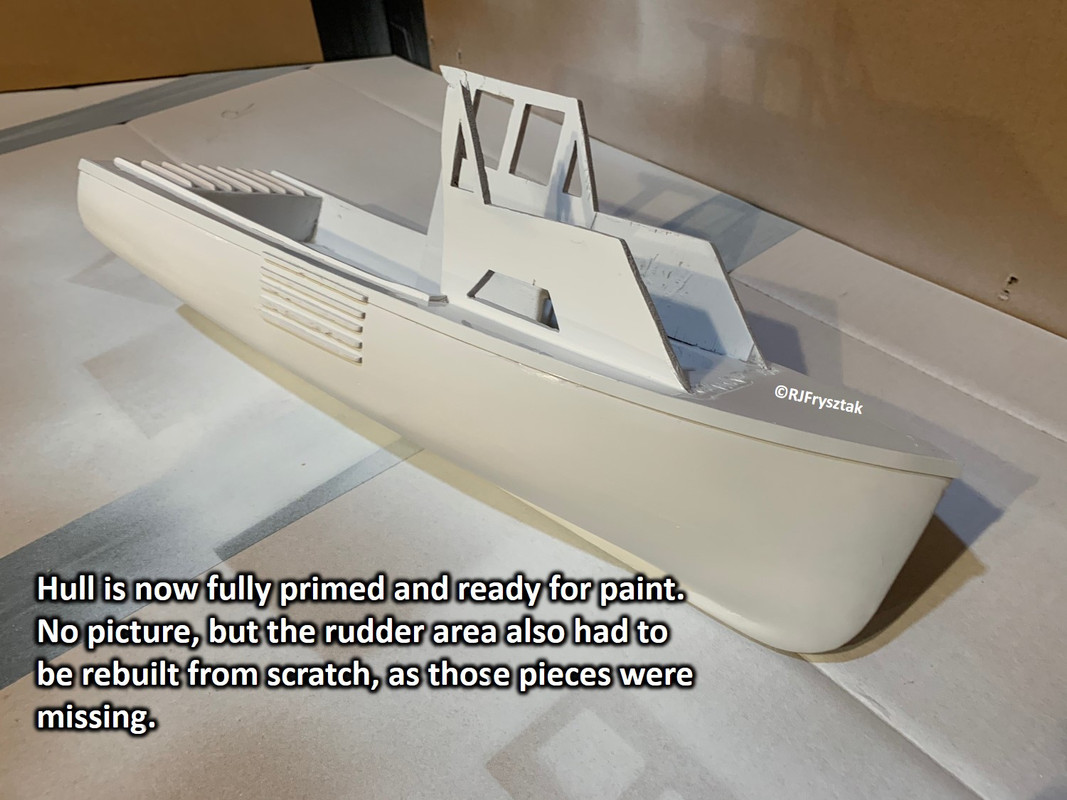

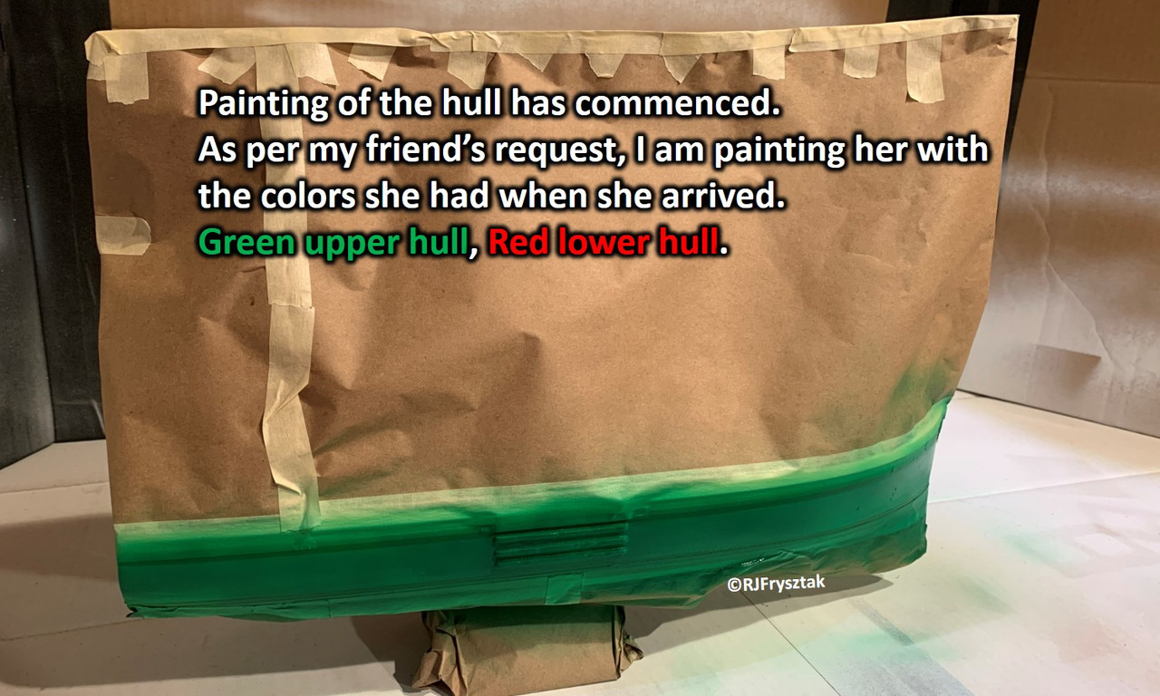

Finally got all the pieces put back together. Had to remake a few, as the roof was badly warped, and there was a piece missing (probably under his couch). Sanded and primed, filled in a few blemishes, and primed again. Taped in order to start the topcoat of paint. Upper hull will be white, hence the white primer.

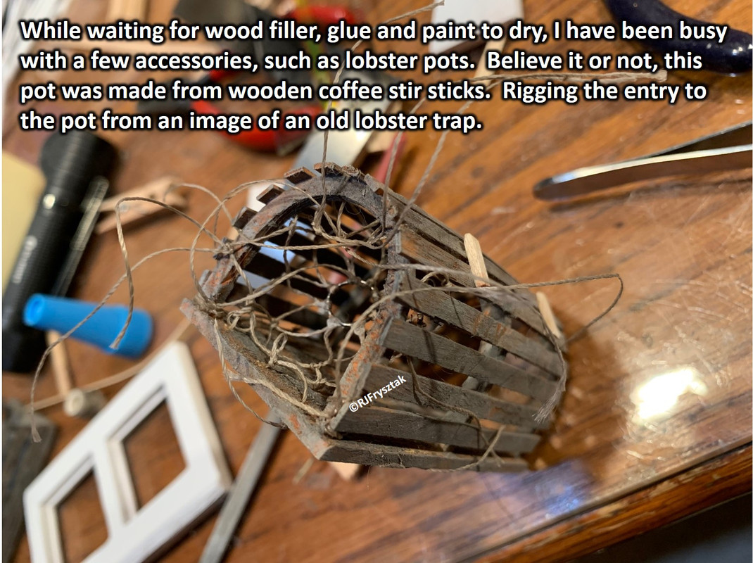

While waiting for the paint (again), I picked up a few little toy lobsters. Naturally they were bright red, and not very realistic. So I painted them dark brown, washed with a thinned down black to highlight the detail, then added a bit of light orange, washed again with a very thinned out brown, then clear coated. Then I stuffed one in the other lobster trap which will hang from the winch on the starboard side of the boat.

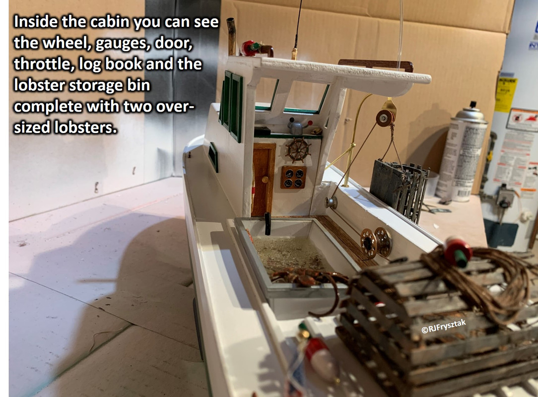

Finally, there has to be a place to hold the little nippers while heading back to port, so I looked at a dozen or so images of real lobster boats, and most had some sort of holding tank. So I built one out of styrene stock. Gave it a nice aluminum edge to dress it up. Filled it part way with clear gorilla glue, dropped one of the lobsters in, and added a bit more clear GG. May add another in there trying to crawl out.

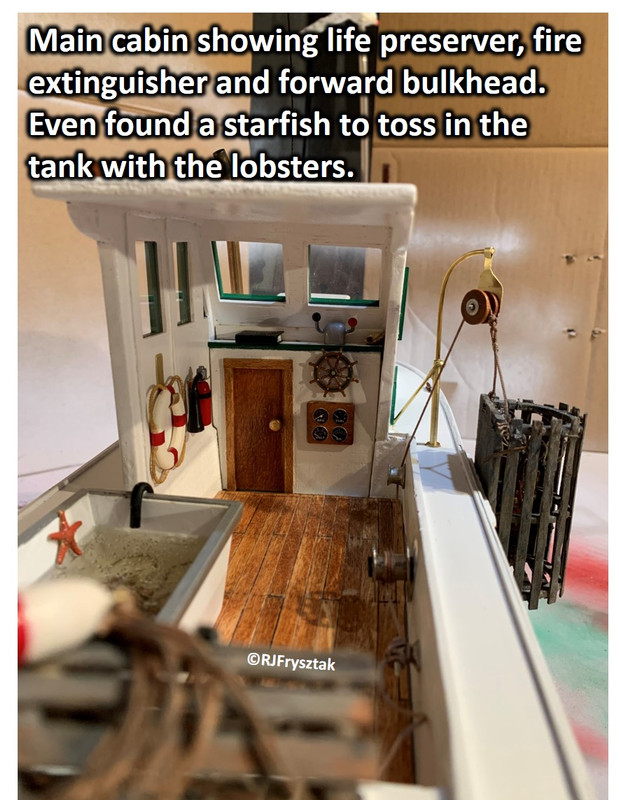

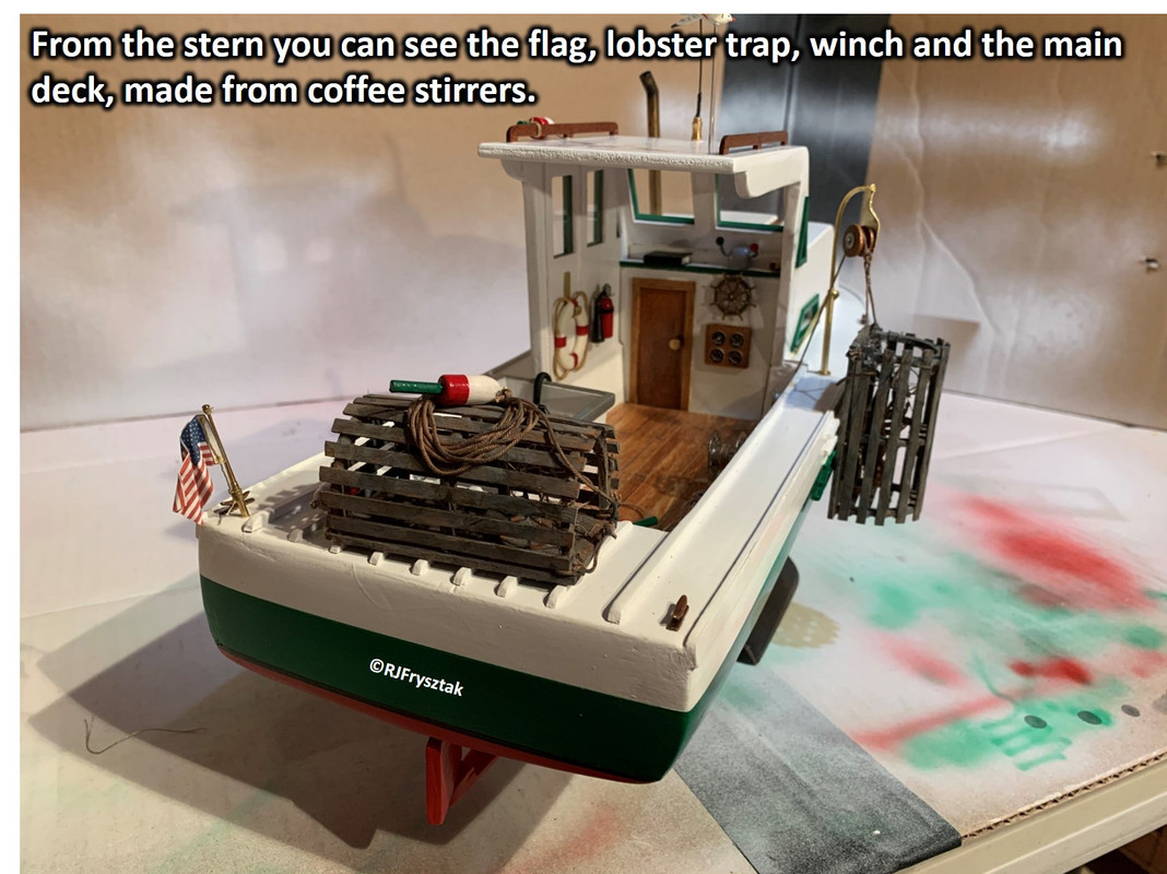

Well, she is finally done. Finished putting in the last windows and trims tonight. Trimmed the windows with the same green as the upper hull to try and give it a little pop. All deck and cabin furniture added. Already heard back from the owner who is ecstatic to get her back and looking better than ever. Enjoy.
