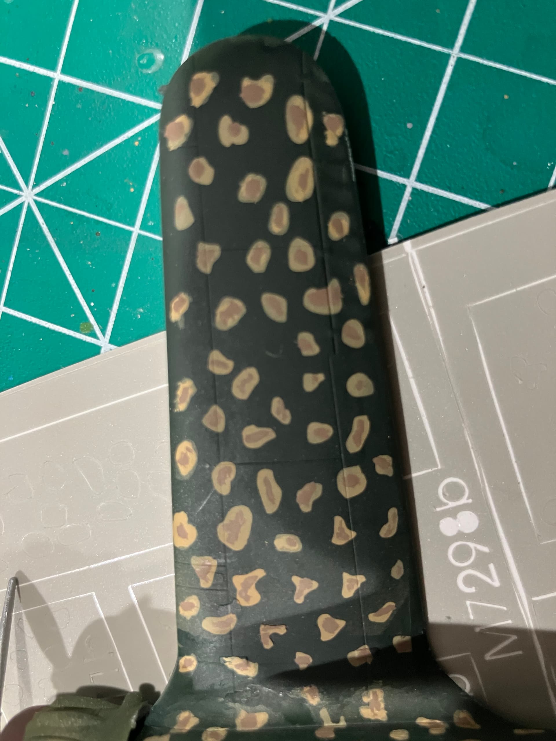

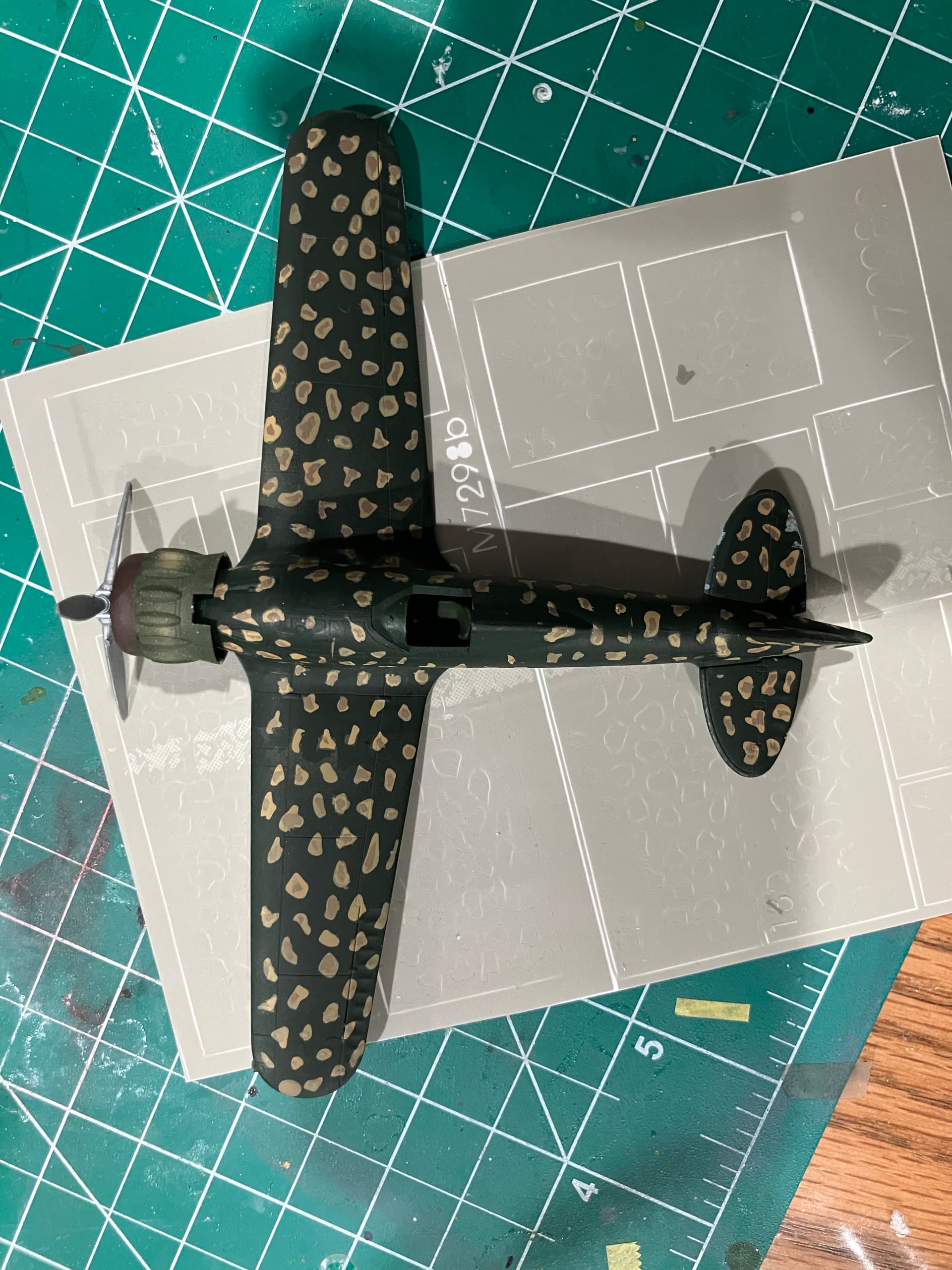

Well! Gave it a try. The instructions were of no help. The mask, all being rectangular, were impossible to place on the model with out major cutting. Because the mask were light gray they blended in to the main, base green, which made registration even harder. The numbers of the mask first had to be determined by finding and removing the cut out on the mask.. I improvised on parts and this is the results. I gave up attempting the second “B” mask as registration with the “A” mask was impossible. I hand painted the 'B" color. I think the amount of time it took to get any value from these was not worth it, But in 1/72 scale, I not sure most people will notice. Next time I’m going to look for a miniature stamp at Hobby Lobby.
