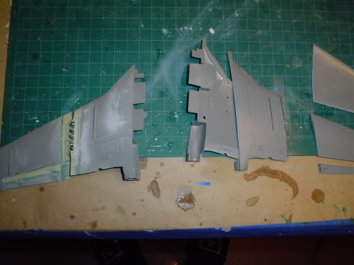

I also started working on the wings and Paragon wingfolds. I’m starting with the left one first.
I measured and cut the kit wings per the Paragon instructions, then put the wings together. As you can see, I still have to remove the outboard flaperon (I haven’t quite decided on the best way to do that to acheive the right look). In this picture I’ve got the inboard wingfold installed and am starting to blend it in with the kit wing. I haven’t done the outboard fold yet. You can compare it to the kit’s as yet unmolested right wing.

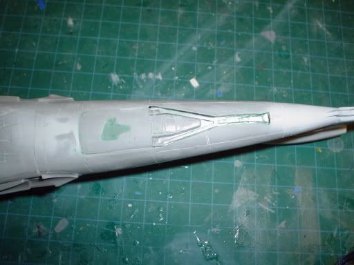

I’ve also installed the Cutting Edge replacement HF antenna (the fairing that goes along the spine). Just a little blending needed - due more to my cutting job than Cutting Edge’s part (all of which are up to their usual high standards).

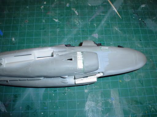

I mounted the arresting hook piece after removing the doppler radar blob and rescribing the ALE-39 expendables dispenser. The part didnt fit quite as well as I’d hoped, and this is making for some rather interesting filling and filing, but I think it will turn out OK.
Also finished the upper steps on the right-hand side boarding ladder. They are a little hard to make out here, as everything there is all bare white styrene, but I’ve decided they look better than the molded steps on the other side. So I’ve sanded those off too and will replace them with styrene. I also drilled/cut/filed a hole (hard to see from this angle) for the AOA probe protector, just forward of the ladder area and just below the top of the intake trunk. I didn’t need to “box it in” because of the way the intake is engineered in this kit.
Last, I think I’ve finished blending in the Paragon wingfold parts on the left wing. You can see where I shot some gray paint to QA the blending job and then touched it up a bit. I’ve cut the right wing, using the lessons I learned on the left wing. I’ve thinned the trailing edges from “inside” before putting the top and bottom halves together, and also cut out the flaperon (to be replaced with Paragon resin). This should make blending the Paragon wingfold parts on the right wing go a lot quicker than on the left side…
