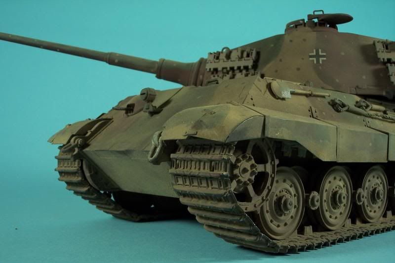

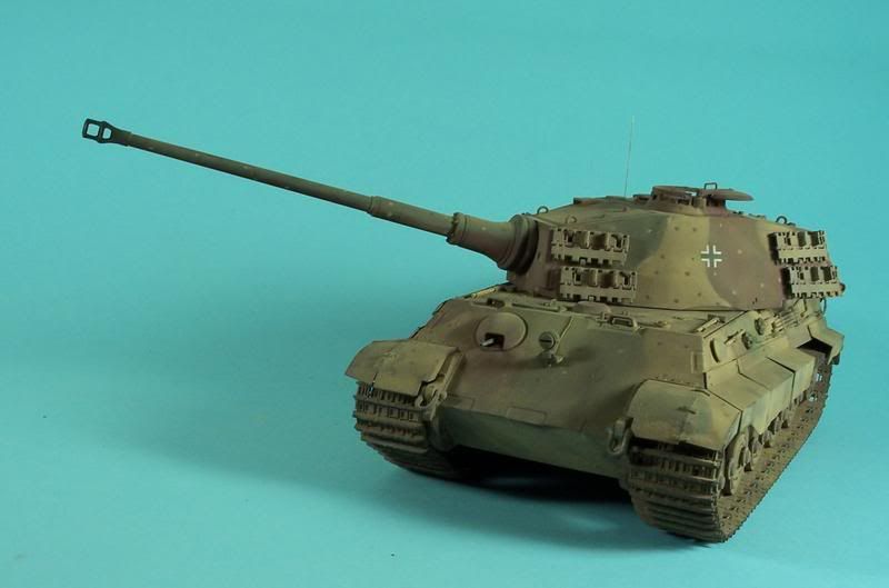

The Dragon Magic tracks aren’t half bad, I used them on my last King Tiger:
They do have some raised pin marks on the inside faces, but I didn’t find them too hard to clean up.
