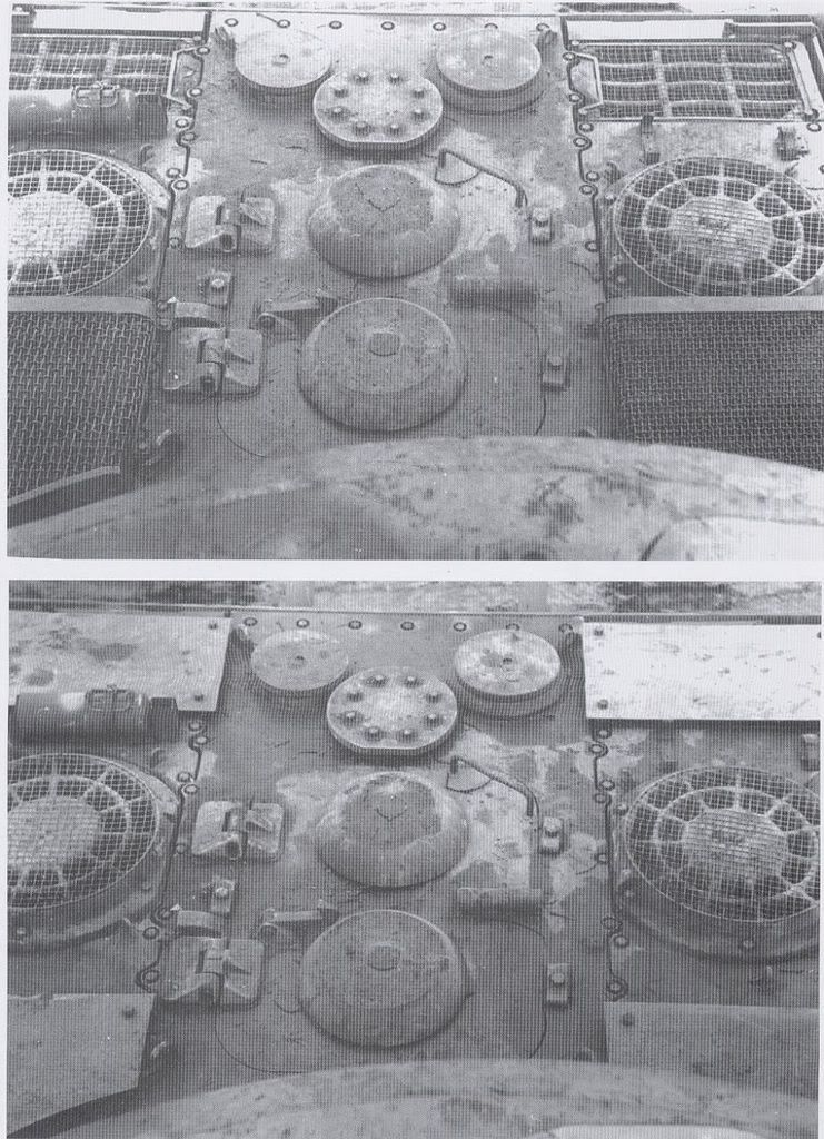

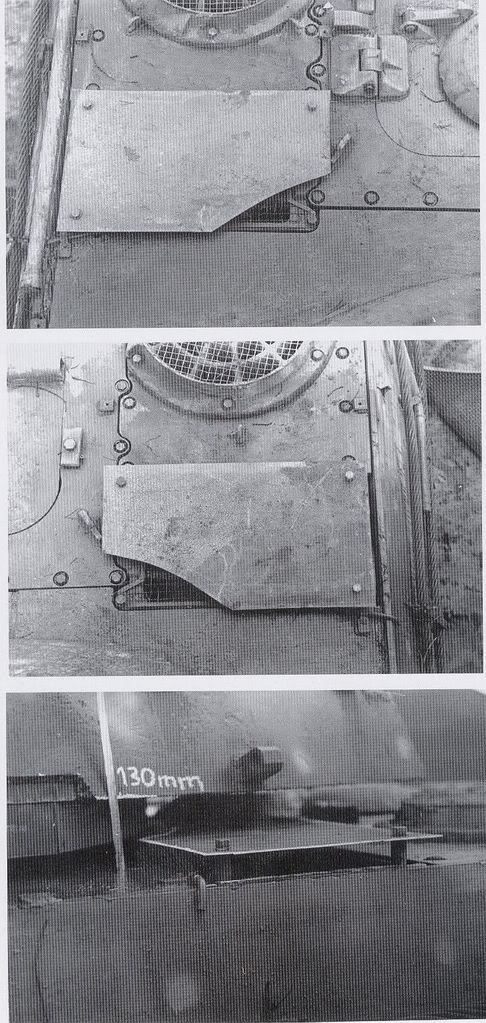

Chassis #280404 had plates installed instead of screens as a test. This vehicle was a January 1945 production and would have had 4 fuel vent lines, one of them can be seen on the bottom picture.
It wouldn’t have had a jack on the bottom rear of the hull and there would have been no jack block but there probably still have been a mounting for the jack block.
TMN1
You’re awesome! Thanks for the pics. So I will not include the plates on mine. Also, thanks for that last shot, I was curious how the side of the turret looked in that area and the clearance. [8D]
Well I don’t know about being awesome, but im happy I could help.
The pictures are from Thomas L. Jentz’s book: VK45.02 to Tiger II: Design, Production and Modifications. If you are concerned about historical accuracy on your Tiger II this book is highly recommended.
