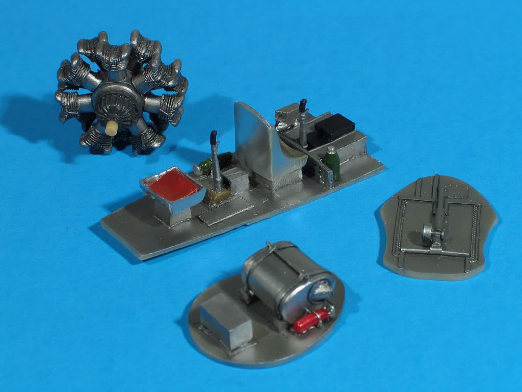

Here are a couple pics of the 1/48 Classic Airframes SBC-3 Helldiver that I’m building for a customer. The interiors of these aircraft were unpainted, and I’ve used a few different shades of Alcad. Having the Squadron “In Action” book helps a lot, since it has some cockpit shots.
Dryfitting shows that the cockpit floor doesn’t span the fuselage width. Time for some creativity !

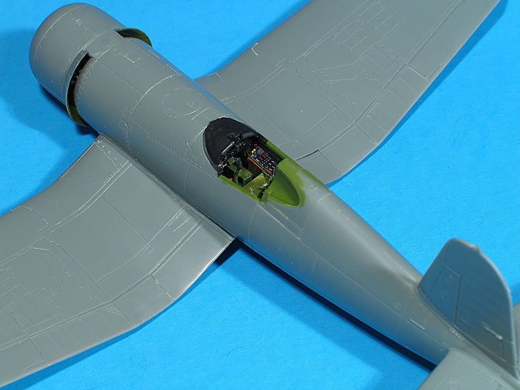

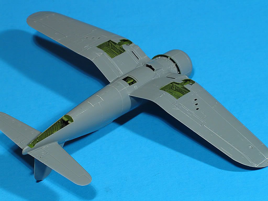

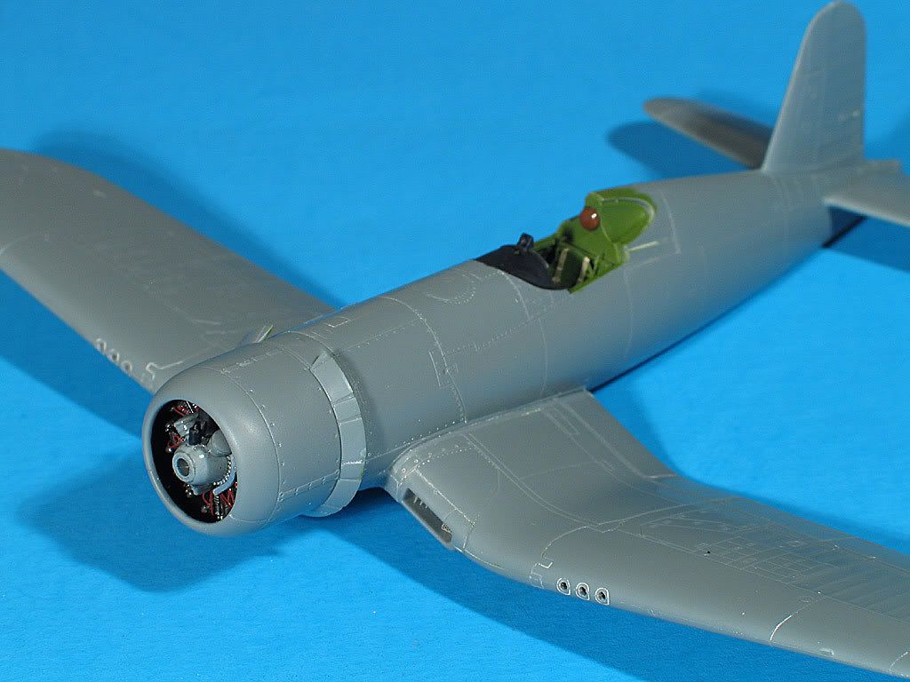

Next is Tamiya’s 1/72 F4U-1 Corsair, which I’m building for a customer. I got the airframe together, and it was easy enough to do in my sleep. The only part that took some work was bending the Eduard PE ignition wires. Landing gear is next.
As you can see, the panel lines are absolutely HUGE for 1/72. The wash will have to be very subtle, or this will look like a jigsaw puzzle surface!

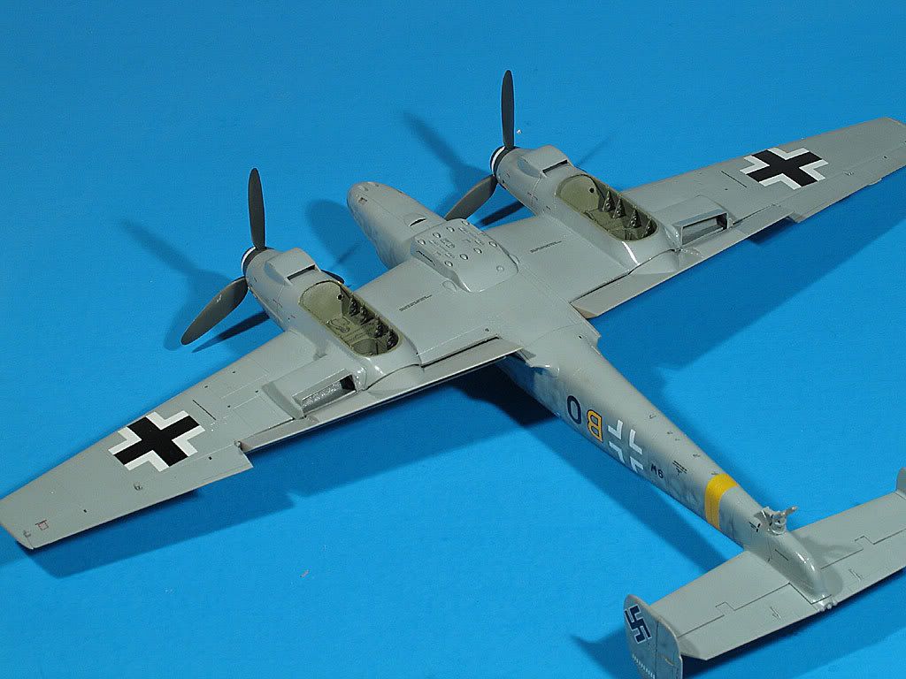

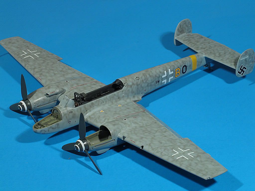

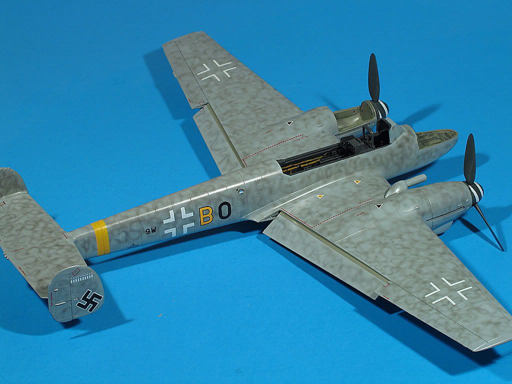

Another build for a customer is ProModeler’s 1/48 Bf 110G-4 with Verlinden detail set. The AreoMaster decals went on fine. It took three days to apply them all, since the ones on the tail are multi-part. The “kill” markings are three layers, and the swastika two. There were also a lot of stencils (the Germans were verbose !).
Time to apply the washes !

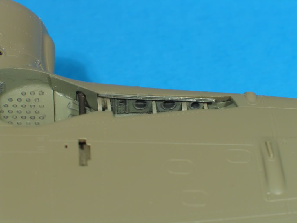

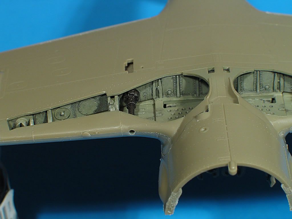

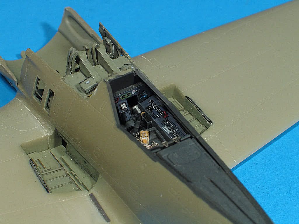

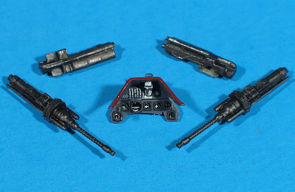

I’ve been doing some work on Eduard’s 1/48 Fw 190A-8. Eduard’s additional PE set has lots of goodies, and the placard set is nice to have. There are items for the gunbays (I won’t add the PE to the wingroot bays until after painting - masking could damage some of the parts).

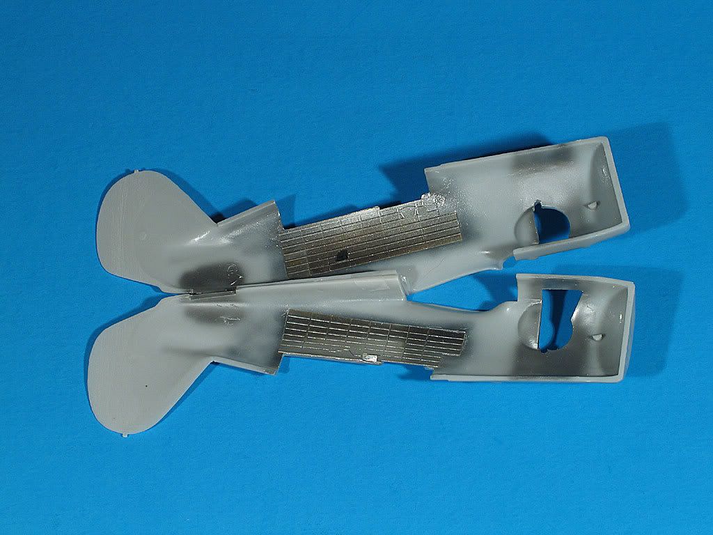

Wheel wells:

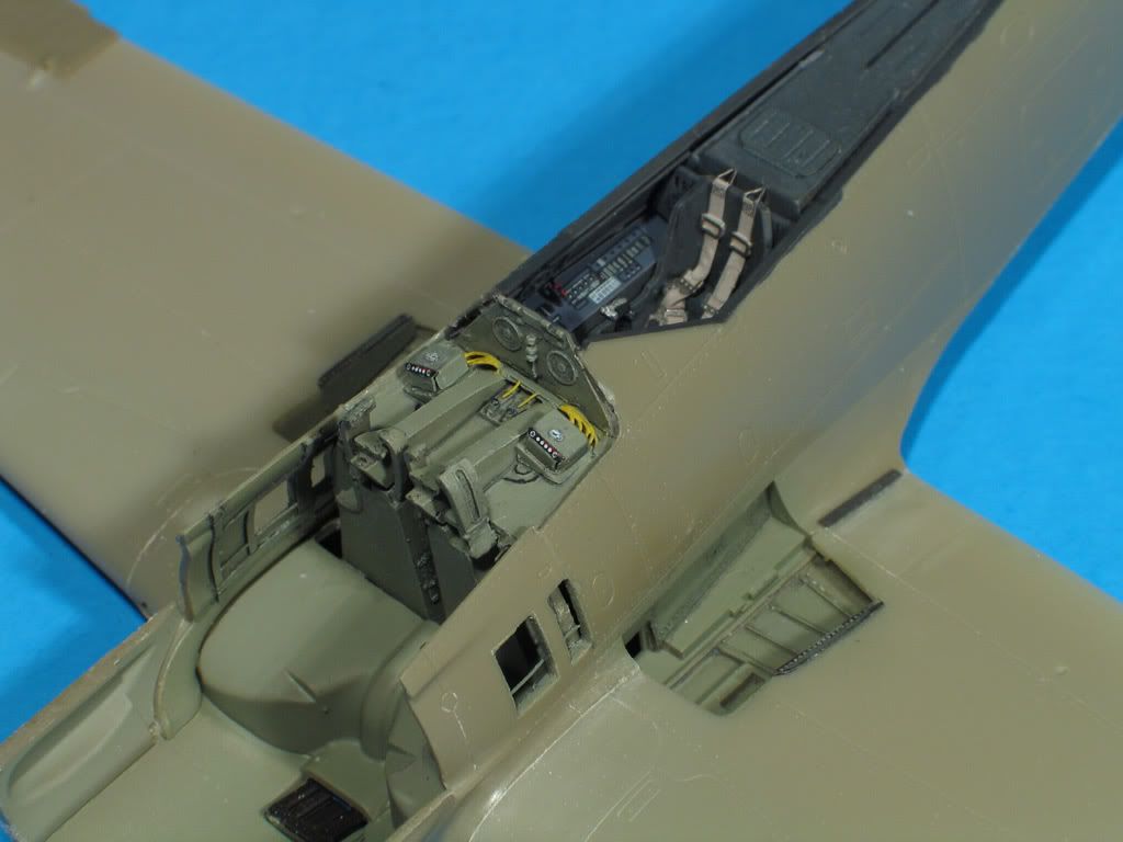

Instrument panel

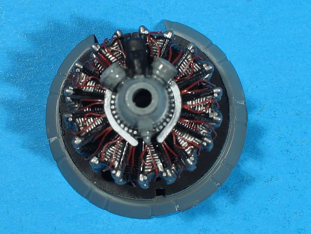

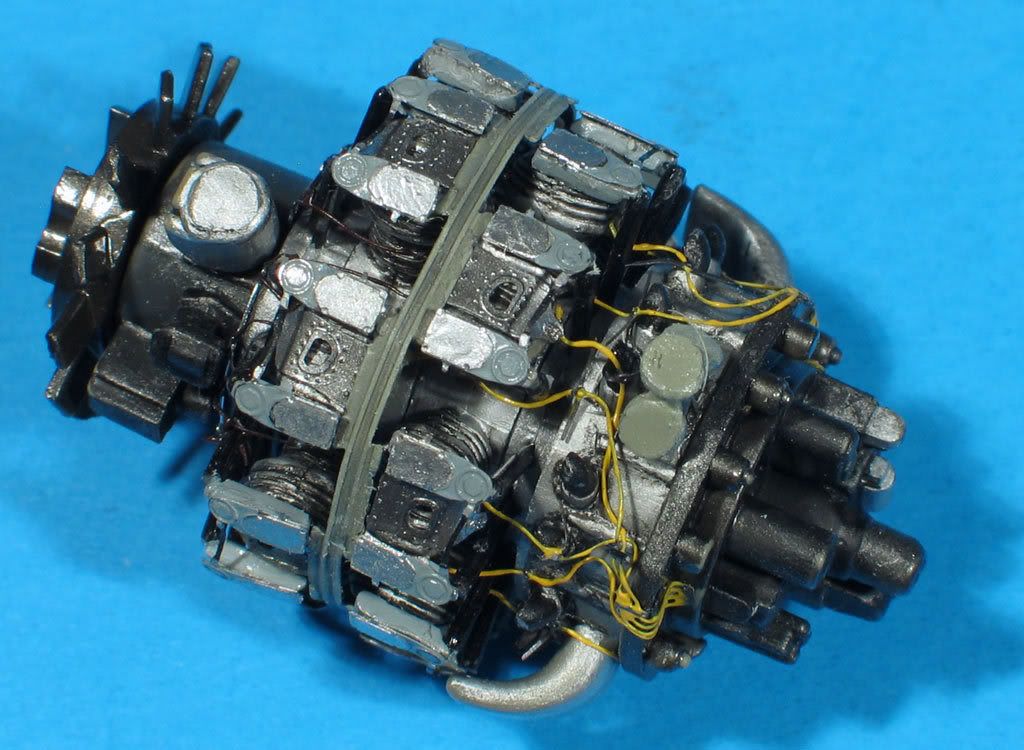

And engine
There are still a lot of items to be added to the engine. It may take a few more days to add them all. I won’t be able to add the exhausts until the engine is mounted. This will ensure proper alignment.

Hey Pix, I really like the 110.
Its on my to do list. Looks great.
May I ask how you applied the camo and are the 3 layer decals hard to work with? I have never worked 3 layer decals before.

Very nice, Pix. The 110 had me goggling at it. I can’t imagine multi-piece decals. I’ve got a zero with 2 part nat. insig. and was driven to pick a scheme that didn’t need the white rims. It is easier to do my 1/48 Zero with the white rims and the 1/32 with the one piece ones. You’ll have to do a how-to thread on multi-piece decals.

Mike and cassibill - In order to apply multiple-layer decals, the one underneath has to be completely dry and conformed to the surface without silvering. With these markings, the first layer is a series of white vertical bars. The next layer, which is a small sliver of a decal, contained the outside circles of the roundels. I applied them to a tiny bit of Micro Set, then touched a Q-Tip to the liquid to remove the majority of it. It’s difficult to position the decal if it’s floating, and dangerous to try moving it on a dry surface. I moved it into position with a #000 brush, and kept removing liquid as I aligned it. When I was satisfied with the position, I lightly rolled the Q-Tip over the decal. After Micro Sol and drying, I applied the final layer (dots in the centers of the roundels) in the same manner. It’s not very difficult, it just takes patience and determination. The results are worth it (IMHO), since the registration is much closer to true than the optional one-piece decals.
