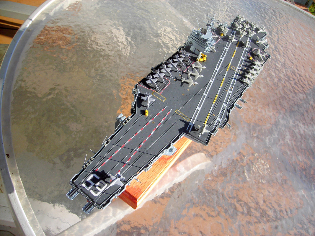

Just finished the Academy 1/600 CVN 65 Enterprise

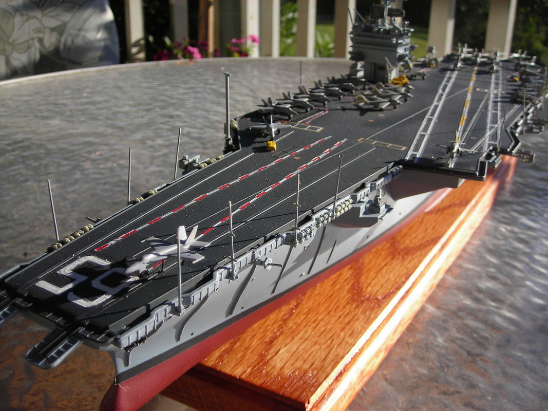

I jus finished the Academy 1/600 Enterprise yesterday. I will post more pictures in a few days. Here are my nearly complete Enterprise now. This is a beautiful kit & a real joy to build. There was nearly no flash & everything fit perfect. The planes look good too. It is well worth the price.

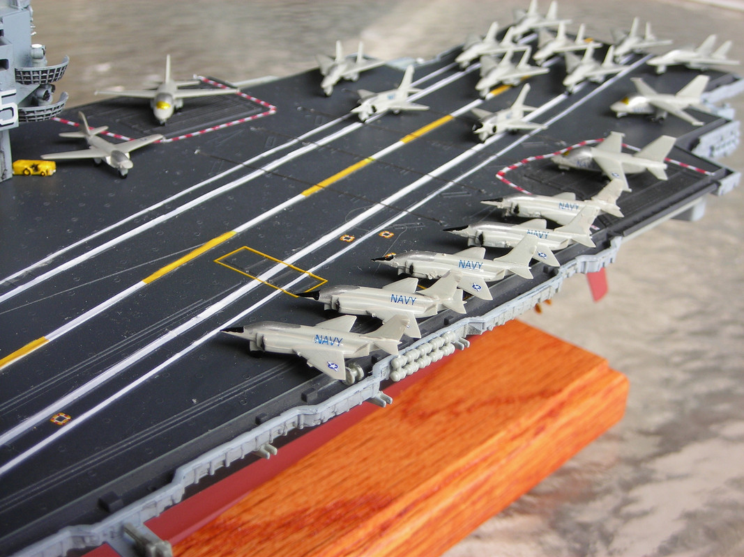

I couldn’t get any more room for writing. I put a lot more final details & then a final cote of Dullcote & Future wax on the canopies & some touch up. This was the most fun kit to build because it was such a clean ly made kit.I added all the deck stripes with 1/6" & 1/32" decals. Get Microscale decal stripes as the ones I got were so transparent that I had to put 2 or 3 layers on. I cut some red decals strpes to do the front stripes.

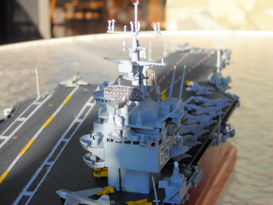

I mixed Tamiya acrylic for all my colors. I found that White & med. Blue & a little red make a close Haze gray. I used Hull red & plain red for the hull . The Deck is Tamiya German gray. I do love Tamiya paint & would rather mix my own than use other kinds that peel when you mask them.
She looks sharp. That’s an old Arii kit from the 90’s. Again you’ve made a silk ship from a lesser model (older anyways).
Anyone who can put decals on straight on a 1/600 F-4 has my eye!
Constructive ( I hope) comment. A longer base would make her look bigger.
Nice that you can get the colors you want from Tamiya. I like their Gunship Gray for decks, but it looks more faded than yours.

Bill, you are right & I had a finished 16’ & 24" base sitting there. Thank you all for all the nice things you say. That makes it fun & thats what I’m after.

Here are some of the finished pictures of the Big E. I added cross pieces on the deck stripe, a few more planes & the things that stic up or out on the deck edge. What are they ? I was Air Force, not Navy.
