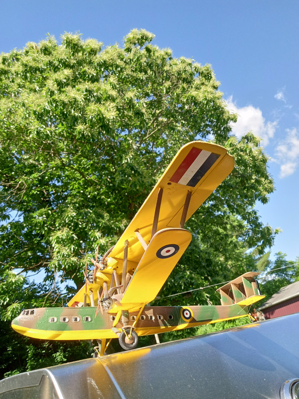

True they can be tricky but I like building them!
