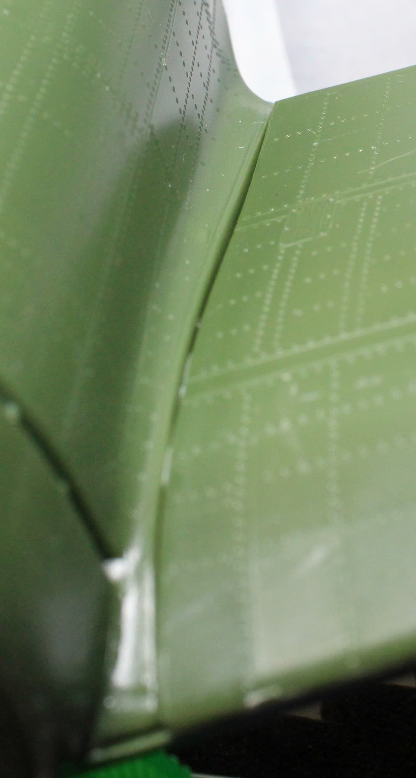

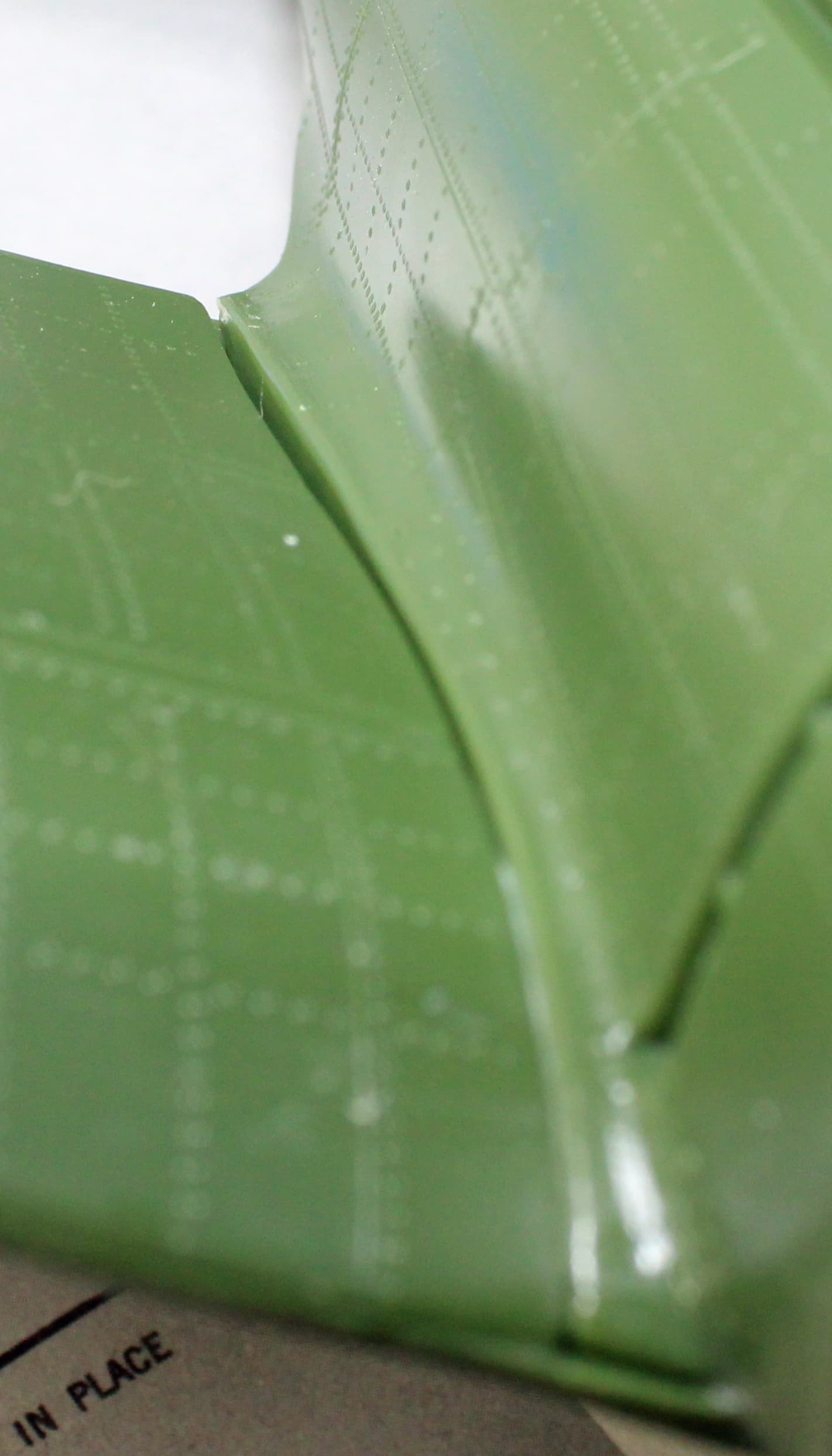

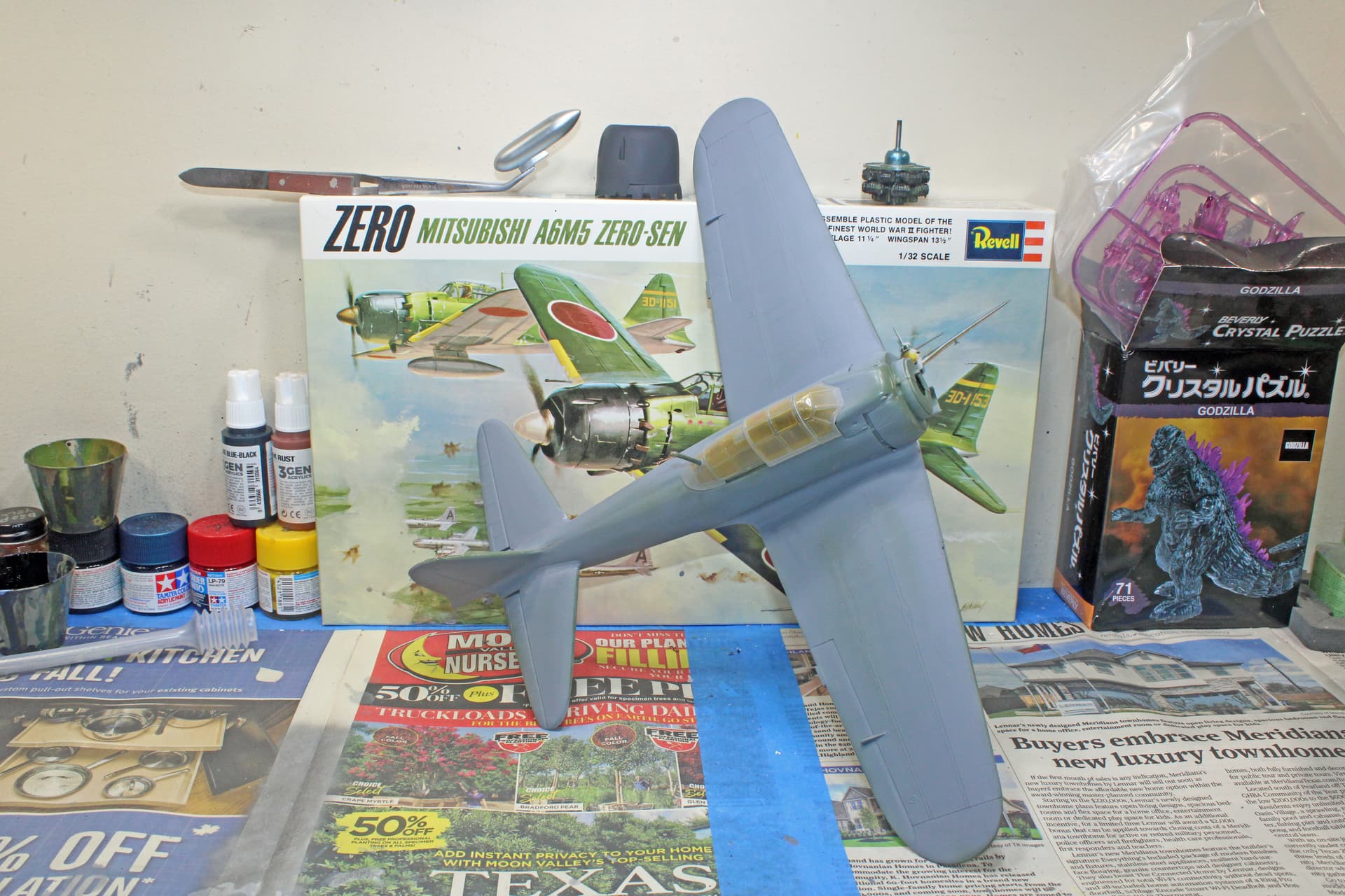

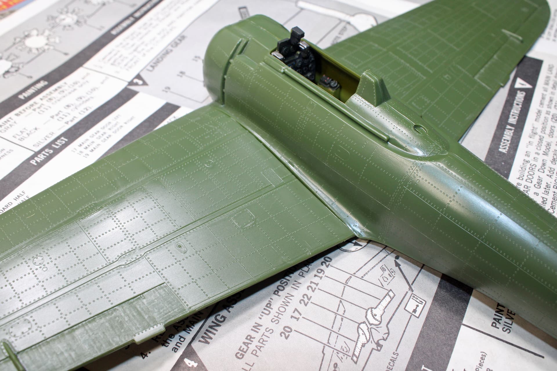

This is where I am at with the Revell Zero before I head out to the bench in a little bit:
Lots of big gaps to fill. I mixed some sprue goo last night, which seems to be my new preferred filler (even though I just bought both a tube of Tamiya putty and some red glazing Bondo putty). My plan today is to get these gaps filled and remove seams, mask the clear parts, and put down a coat of primer. Bad weather for the day + my wife working much of this day = no Valentine’s Day plans (but she had last night off, so we did all of that then).

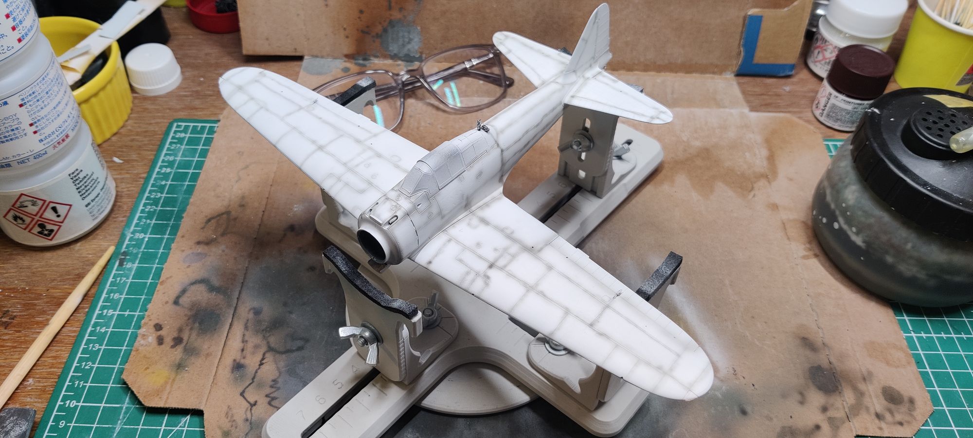

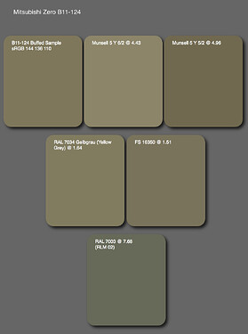

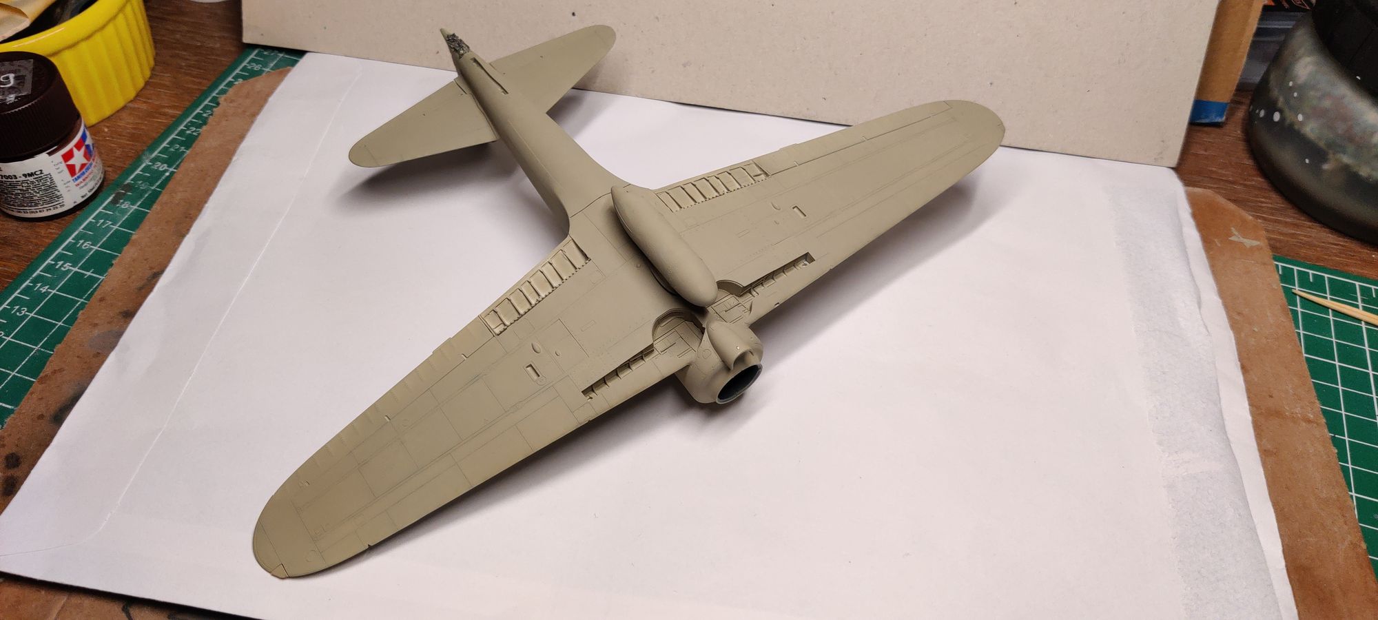

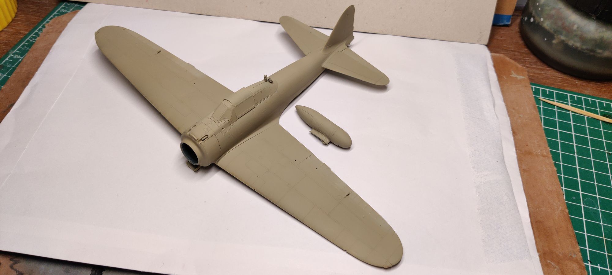

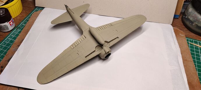

A bit of progress here on my end, I went down with a bit of preshading, marbling, and topcoat.
My marbling ended up a bit too opaque but the real wild horse of the show was the final paint color : it’s definitely a hard debate :smiley: I think we are used, in general depiction, to a very light, almost creme color - sometimes it’s even white or light grey -
But it seems it wasn’t so at all.
Even the “grey green” scheme is apparently not entirely right !
I perused Nick Millman’s Aviation of Japan website ( a reference, as I’m sure people here already knew ) and a close match would be RAL 7034 Gelbgrau, a kind of yellow grey.
Courtesy of Aviation of Japan
This particular paint was even created with Nick’s help.
Anyway it’s all well and good but now I’m here with my oh so green XF76 and I have to mix.
I basically went two ways : 10:1 XF-76 Grey/Green IJN and XF-49 Khaki, which wasn’t bad but too dark, so I quickly rotated to 20:10:2 XF-55 Deck Tan , XF-76 Grey/Green IJN, XF-59 Desert Yellow.
Still, it’s a very metameric mix that switches hue incredibly easily under different lighting, so I’ll just hope it looks good enough in the end because I have virtually no way to test final display conditions.

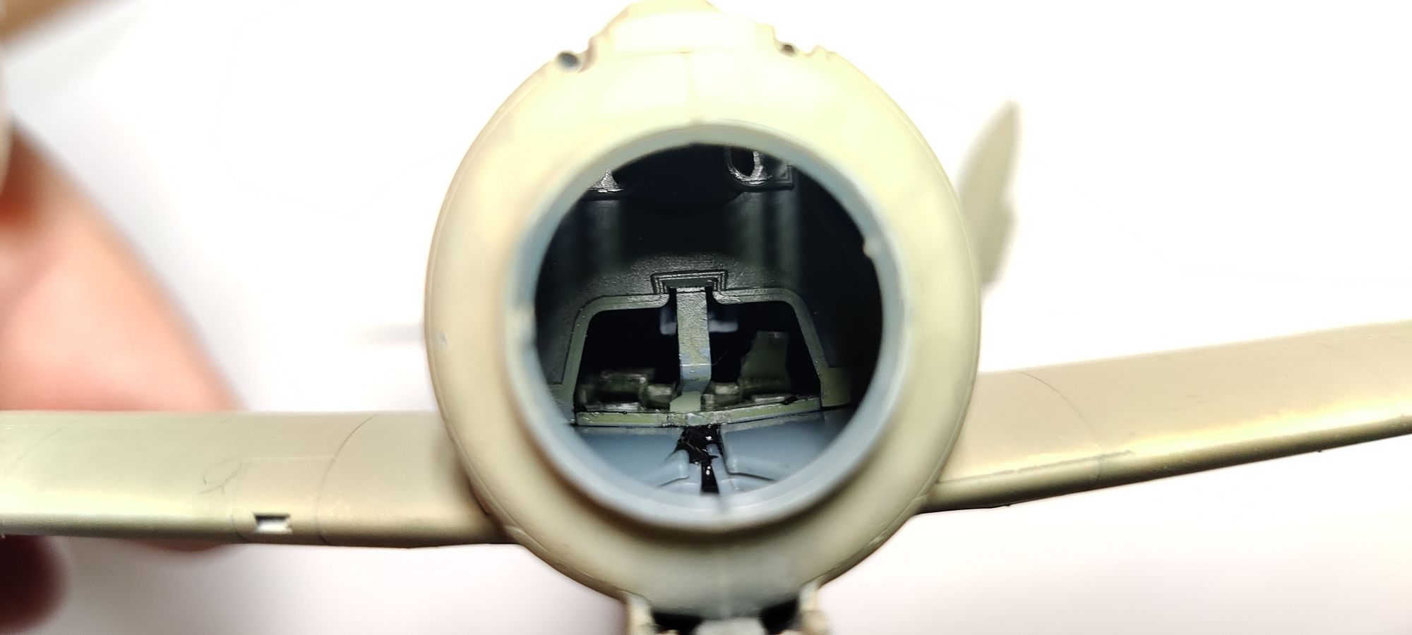

A cautionnary tale : the way eduard cockpit tub is build, it leaves gaping holes behind/under the instruments panel. With the nose still open ( I will attach the engine and engine cowl later ) I tought I’d “shishkebab” the model for easier handling during paint.
I didn’t fix the stick well enough and it went through the gaps and apparently flattened one of the pedals. I can only hope there isn’t any other damage inside. Fortunately, the canopy is not fixed, and with any luck I will be able to straigthen that pedal up in the end, but given that it IS a PE part, it may just break. Fingers crossed … I’m not there yet.
( I’m also very surprised they would make us paint stuff impossible to see behind or under the tub, but ignore the inside of the node entirely. Maybe I miss a step. Dunno. )

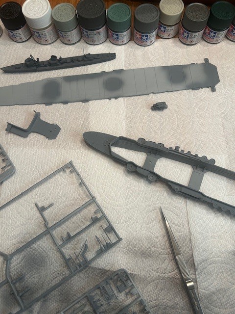

Got started on the Zuikaku - Chunks of the hull in place, primer on, now starting on paint.
Akatsuki also in progress, providing an escort.
Oh, and shoutout to @CrashTestDummy - I purchased my new favorite tweezers after seeing his recommendation from some time ago. Appreciate the weight and especially the length - they are longer than what I had been using. The locking feature comes in handy, too.

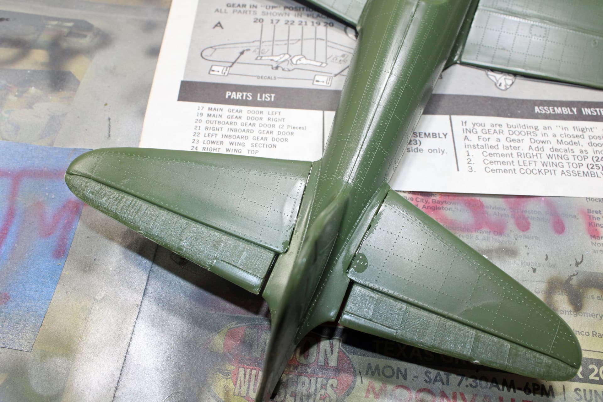

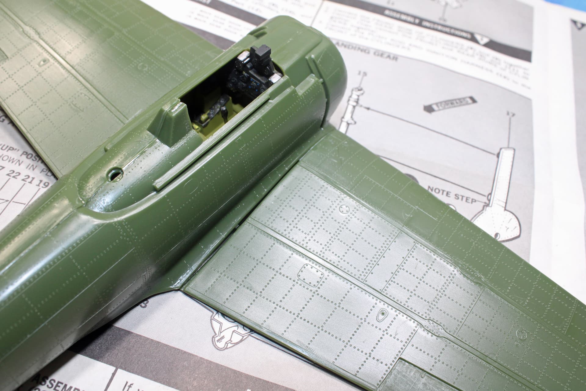

The Revell Zero is progressing, now coated with grey primer for hopefully some dark black green and ash grey tomorrow.

@Aggieman you are making fast work of that old Revell kit. Very impressive I must say!
@DrKoin , Your zero is looking great. I see that you have fallen into the Pit of Pigment Perfectionism :wink: Yea, I made that up. I have done the same in the past and have to admit that researching these J-Aircraft schemes can be quite interesting.
