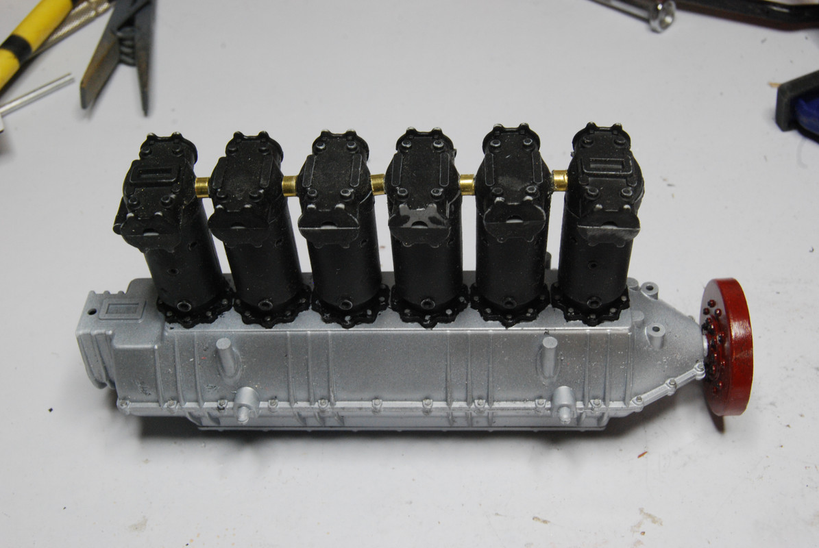

I have started working on the engine. As someone said, the engine is a model kit in itself- I figure if I work on chassis, body painting, and the engine, sharing time, I will have the engine ready when needed.

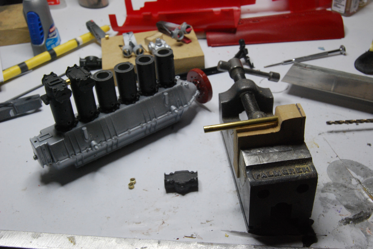

The cylinder heads have a tube running between them. The kit has little nubs on each head, and some vinyl tubing. You are supposed to cut the black vinyl tubing to fit between the nubs, and leave it black. But photos of the real engine shows these tubes were brass. So I cut lengths of 5/32 brass tubing to replace the vinyl tubing. Each length is less than 1/8 inch- I had to make a jig to control length- made this tube cutting jig from MDF.
Even with the jig I had to touch up several with a file to get them to fit. But it looks good now.

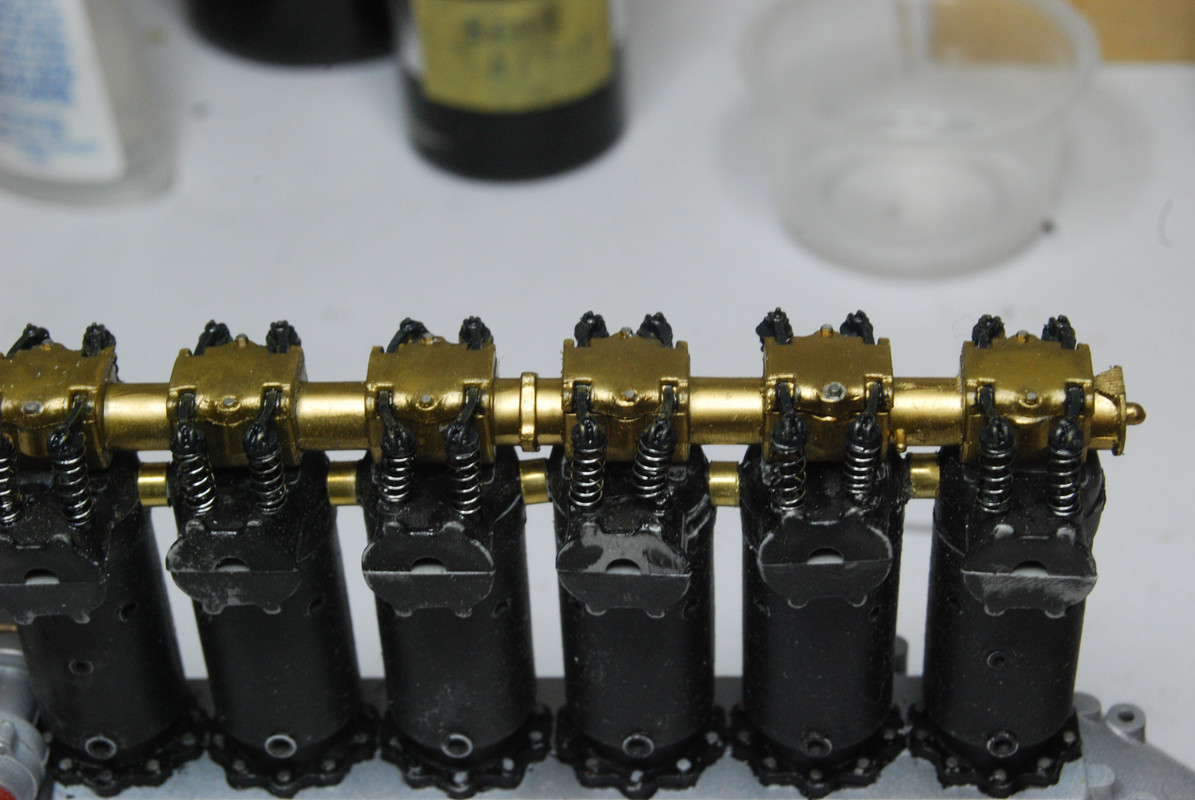

Also continuing on with engine. Have cam housing ready to mount, but need to put in valve stems. The valve stem, spring, and rocker arms are open. They supply the spring, but it is a little thin in cross section, so valve stem should be visible, but they do not supply stems. No problem, I thought- little pieces of steel wire will surface. Problem is drilling the small holes. We’ve discussed the problem of poor quality 60-80 drill bit sets. I’m tearing my hair needing to drill 24 holes (4 valves per cylinder). The soft plastic does not drill easily.

I did it! Got 24 tiny holes drilled down into the head to hold the valve stems (pieces of steel wire). Gave up trying to do it with pin vise. The quality of today’s small drills are so crappy I had to resort to my mini drill press.

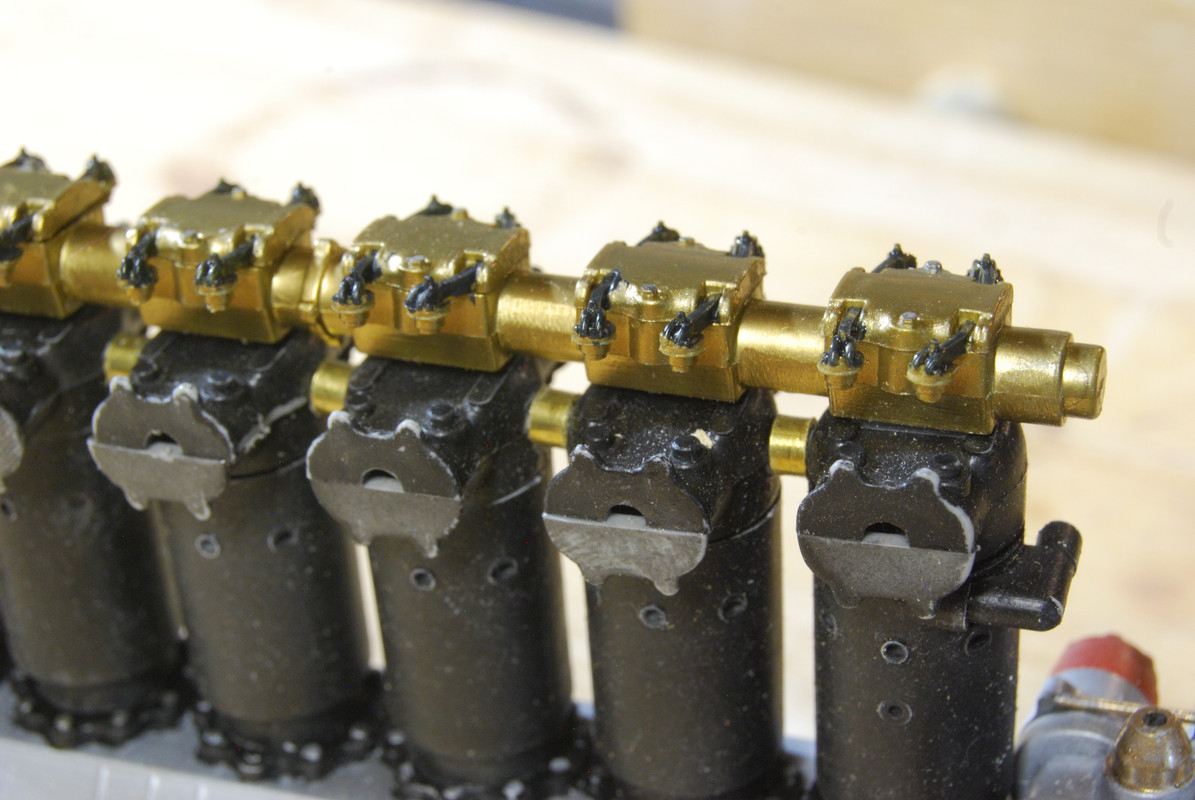

Then I had to cut short lengths of the wire and glue them into the holes- easy job. Next I had to paint valve springs. I feared this job- the springs were stainless, but I stuck them down on a piece of double side tape and airbrushed them with graphite metallic. They came out okay. Next job was gluing on the rocker assemblies and cam housing. I would have to hold all twenty four springs in the right position and fit them over the valve stems while gluing cam housing in place. I first glued springs to rocker arm tappets, brought it down over the stems. Took two tries, each time only one errant spring. Got every thing lined up okay second time. Fortunately, the springs were strong enough it held the cam assembly about a sixteenth of an inch up above mounting surfaces. That was enough to get some CA glue on those surfaces. Valve and cam stuff complete!
