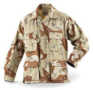

Is this the one that was referred to as “chocolate chip”? This is the uniform I remember the most most from watch the news. The reports always started with Gen. Schwarzkopf who seemed to always be in this uniform. Anyway… that’s what my guys will be in mostly.
So here’s my question. What color is the webbing and gear the guys would be carrying?
Yes, that is the DBDU (Desert Battle Dress Uniform), a.k.a “Chocolate Chips” uniform. The gear/webbing was standard LC-1 “ALICE” Load Carrying Equipment from about 1973 that was worn until the early 2000s. It was mainly in OD green, but some pieces were in Woodland Camo as well.

LC-1 gear on a Soldiers wearing DBDUs. Notes: All patches, name tapes, etc. are also green. Boots were either OD Jungle boots or black leather boots.
