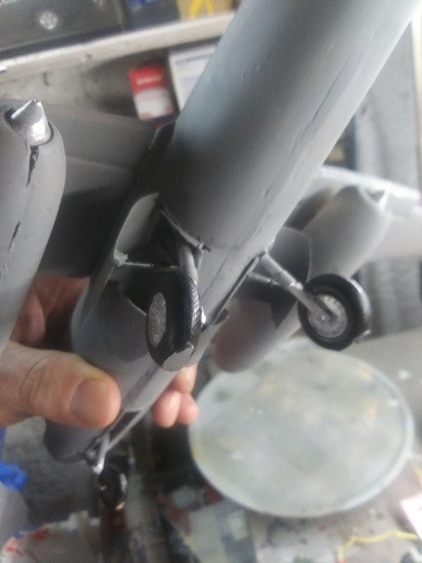

Ok I am waiting some interior decals to dress up the cockpit area.So I will start building a ventral gun pod!
Made the gear doors from brass sheet pounded over a socket.Actuators were from the parts stash.
A 1/25 drag chute will work for the rato rocket.
Man I love the drag chute idea!
