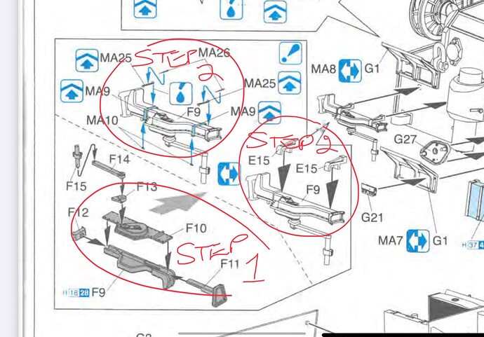

Picking a Dragon armour kit for your first one is a lot to tackle. Dragon tends to have many parts per step, multiple options for certain parts, required and optional photoetch and other metal pieces.
First thing is to get very familiar with the various symbols Dragon uses. Eg, glue, don’t glue, bend, optional, replace etc. Then when building, make your sub assemblies in the steps first - the ones in the smaller boxes. Once these are together they can be added to the main kit.
In the following picture the jack is built up from plastic parts in step 1, then there are two different step 2s, depending on whether you use the photoetch or plastic parts for the details. The one thing Dragon is “good” at is flipping sub assemblies around to different viewpoints between steps making the parts almost unrecognizable as the piece you were just building. In this picture the jack is flipped over between steps one and two.

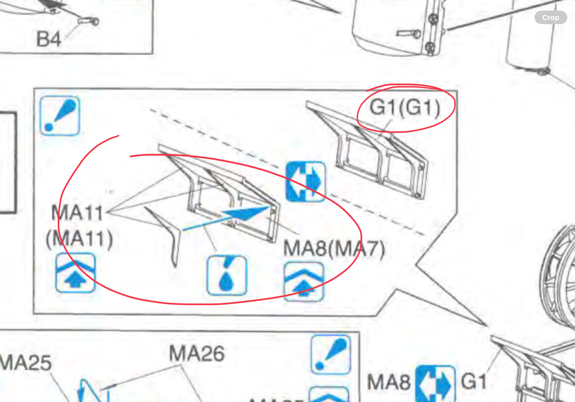

This picture shows the two different options for the rear fenders. The one with MA# is the photoetch fender, the one with the G# is the plastic. At this stage I would suggest using the plastic parts as much as possible and avoid the photoetch on this build if you can. You can keep the photoetch and use it on a future model.

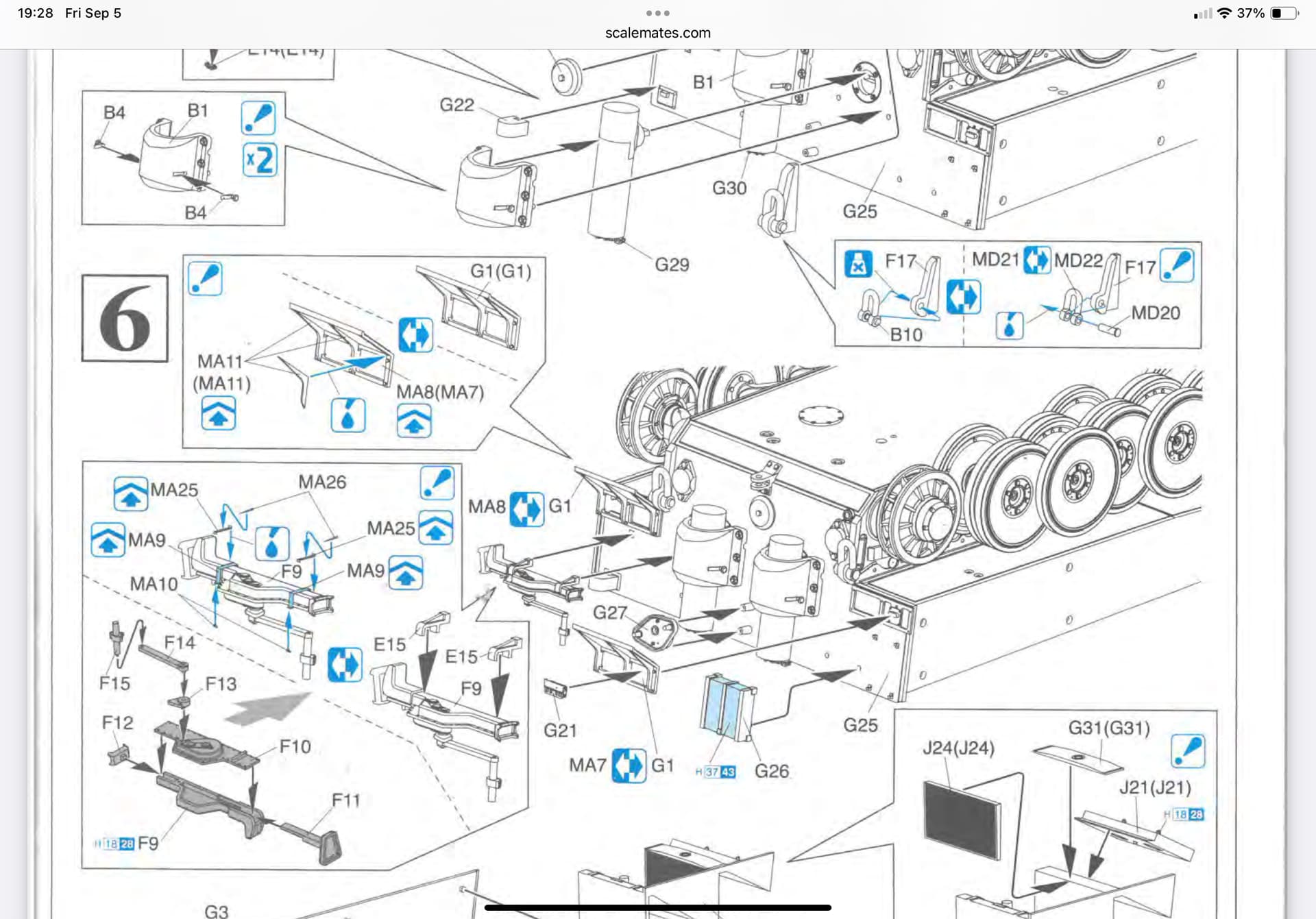

Test fitting is absolutely crucial to building Dragon kits, there have been instances of mis-numbered parts in the instructions, parts shown already attached, or even parts not shown that have already been installed.
In cases where multiple parts overlap each other, usually start from the hull or body and trace the arrow out to the first part to be attached, the follow the arrow out to the next part, etc.
