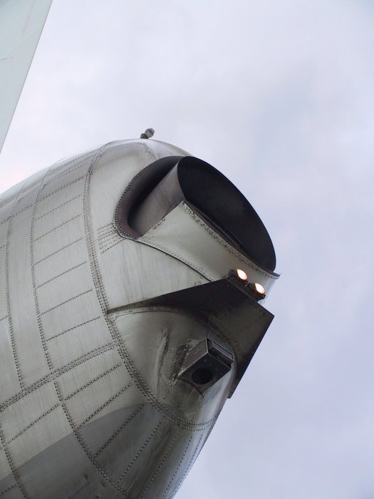

Here’s a pic of the APU exhaust in a 747: http://www.billzilla.org/747apuext.jpg

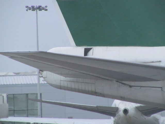

and a pic of the APU inlet doors: http://www.billzilla.org/747tail.jpg

The APU (Aux power unit) on a 747 is normally operating while the aircraft is being serviced between flights - that’s what you hear when you’re onboard without the engines operating. It powers the aircraft systems, aircon, and avionics. It’s located in the very rear of the fuselage, and the exhaust sits beneath the rudder.
