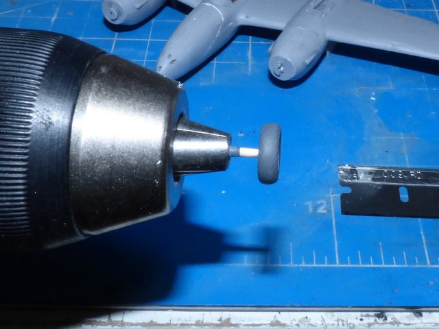

Ahoy friends. I find that some road wheels and especially airplane wheels/tires don’t have anything to chuck onto because of their size, especially 1/72 airplane wheels. I use the same technique as above, except that I install the wheel on the end of a round wooden toothpick. You can cut the tip of the toothpick down progressively until you get a real tight pressure fit. Then you chuck the toothpick holding the part into your drill. Generally, using very slight pressure, you can sand off the mold line without jarring the part loose from the toothpick. You need to get the wheel on the toothpick relatively straight so as it won’t wobble. Also, cutting off the toothpick short so that the wheel is close to the face of the chuck helps to keep the wheel from wobbling. My example is a 1/72 P-38 main wheel that I’ve subesquently painted.
