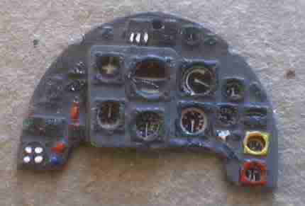

that was my problem long time ago . …than i realized that they are just putting eduard and similar sets inside pits … I always tought that thoose instruments are home made but nope … look at this …just eduard :slight_smile:

It’s not all Eduard, different panels need different approaches. For some I use dry brush techniques followed with finer detail work done using a very fine (2 or 3 hair) brush to add red or yellow rims on dials and to color buttons. For others I utilize decals like Reheat where individual faces are cut out with a punch and placed into the dials then sealed with a drop of Future to give it a glass look while others really are from Eduard [:D] or a combination of several techniques.
This one is a combination of decal faces, dry brushing, picking out details with a fine brush and sludge washing. I spent about a week on this panel.
This one uses some Eduard PE plus painting techniques and took a couple days.
Many kits will have seperate decals for the intrument panel, I’ve used lots of methods before including cutting out the individual dials from the decals and dropping then into the bezels on the kit dashboard, fiddley but rewarding.
This one for the rear cockpit of a 1/32 scale F-4 was done the hard way. It’s the kit panel, no PE or decals. I sprayed the whole thing gray for the background, then on each instrument I put a drop of thin white enamel. When that had cured fully I put a drop of thin black acrylic on each instrument. When that had cured I used a #11 X-Acto knife blade to scrape each instrument. The white enamel, being tougher than the black acrylic, stayed put while the black scraped off easily. A drop of Future in each instrument to simulate the glass and it was done. I’ve also found that a stiff knife blade gives me better control than a flexible brush does.
