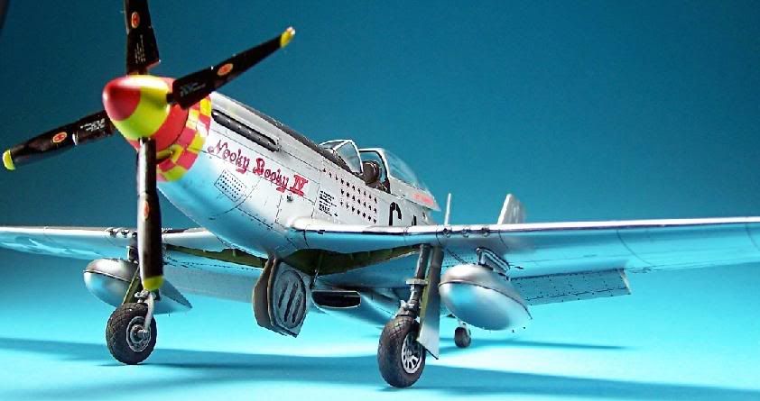

hmmmmm…funny, i’ve never had a minutes trouble out of tamiya’s decals. i use microsol, dob some around where the decals sits, i dip my decals in tap water for about 5 seconds, then i leave it on the side of the dish, never let them “soak” in water too long as this will make them lose they’re adhesive properties, and they will be more apt to tear. when the decals has been on for a few, i dob some microset on it, and let it sit for another while, then, i keep adding microset until she’s snugged down nicely into panel lines and raised areas. later.
BTW, all of these are tamiya kits, using OOB decals.
