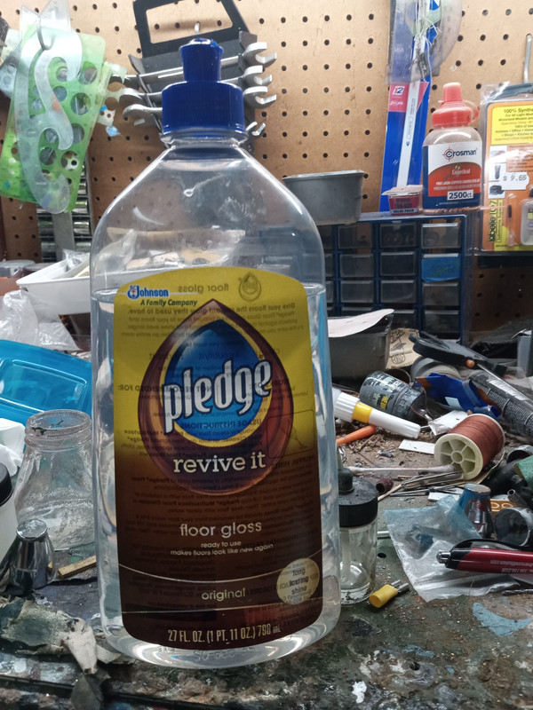

If you have some Future or its modern-day equivalent, that works great as an adhesive for these kinds of jobs. Any errors you make with placement of the Future will be totally invisible. CA and even white glue aren’t optically transparent, and CA may even cause fogging on the film.
You don’t want to fog the plastic so if you use CA only apply it in very minute quantities and only where absolutely necessary .To further protect the clear plastic ,dunk it in Pledge Revive it (Future)and allow it to dry prior to assembly .

The Pledge worked really well for an adhesive, attaching the film insturment panel to the plastic. Now I need to paint the P.E. instrument panel and attach it to the film.
