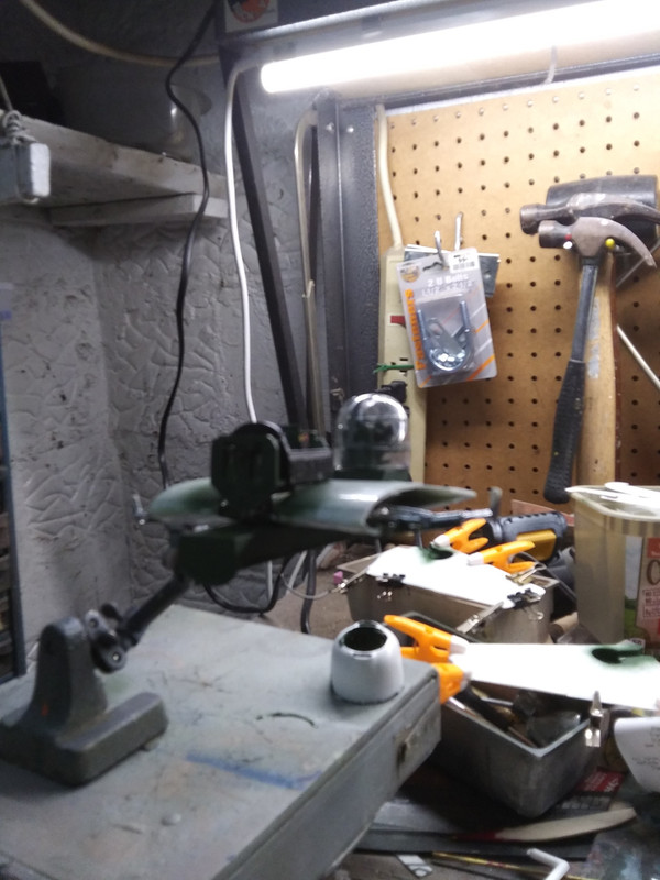

Cool I think I have an Plane with the build a motor (Stiletto I believe).Anyhow I taped off the turret abd sprayed the interior green.

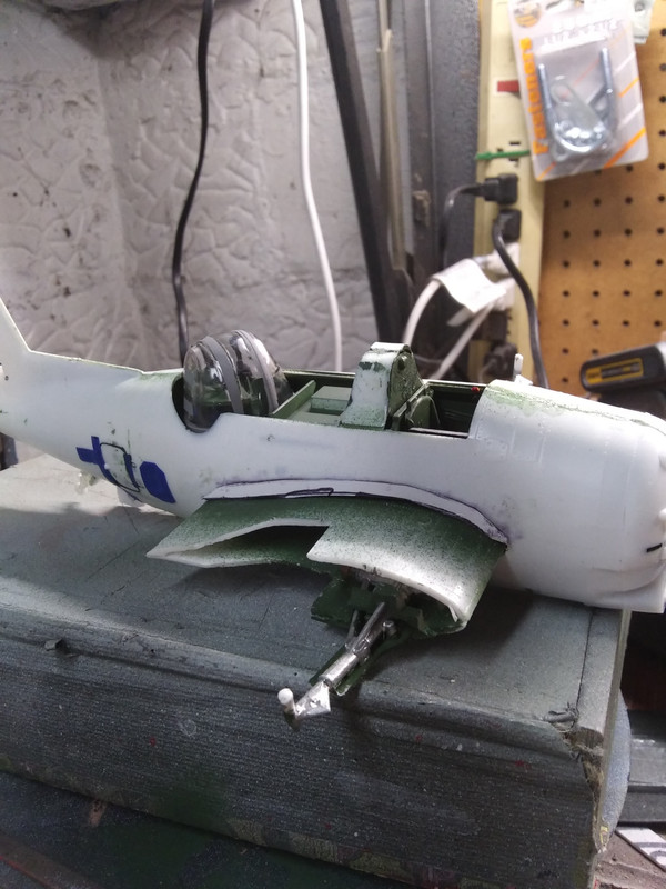

Mocked up to test the fit …might be ok but I have to protect the turret when I do body work and painting.

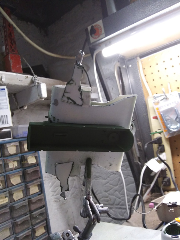

I reinforced the landing gear with a copper tube .They do retract which they have to to allow the fuselage halves to be joined.
I had to bevel the edges of the landing gear doors with a file but they fit surprisingly well.

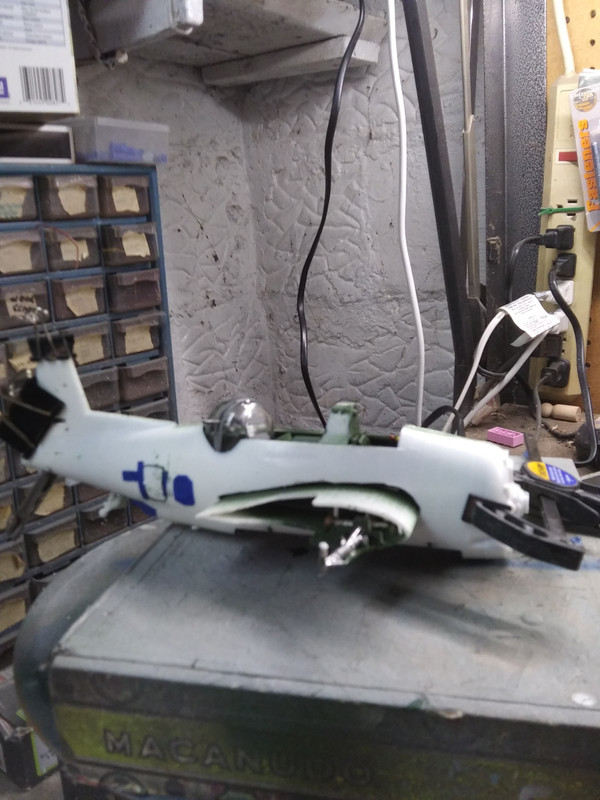

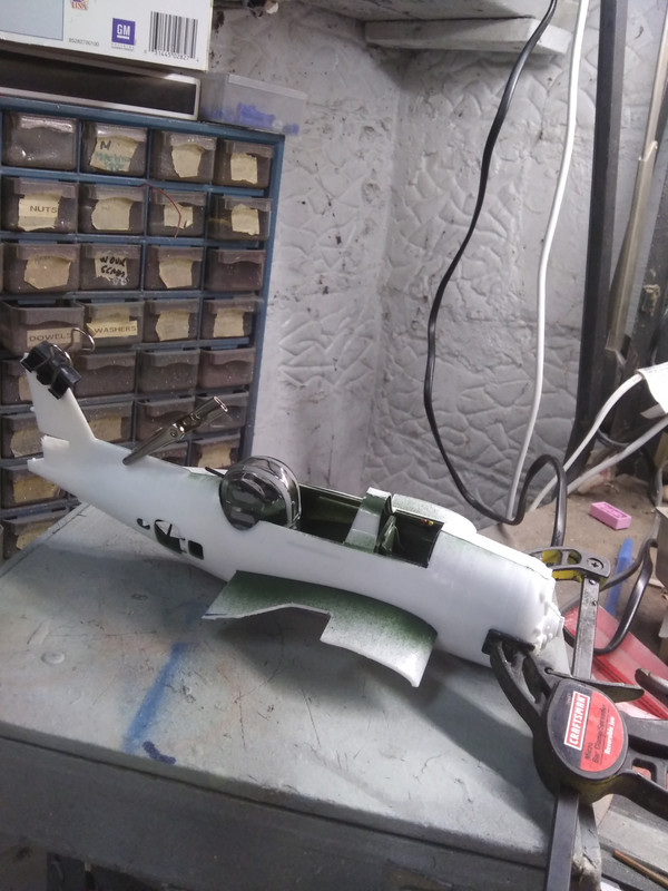

The installation of the lower wing would not allow the fuselage halves to pass through .I had to keep trimming until they did but I removed too much plastic resulting in a large gap at the wing roots.Stryrene fillets and putty will be necessary.
