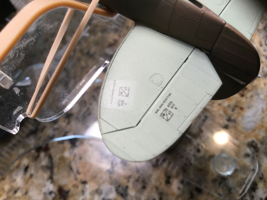

First time with these stencils. On one I couldn’t get rid of that square haze. Procedure- take sheet of stencil, dip in water for a few seconds, apply micro set to surface, take clear film from stencil, apply, mash down with qtip, wait 6-7 hours, take off carrier film. Wipe off any glue residue.
wonder why that one left that square? Too much microset?
I am a bit confused. That looks like decal frosting or silvering. Is that a decal or a dry transfer? When you say stencil, is that the process or the type of marking?
Stencil meaning the marking type. I don’t know what a dry transfer is. These aren’t decals. They are only like a decal in that water is used but the application is different. These are supposed to be superior to decals. I applied more and getting better results. Sorry they are hard to explain. You can see tutorials HGW stencils.
