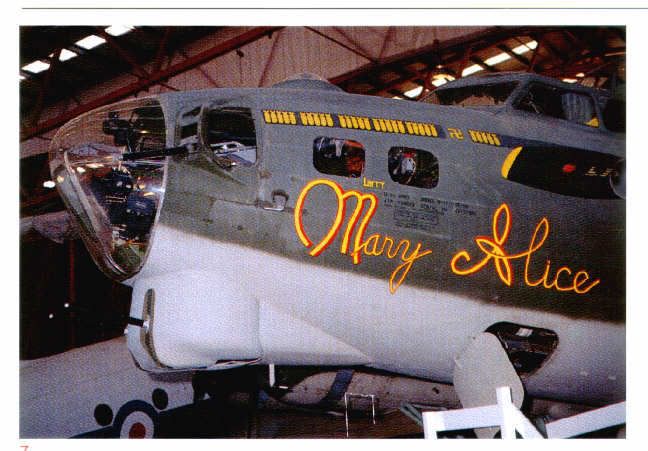

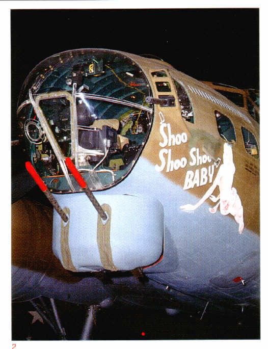

Here are two interesting pictures. Both are technically the olivedrab/gray schemes, but the olive drab and gray seem to be very different colors. Unless you know the exact color used on the particular aircraft, i.e. “Memphis Bell”, then I think you can get away with a wide range of drab greens and grays. Same thing with the interior color, I believe.
if you are doing a o.d./neutral gray a/c with some missions under its belt use model master ana613 o.d. or faded o.d. both are widely available and give that purpulish hue that so often accompanies faded o.d. hope this helps! dave
