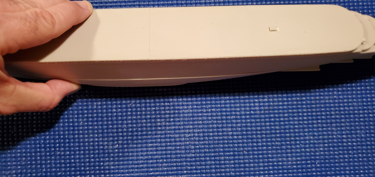

The kit hull is 1/700 scale and two part. There is a joint at the waterline that gives you the option of building either a waterline or full hull version. Both halves are keyed to supposedly give you a better fit. I want to build it full hull.
The issue I have is the lower half of the hull is wider than the top along most of the point they join together. This is especially true amidship. There is no movement in either, they are solid as a rock. How would I go about making a seamless joining here?

Chris, how much wider per side is the lower hull wider then the upper hull as does not look that much? is that an aircraft carrier, British or Japanese as should have bulges on either side of hull which will hide that seam problem?
Are you sure that the wider part is not representative of an armor belt?
Looks like a liner to me.
Thanks for all the replies. It is an ocean liner model. I’ve been messing around with it a little and trying some things before ripping it apart.
I have a soft jaw vise so I stuck the lower half in there a bunch of times, gave it a squeeze, and hit it with a heat gun. Before it could cool off I put some cold compressed air on it from my compressor. I must have repeated this about ten times at different points on the hull. It seems to have improved it quite a bit but I don’t know if it will hold this shape permanently or revert back to its original condition. If it stays like this I could probably accept it with a little more work.

It should hold it’s shape.
Bill
Hey, Chris, I’m sorry you ran into that problem. Looks like a great model, though. I agree with GMorrison. The resin should hold its new shape after you heat it and then cool it. In my opinion that was the best solution available. Happy modeling. Barrett
