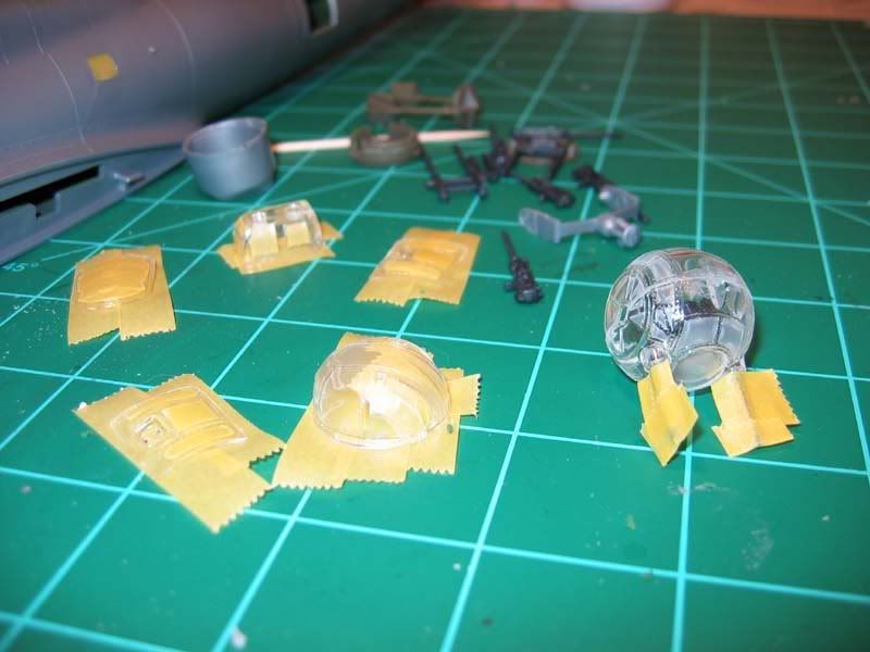

I went ahead and tried your suggestion. I had already futured them, but I just really couldn’t think of a good way to do it without having seams. I sanded them down good and tried to get a good melt using liquid cement. I hope it turns out ok. Thank goodness that ball turret is on the bottom. [:D] Heck, the way this R/M B-17G kit is, I’m guessing the ball turret is going to be the least of my worries. I just got the fuselage halves together and they are going to be fun to fill and sand I see.
Here are some pics.

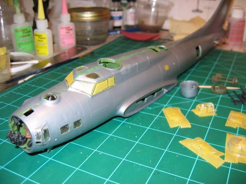

I started the masking job, as you can see, with tamiya tape. After seeing dragonfly’s He-111, I decided to give frosted scotch tape a try. It was definately easier to mask with. Especially on that ball turret. I’m anxious to see how well the masking comes off after painting. There are definately times when tamiya tape still works best, like on really curved surfaces, but I really like how easy it was to see the panel lines underneath the scotch tape and how easy it was to make clean cuts.
You can also see where I started to do some seam filling. This is by far the worst kit I’ve ever worked with for seam filling. One problem I’m having is that I’m sanding down the raised panel lines. I don’t want to scribe my own panel lines, that would be a bit more work than I want to put in this model. I guess there’s not much I can do about losing the raised detail.
