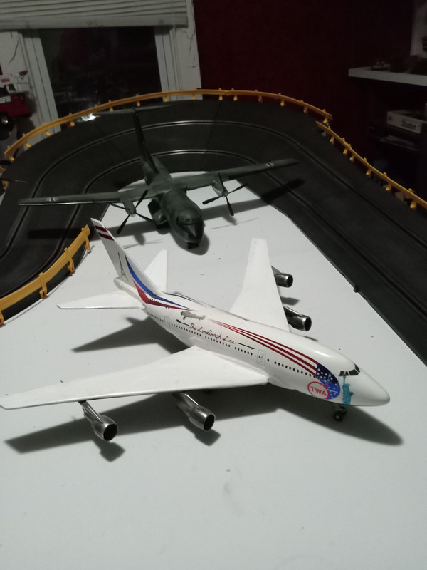

Use Tamiya flat white covers well.

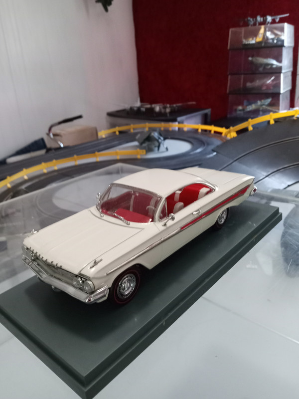

Good for cars too!
