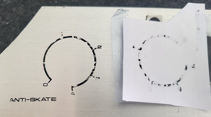

I’m having some issues with heat transfer of decals onto anodized aluminium.
I’m using ‘Titan x single step laser transfer paper for hard surfaces’
The surface is prepped with isopropyl alcohol and 5000 grit sandpaper.
I apply 2 minutes of pressure from my 180 degree C heat press
(Mefine Mini Heat Press Transfer Press, Portable HTV Small Hot Press Machine Easy Press Mini DIY for Clothes, Shoes, Hats, Heat Transfer Machine : Amazon.es: Home & Kitchen)

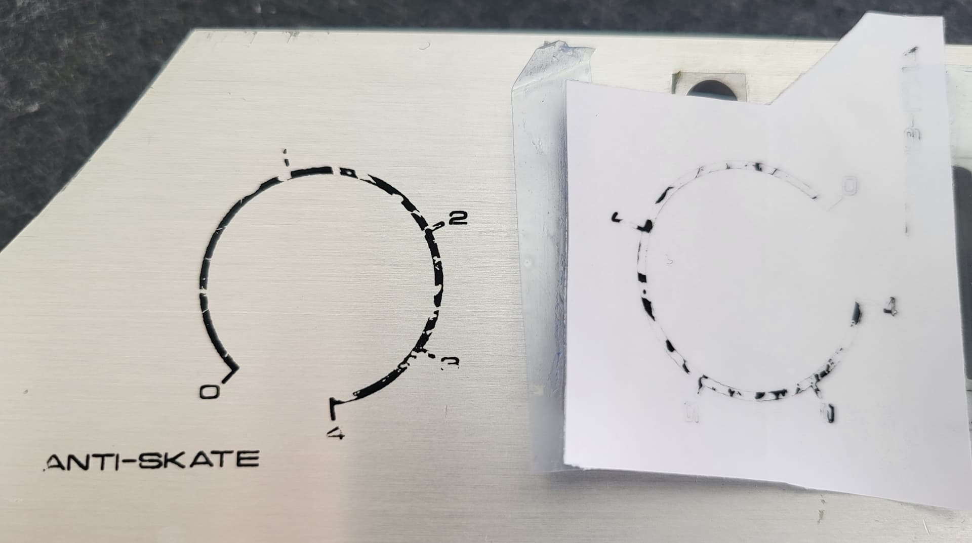

Allow it to cool with some weights holding pressure and the result is usually the below:
Any tips or tricks to get a clean transfer?
