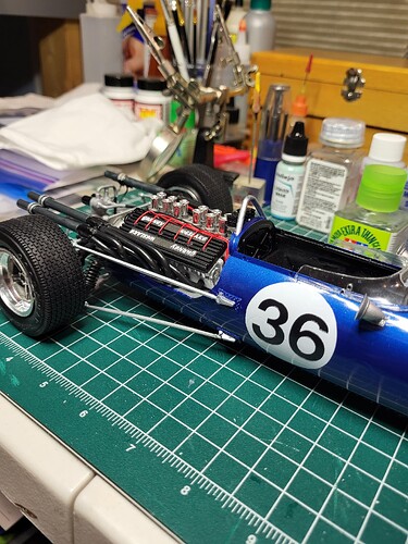

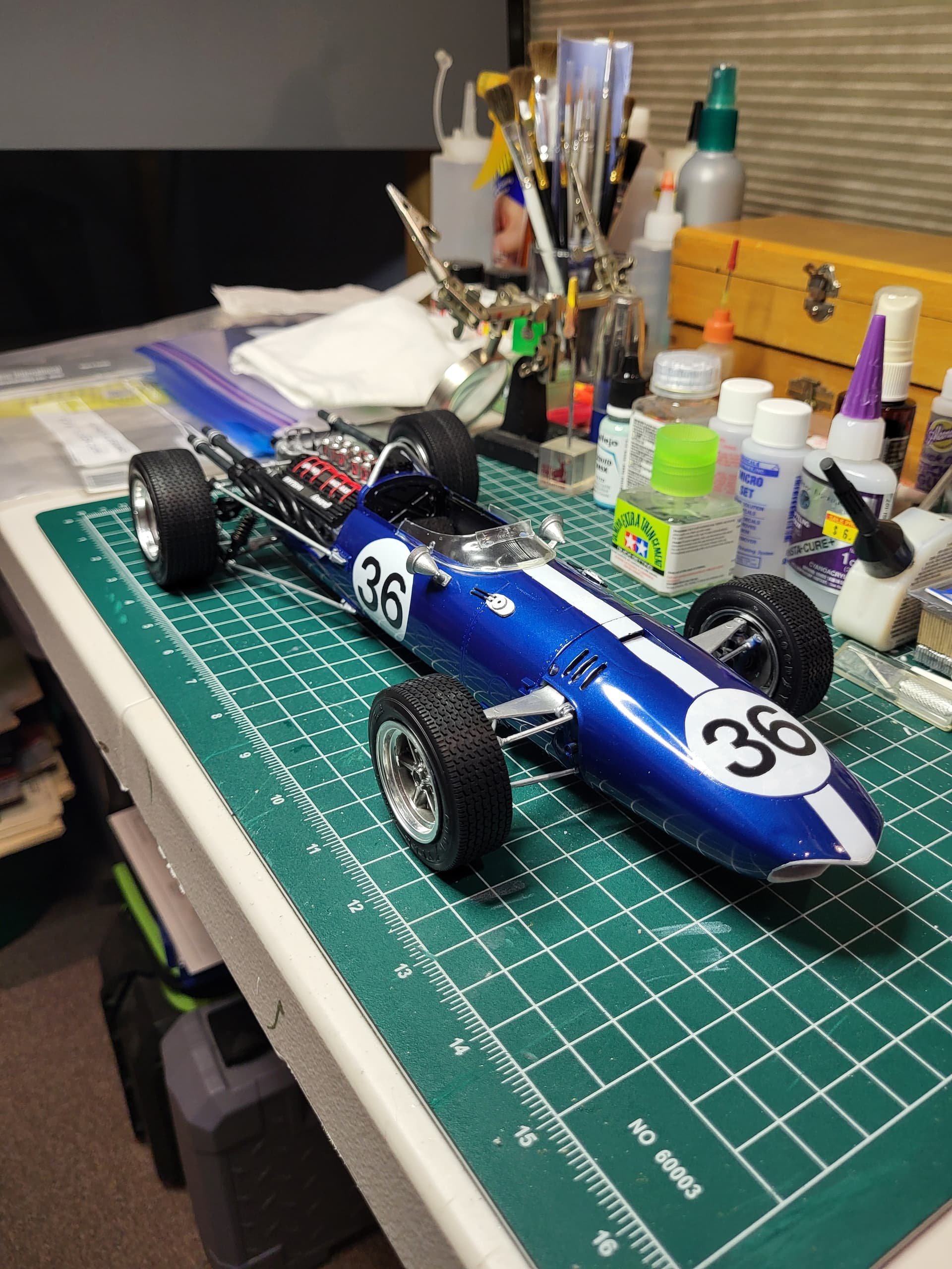

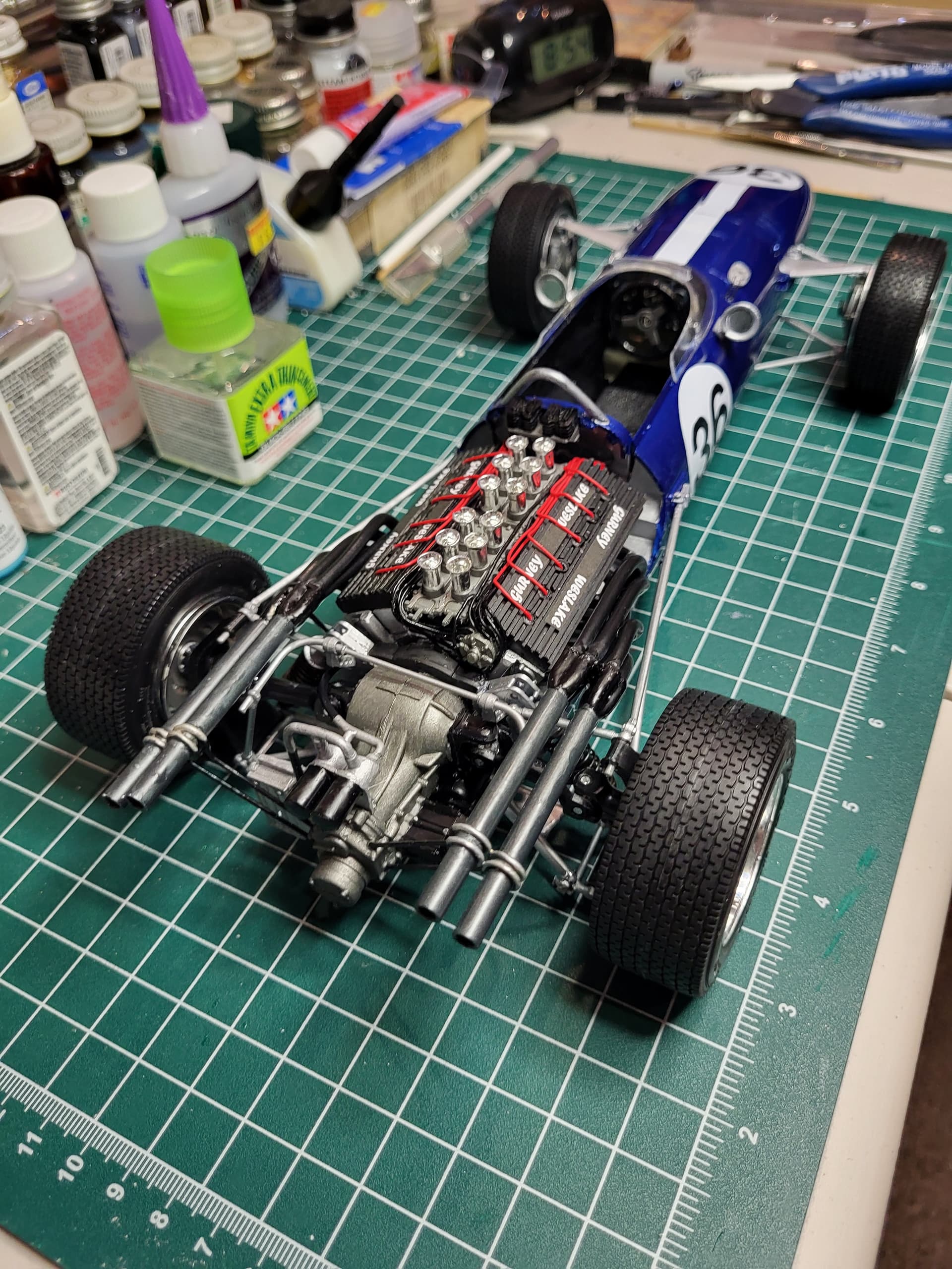

Thanks mrb865. I used Testors Glosscoat (now a Rustoleum paint, not sure if its the same as 3X). Seems to have worked well. I decided against the Tamiya gloss clear, as I have heard it is “hotter” than the Testors. Thanks again for the advise.
Glad to help, and happy to hear that you got the result you were looking for. How about some pictures? :smiley:
Great job! You wouldn’t know this was a reclamation project.
Man that looks great! Nice job!
