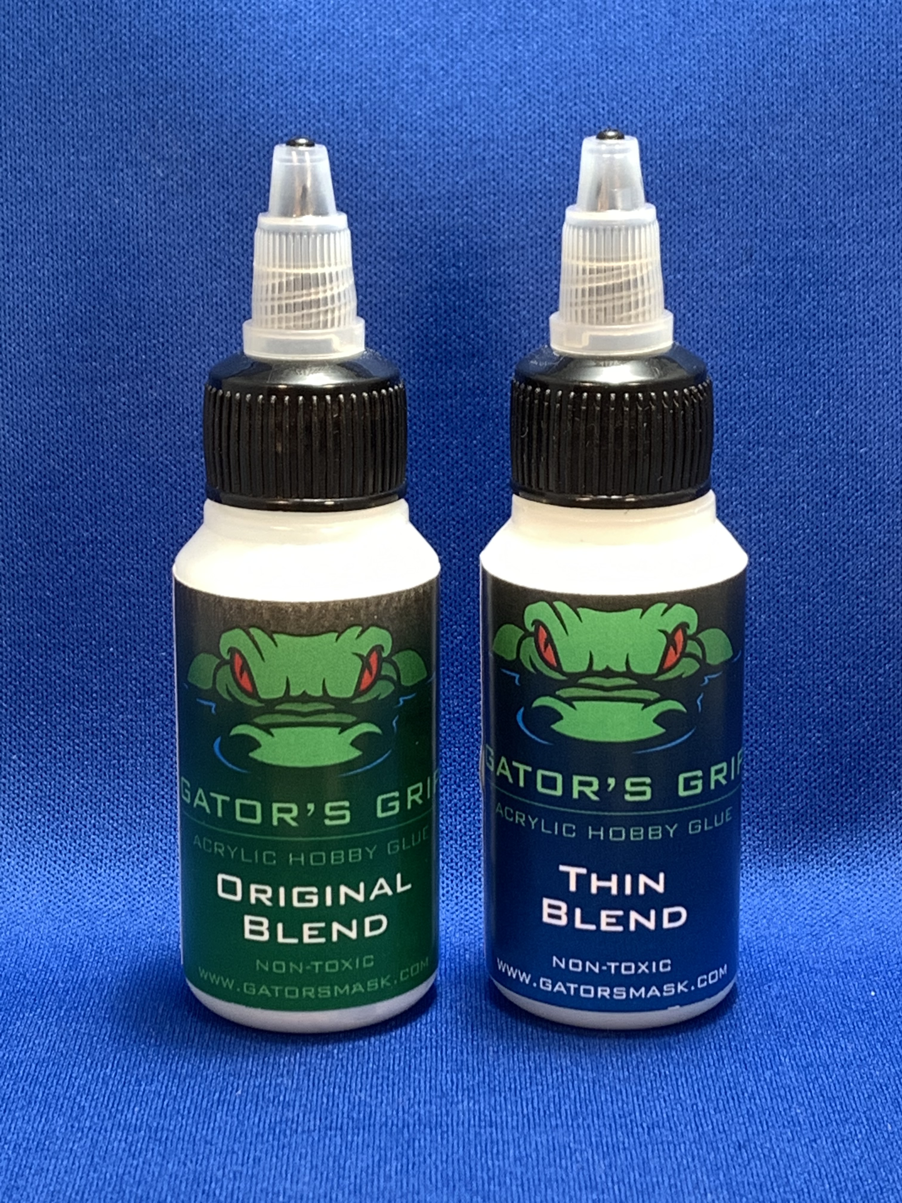

I would suggest Gators Grip, specifically designed for PE brass to styrene…
He has shut down his website but as the directions say, contact him directly…
Beats the heck outta any brand or type of CA…
